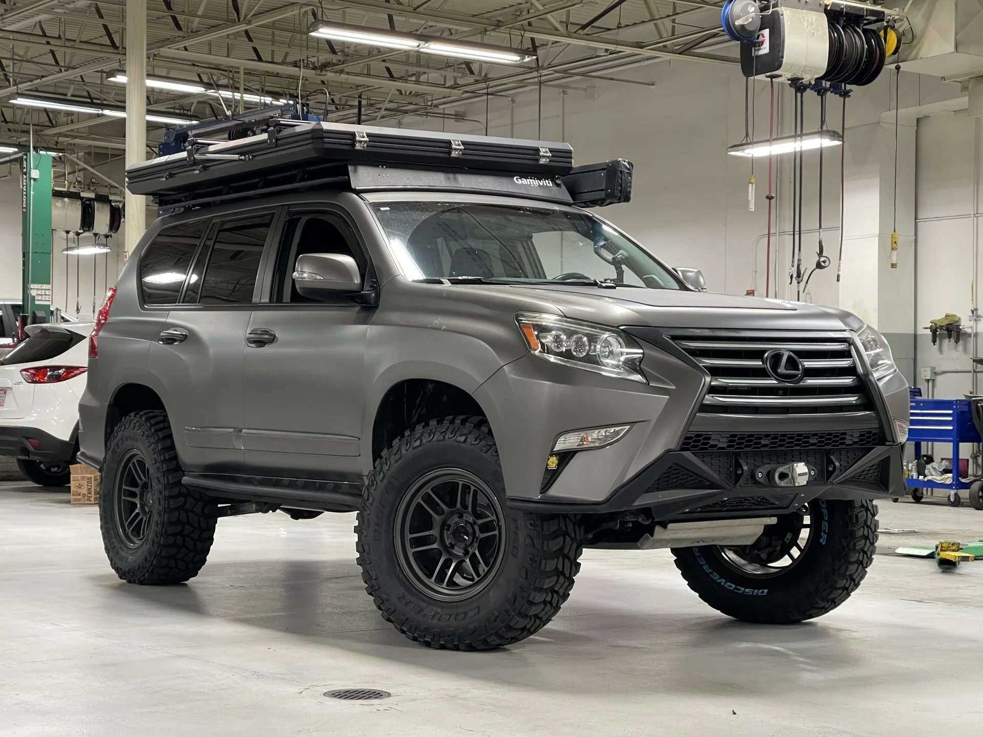

I was able to install my 305/70R18 Cooper STT pros. Measuring in at 35.1”. Wheels are 18x9 +0, with .75” (19mm) wheel spacer. I’m running about +5.7 caster to center the wheels and still have some plastic to trim.
What wheels are those? They look great!

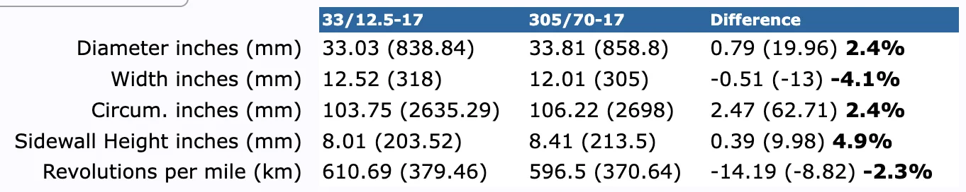

My 33s are vibrating the hell out of me so I'm finally ready to get new tires. I'm running a 2.5" IMS lift with SPC UCAs and plan on going 305/70/r17 this time. I'll need to cut some more on my fender liner but my front / rear bumpers have already been trimmed quite a bit. Hoping the narrower tire will help offset the height difference.
  • Like
Reactions: r2m
You might want to check out a 285/75r17 in a toyo. I personally don't have them but planning for those as my next tire since they are a bit narrower and come in a C rating so should be a buy more comfortable. They are a 34 though, not a 35.
