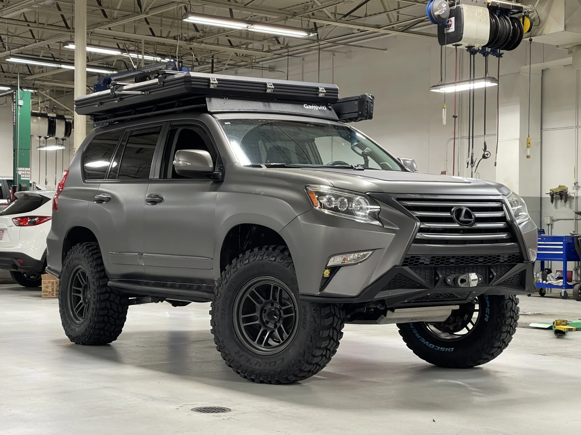

I was able to install my 305/70R18 Cooper STT pros. Measuring in at 35.1”. Wheels are 18x9 +0, with .75” (19mm) wheel spacer. I’m running about +5.7 caster to center the wheels and still have some plastic to trim.
That's look'n dope!
Love the matte vinyl wrap. I want to do a vinyl wrap on mine in desert tan (Army Tan) or Army OD, but too expensive and I have to remove too much for them to get access to the entire vehicle.
Also, I too am running 315/70R17's (35's) and need to do the forward shifting alignment also. I get the slightest rubbing on the back of the front fenders, and even a little rubbing on my rear wheels, but I think that may have to be surgery (metal trimming) to fix that.
Is that 19mm slip on spacer on the stock studs? If so, is there a comfortable amount of stud left for the lug nuts and where did you get them?
