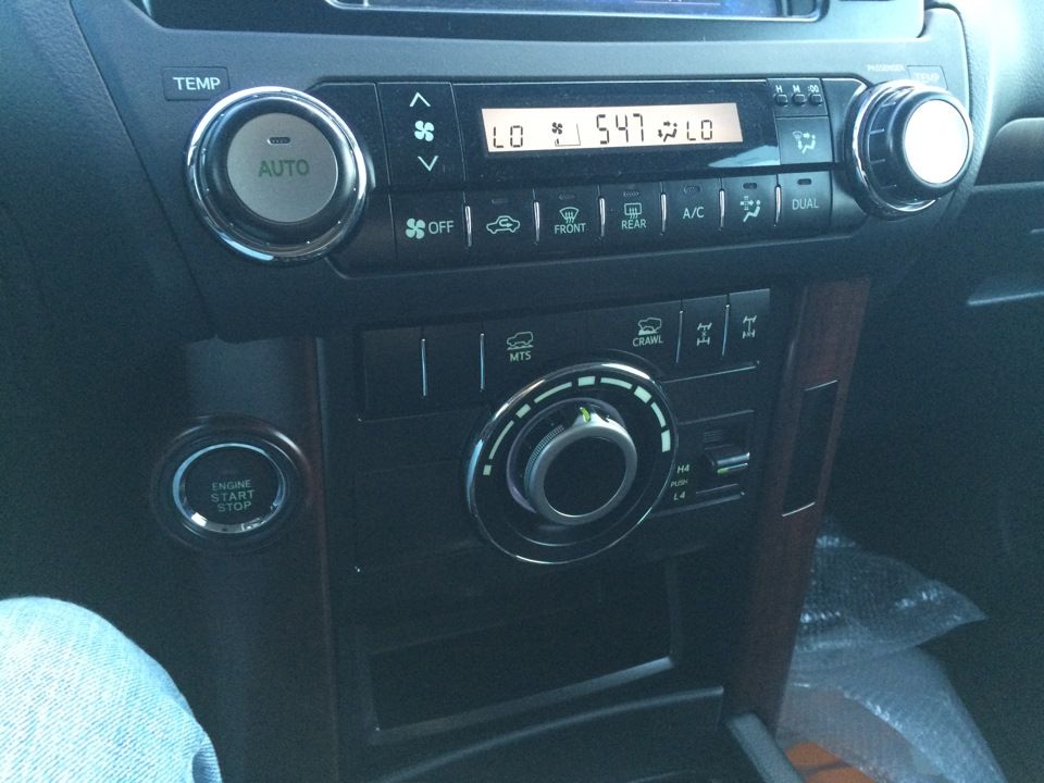

Question. I'm new to the GX, I'm coming from an fi cruiser. I have a16 premium
460 just got Saturday. So for me to add multi terrain I need the new module that goes behind passenger side dash. I got that. My question is to add crawl I need the 4 switch unit. Are the other 2 switches just dead switches the comfort and ride height ones? Is it not possible to just switch out the dachshund switch for the crawl switch? I don't like the idea of having 2 useless switches on the center console. Thanks in advance, and to all those that have shared info here.
Take a look at the first page of the thread. It has the part numbers and place to order. If you have adjustable ride height you’ll need the switch part for that. If you don’t you’ll need the one with only two switches and the other two are just blank spots with no switches. Hope this helps.

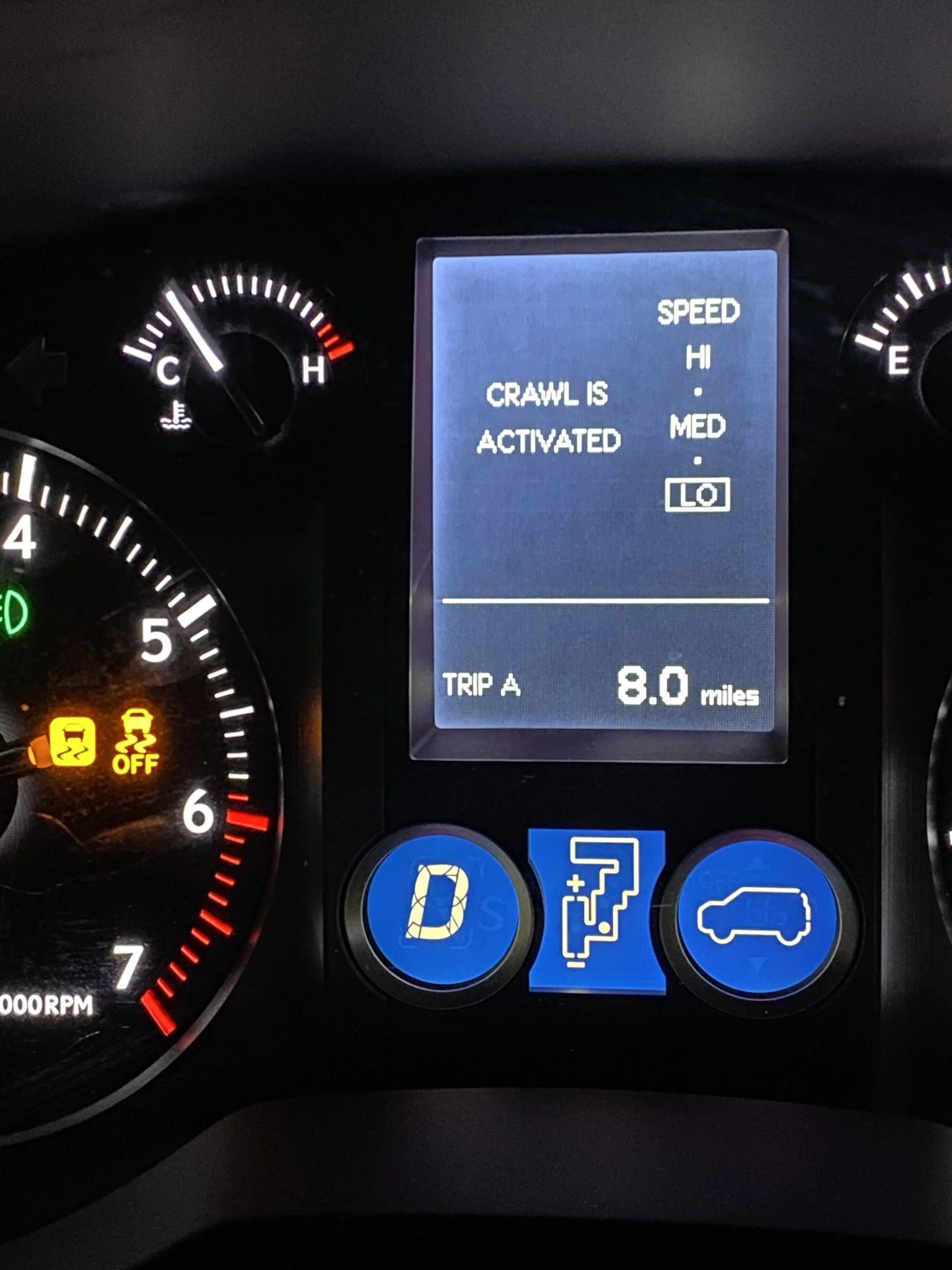

Just for giggles, take a couple of photos of your dash display with them all engaged!
Great job Qball!!
As you wish:
Used my SST or small paper clip cut in two for zero point calibration and activated CC with no issues. However when on lowest speed setting the system seems to go nuts and the car lurches and feels like I’m hitting the brake on and off constantly. caiberated twice and still doing the same, second lowest speed setting and higher seem to work fine. Any ideas?
