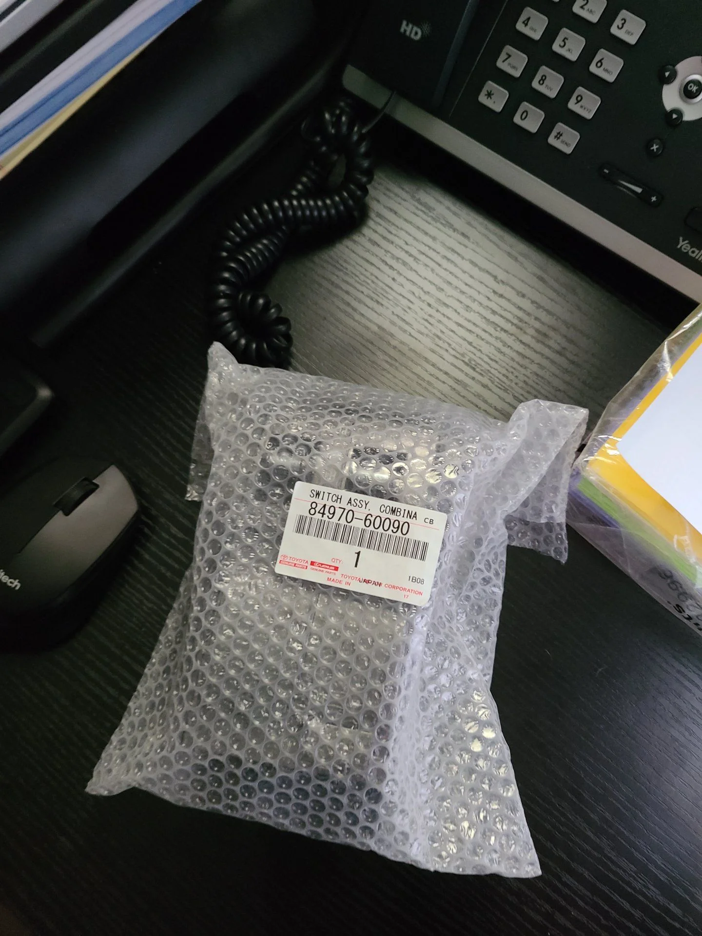

WOO!
just waiting on 84970-60090 to show up (special ordered supposedly) from OEM Parts

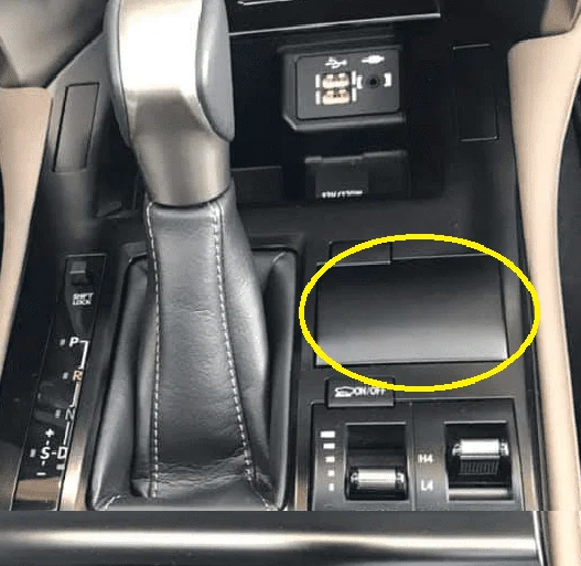

Anyway, I am hoping to add MTS and Crawl to my 2017 Luxury (with the airbags removed and lifted). Coincidently I am trying to find a good place to mount my switches for fogs and off road lights. So I am wondering, if I install the MTS and Crawl, it looks like it replaces my 4Hi/Lo and DAC switch, but does the unneeded height adjust and sport/comfort switch just go away and a blank go in?
I'm wondering if I can cover the blank area with a wood piece to mount either a ram mount type arm for my ham radio, phone or some switches. Also I am a little confused after reading through the thread and wanted to double check what the part number is for my 2017 for the MTS/Crawl modules (and if I need to do the paperclip method).

View attachment 2602916View attachment 2602926View attachment 2602917
I had the same hopes and dreams for the blank spots in the switch assembly but unfortunately there is no real-estate under those blanks because there is a one piece circuit board right under there.
