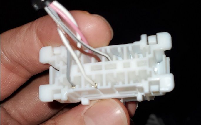

Wish we had some pics of the underside of console switch and the unplugged connector.

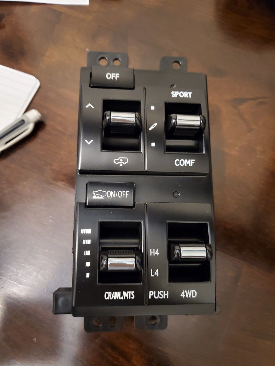

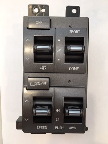

I ordered the 2020 model of the console combo switch (84970-60470) for my 2020 GX460 premium from oemvehicleparts.com and what I got was the exact same console switch with DAC instead of crawl control. Then I read about (84970-60450) on page 9 of the thread... Now I need to call them and make sure I'm getting the right part... either the 2010-19 model (84970-60090) or the new (84970-60450) . I will keep you updated on the process.
2020 is an untested & unknown at this point
You don't want the 10-19 parts here as switch is physically different for function on 2020. I am told that the crawl switch for 2020 is 84970-60450
Will it give you crawl? No one can confirm at this point. Keep everyone posted how it goes once you get the switch.
Also make sure you don't use a VIN on ordering these switches or they they will go by what is stock in the vehicle.
The two switch 090 equivalent switch for 2020 doesn't exist beyond the 10-19 models
Ok, I did not know the 10-19 switch is different. I will call and ask for more details before sending the new part.
The one I got (84970-60470) seems the same on the front and has an 8*2 socket on the back.

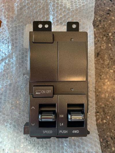

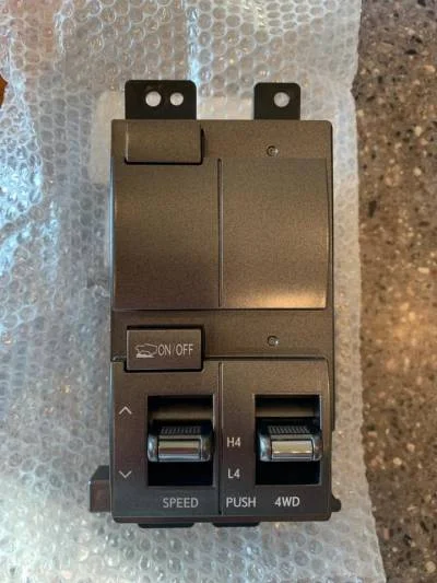

10-19 crawl control switch options. Speed is toggle switch that goes forward and back. MTS is controlled from steering wheel.

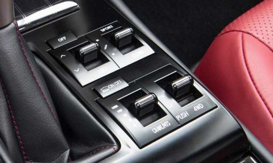

2020 is a 5 position switch where it says Crawl/MTS. Crawl speed and MTS mode is controlled from the CRAWL MTS toggle.
View attachment 2309911View attachment 2309912

So, I finally got the new console switch, which seems to be the correct part with crawl/MTS for 2020 models.

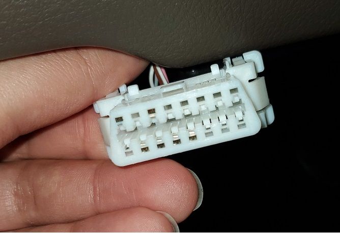

But just as I started the installation and zero-point calibration steps, I realized the new OBD port is different from previous versions. It has only 6 pins, 2 on the top (pins 1 and 3 from left) and 4 pins in the bottom (pins 2,3,4,5 from left). The user manual doesn't have any info about it, I don't know how to figure out which pins are the CG and TS.
Got a mini OBDII communication interface from Amazon to see if that would help to connect using the software. I appreciate it if others could help me figuring our zero-point calibration on this port.
So, I gave it a try using Techstream, followed the steps in this video and this page for memory reset and zero point calibration. The lights blink but pressing the crawl on/off button does not seem to activate it. I think I'm not doing the memory reset step correctly. I see a message of "front camera not working" right after exiting the Test Mode tool, which I suppose is an option for the offroad package. The 4lo switch works, but vsc light is on and emergency break is deactivated. Fron display says visit to the dealership. ha ha...
