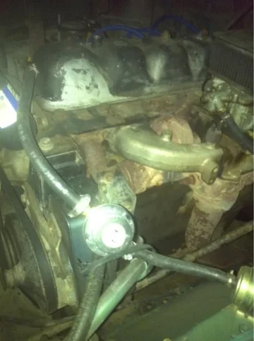

If it is lean, wouldn't I want to dial up. Does dial up add more gas or more air?
Is this what we are talking about dialing?

Weber carbs tend to run rich in my experience. It is true that you can turn down the pressure regulator to held avoid flooding which can be most useful in off road situations.

Yep bossman. Mine has run rich for 12 years. Not touching it! Runs great
I ran a Weber 32/36 progressive on one of my old 40's and loved it. Ran rich no mater how I tuned it, got terrible fuel economy, had good power, and I used a fuel pressure regulator to turn the pressure down to the 2 setting when I was wheeling. Did great.
