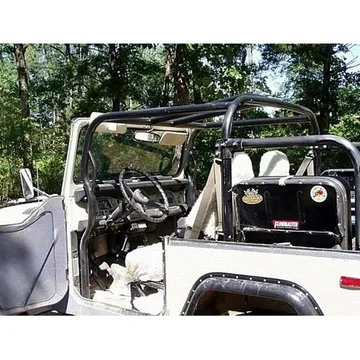

  • Family roll cage- bonus if possible by MK2015
I got the front part of a metal tech family cage if your interested.
I am interested.. how did you end up with a partial of this?
I wondering how I get the rest of the kit since it's sold as a pkg.
Or, do you have the front profile instead?
Is this still in kit form or welded up?
