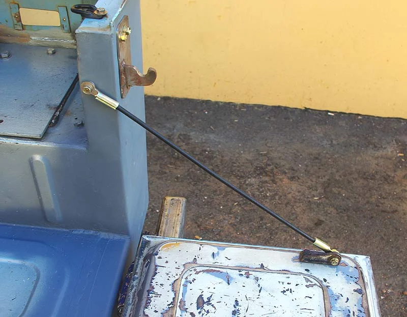

Tailgate support cables from a 1990ish s10 blazer (pickup) work well - meaning they can support me sitting on it.
EDIT: actually, you DO NOT want the pickup cable, you want the one from the S10 full body (sorry for the mistake - geez, it was only a half a year ago, and I can't even remember anymore which one the incorrect one was that I had to send back :rolleyes:)

Tools R Us made step/adaptor washers to space them properly from the body, but normal washers would work, too (more pics on washer/spacing detail here https://forum.ih8mud.com/showpost.php?p=8825434&postcount=501).
I am still missing weather stripping on the tailgate (will go on after painting), but it doesn't even rattle now

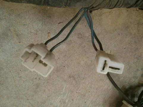

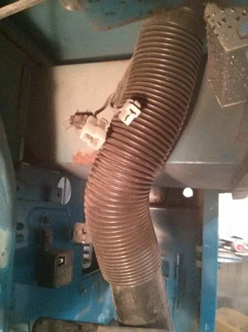

Anyone ever install a harness plug for the wiper wiring where the windshield frame meets the cowl? I'd like to make it much easier to fully remove the windshield when wheeling. The inside of my windshield gets absolutely nasty during the Crawl while laying down on the hood. It also limits visibility at the right front corner. In the event of a flop (please no, not again) it also eliminates the potential for damage to expensive, hard to find parts. I guess I'm looking for a plug to splice into the 4-wire harness. It will need to fit down into the hole in the top of the Cowl that is around 1.25". A Toyota 4-wire plug from an FJ62 is too big. Thanks for the input.
On mine (assuming yours is similar) the wires from the wiper motor extend through and terminate at two connectors on the left side of the glove box:
The harness drops down right there with two mating plugs:
Why not cut the plugs off each end, splice the wiper motor wires into the harness wires right there at the harness, and resplice the plugs at the top of the cowl or inside the windshield frame... essentially just make the harness side the long end and the motor side the short end of the connection?
Wow JT! Great info with pics!
Let me see how hard it will be to use the OEM plugs.
Thanks for posting.

Can one of you give me a measurement on the S10 cable? The RR cables I picked are too short.

About 17 3/8", from a S10 Blazer (actually specifically NOT the pickup, sorry for the earlier mistake, I have corrected it - the pickup cable has an ugly angle catch to it).
for the catches on the tailgate, we used what the OEM tailgate came with, but turned them around; and new holes were drilled in the quarter panel posts to mount the cables - if you make your own catches, length of the cable would dictate where you drill the holes
the hooks on the quarter panels were custom fabricated, since the OEM tailgate hooks would not line up with the captive nut holes in the quarter panel and the tailgate handles at the same time - looks like your captive nuts are in a lower position than on my '72 tub
