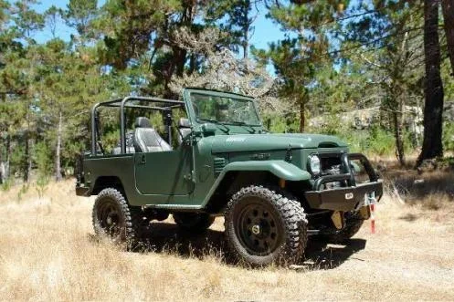

I was thinking of designing the rear cage like the pic above and then tie the metal tech front to it.
I like the look of it in the pic, nice simple but not sure it is strong enough.
I was thinking of designing the rear cage like the pic above and then tie the metal tech front to it. I like the look of it in the pic, nice simple but not sure it is strong enough.
Haha, you managed to find a cage uglier than MT. That is a feat.
Just buy the rest of the MT cage and be safe. Drill a hole in the original hoop and see how thin that tube is. I wouldn't trust it. Just sayin...
