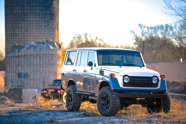

The guys at ACC Garage combined an 80 frame, drive train and interior (!) with a 55 body. It is just so badass - open the door to an FJ55, and get in an FZJ80... the leather seats, curved (cut down) dashboard. I have no idea how they pulled it off (what was stretched, what was shortened), just that was a s***ton of work (and $$$). But man, the final product is just awesome:
