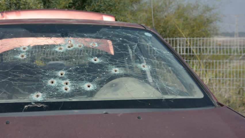

Windshield exploded today... glass shards everywhere. Glad I was wearing sunglasses 😎
No other cars around... no idea what it was, meteor maybe? Scared me to death. I flinched before it hit so my eyes saw something coming.
Glass all up in my beard! There was glass shards are far back as the rear drawers.
probably a 3/4” indention but the plastic safety layer held.
I guess I’ll knock out that surface rust under the windshield gasket I’ve been looking to repair. Sheesh. What a pain.

Did you ever gain any insight into what happened with the windshield? That’s some impressive damage! Kids with rocks?
I didn't, I've got an appointment for a new windshield this week. I might head to some open space and practice my shooting through barriers before heading in ;)
Original glass? I’ve been struck hard (oncoming semi-truck kicks up a rock) but never saw that much damage. Glad you came out safe.
It is OEM marked not sure its original.
I had that same thing happen to my windshield on the freeway. Crazy. But I like your idea, take it in to the windshield place and tell them you have no idea what happened - haha
