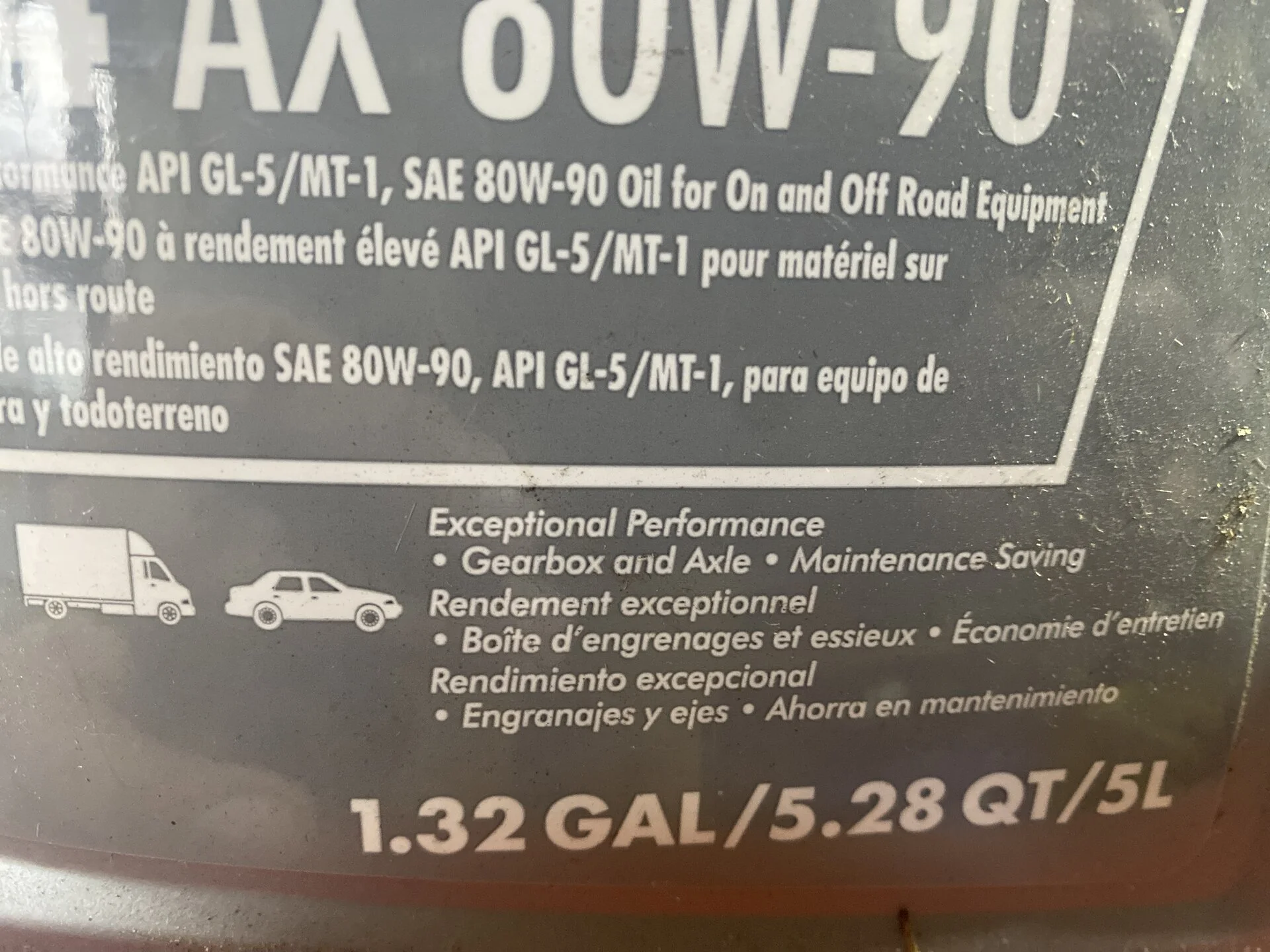

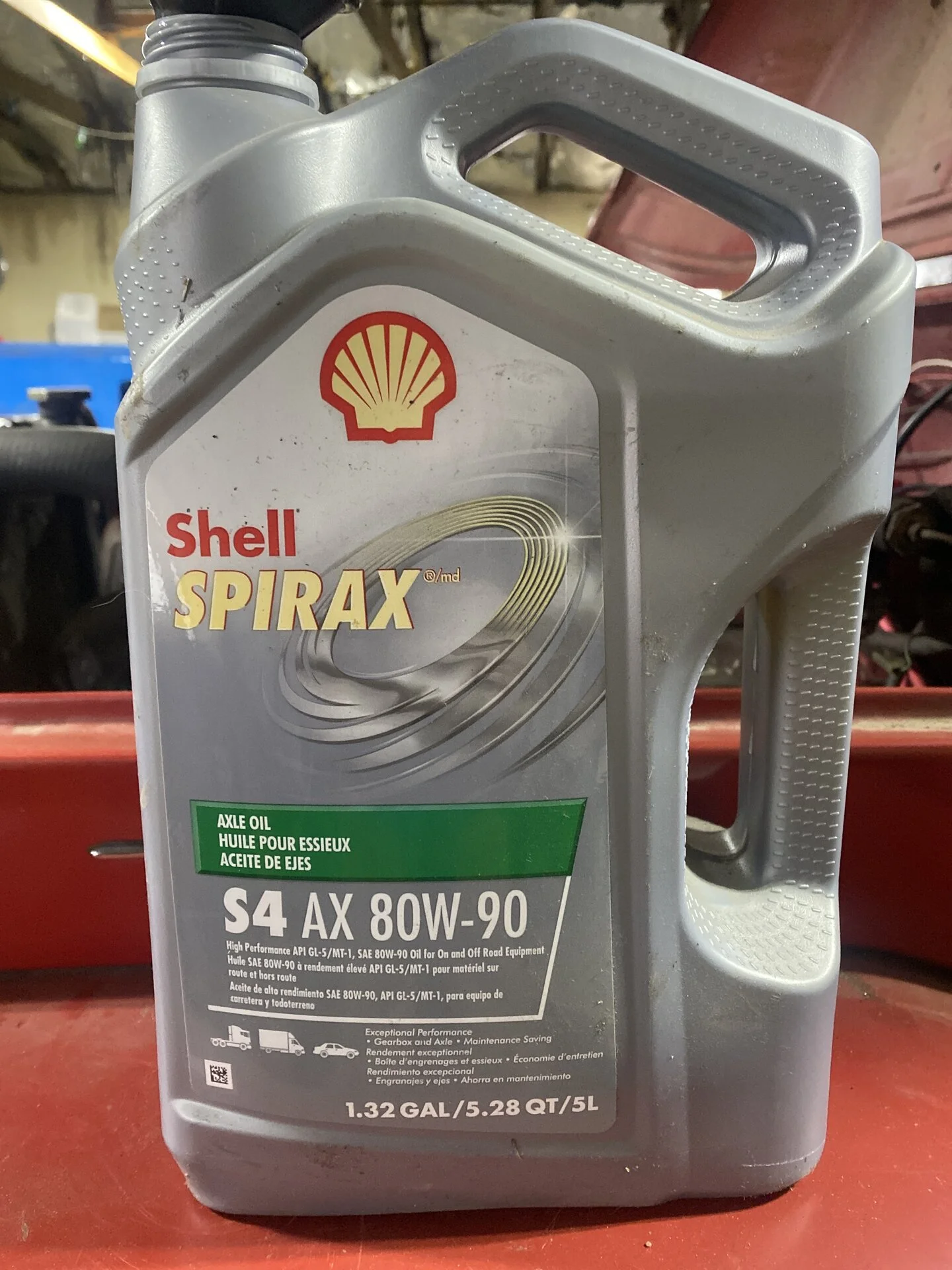

reviving old thread. gl-4 is crazy hard to find where i am. this says it’s good for gear box and axle but it’s gl-5. any thoughts using it in my h42?

do not put straight gl5 in your transmission.
what does that jug say on the back side?
it doesn’t say anything on the back. the data sheet says good for transmissions and axles but nothing specific about syncros. says it’s dana approved so i assume there are syncros in there.
"says it’s dana approved so i assume there are syncros in there" Correct me if I'm wrong but Dana is most known for axles and not transmissions. A gallon jug of gear oil is not really that much when you consider how big the front and rear ends are. Add in the t-case and transmission and you could use 2 gallons.

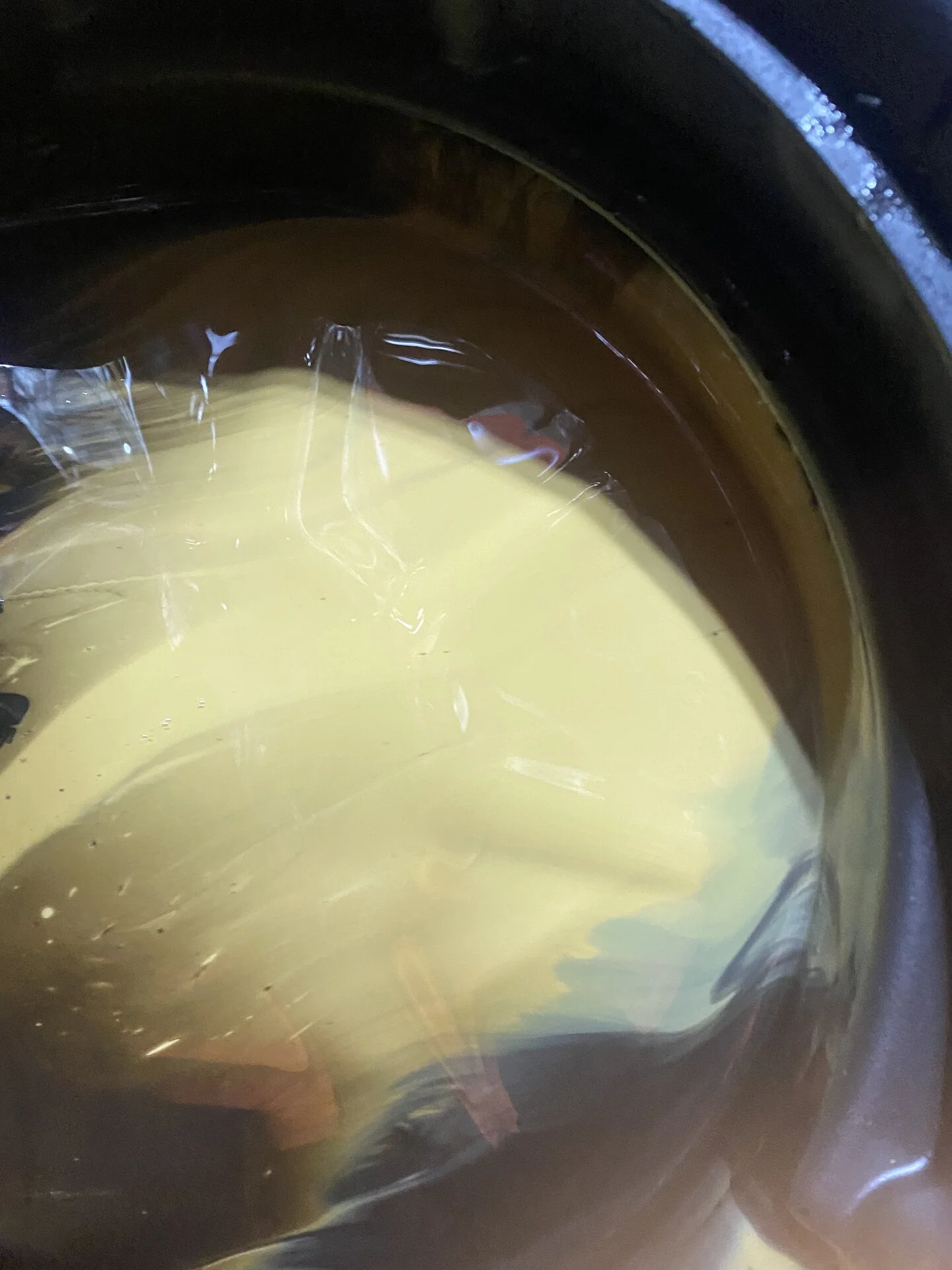

you’re right there. i think i had alison in mind not dana (i’ve never had either so i’m no expert) . anyway i’ll use it as a tranny flush cause it’s in there now but i won’t leave it long. this is what came out so i’m sure what i have in is temporarily better.
