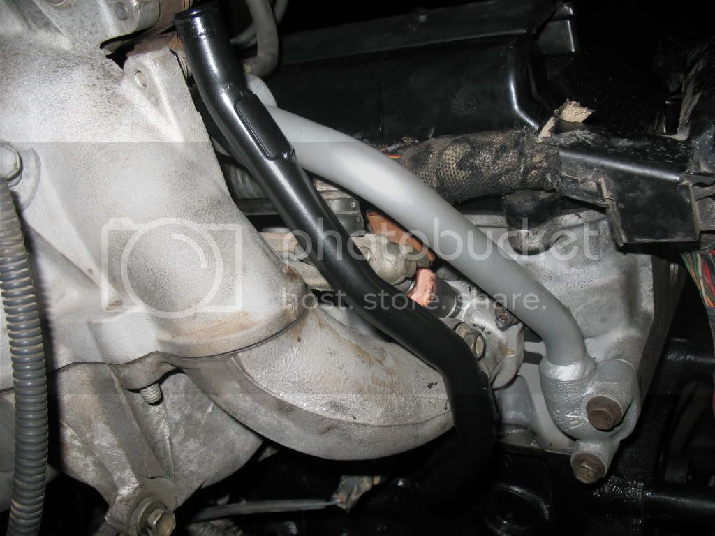

This is also a good time to get rid of the metal tube that goes behind the intake manifolds and connects the PHH to the heater valve. Just put one long piece of Gates and call it a day.
I would also do a nice wrap on the wiring harness, while you are there, especially if you are going to be keeping the EGR valve. The metal tube from the back of the head to the EGR valve itself gets very hot during operation--close to 1000 F. You might also want to not route the harness through the intake runners like they did from the factory--you can still get the injector connectors attached to the injectors if you route it differently--i just ran the whole thing underneath the intake manifolds.
Good plan. I was going to see how it fit, but the master will be in the way from the top and the inner fenderwells are probably worse than on the 80.

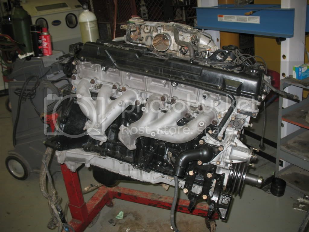

Box full of happiness on my porch when I got home.

We ran the wires through the intake because not all of the injector plugs would reach.
I'm also going to run the PHH tube for now. It looks really pretty with the new powder coat and I can always pull a fender to replace the hose every 100,000 miles. Neither tube is close to the stock heater hose location for a 45, but then I don't have a stock heater hose location since the 45 was a non-heater truck.

I'll wrap the EGR tube in high heat wrap

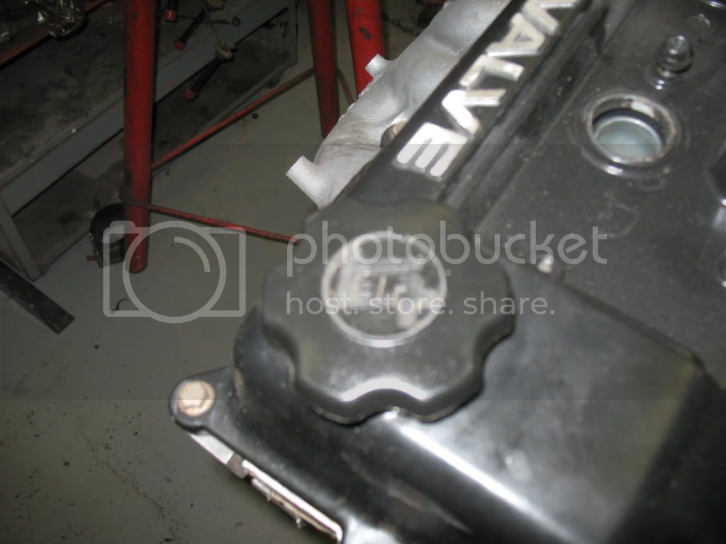

I don't know why it makes me so happy that the old school TEQ cap fits, but it does.
The OEM wire harness for the injectors should reach the injectors even if you do not route the harness through the runners.

If you are keeping the EGR valve then keeping the metal tube there makes sense for the high heat from the valve pipe to the back of the head.

We finished the motor yesterday. What a cluster. Gotta bolt the engine to the trans today and give her a test fitting. I have to remember to bring the camera to work.
