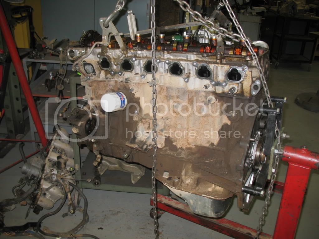

I started tearing it apart today while on hold to talk to Bank of America's ATM divsions (bastids:mad:) Obviously I was on hold for a while since it was hanging from the chain fall fully assembled when the phone call started. Full gasket kit and head bolts will be at the shop tomorrow. We'll see about bearings and rings once it's apart.

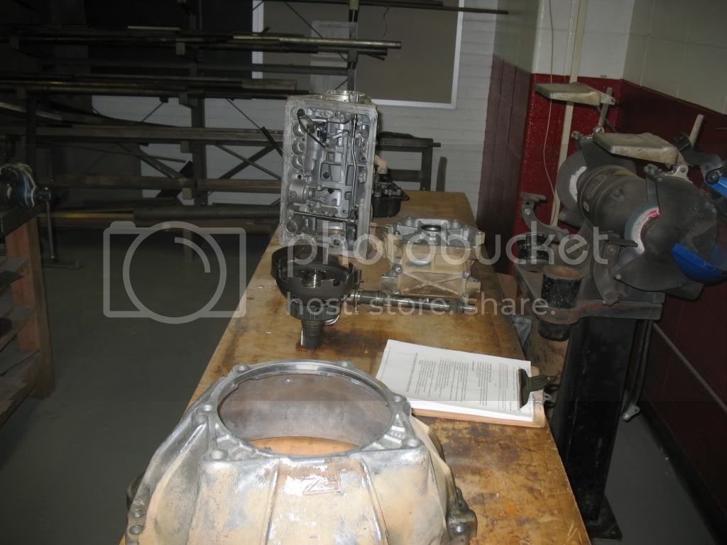

The trans came pre-disassembled. Supposedly, the only thing wrong with it is the torque converter, but I'm not going to skimp on the cost of the friction plates and band when I have to replace the gaskets and seals anyway. The clip board has the Toyota FSM assembly instructions.

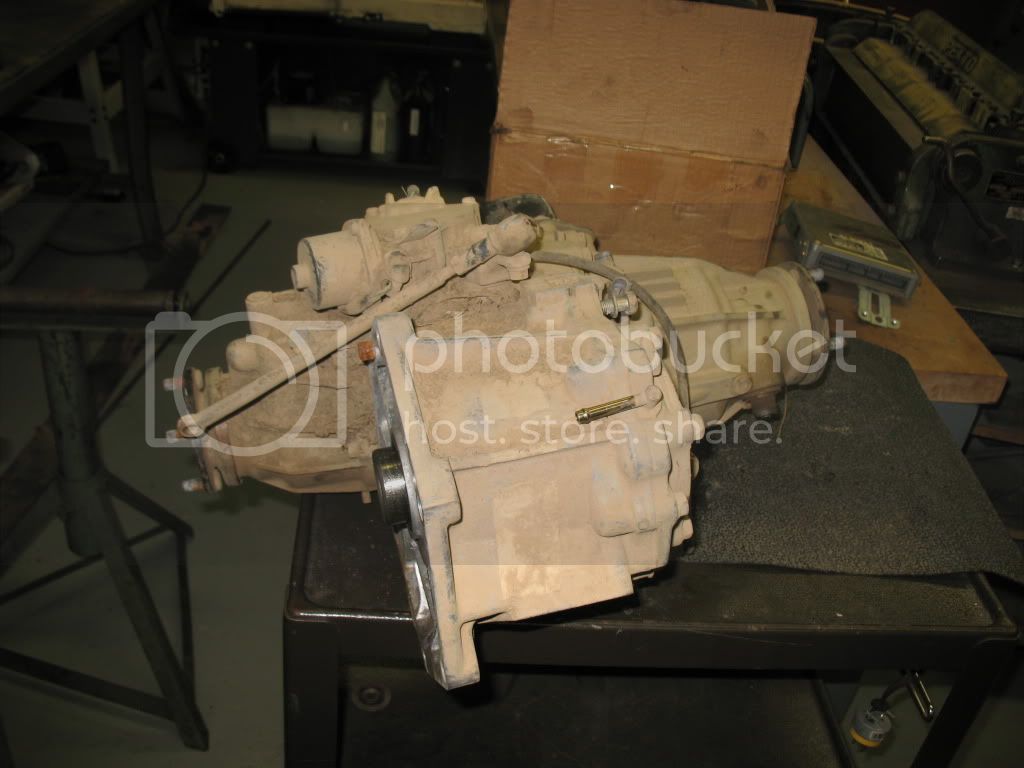

Transfer is all good, just a little dirty. Right now I'm leaning toward full time. I liked it in the 80 just fine.
Somebody asked why I would put a 270,000 mile engine in a car.
'Cause it's a Toyota.

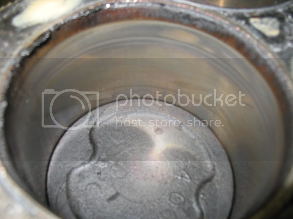

Can't catch a fingernail on the ring ridge. You can still see hatch marks from the honing.
I might put bearings in it since they're cheap, but I really can't imagine there's a problem with them.
