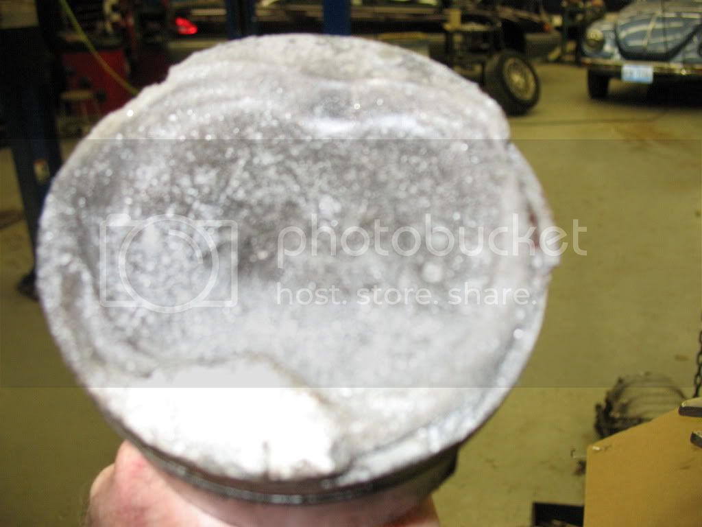

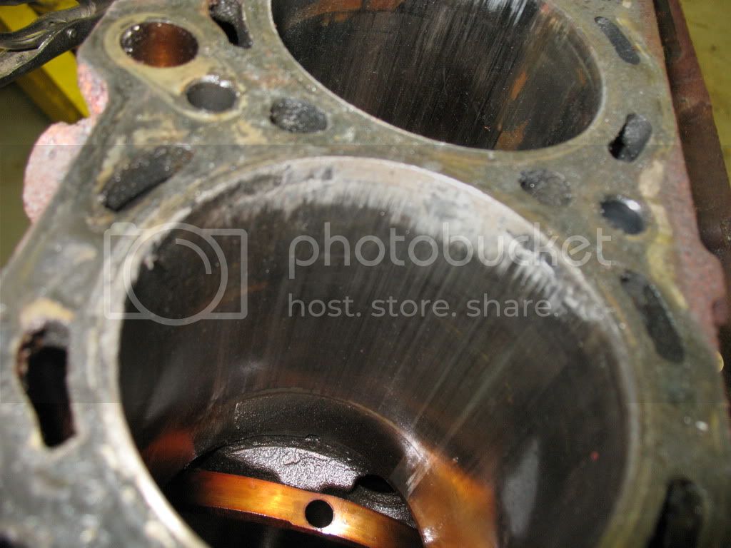

however, i opened it up today and found three pistons melted from extreme detonation. I called CDan. he found the pistons, but no rings. List price for the parts is well over $1000 just for the pistons and rings. No machine work, no gaskets.
I think this 4.7 isn't the right one for me, but I'll keep looking
I think I can get a supercharged 5.7L iForce and 6 speed in it for under $15,000. Anybody want to spot me a whole lot of cash to see if it could be done?
edit - found some .020 pistons and rings for close to reasonable, so maybe we're back on again. We'll see what the machine shop has to say.

I personally would not bother rebuilding a toyota V8 unless you do it a lot. not saying you are not capable, what I am saying it toyota parts are so expensive it would seen like a dark hole you could be pouring money down without a bottom in site. not like a chevy V8. I would look for a better toyota V8 that has no issues. my question about the wiring was: how hard is it to get the toyota computer to run the engine once you pull it all out of a stock truck. would you end up with a lot of error codes etc that would have to be worked out?

You are probably right about the engine. Right now I'm looking at being into the engine for about $1400-1500 and still needing a fair number of parts. Harness, gas pedal, MAP, etc. At best I can get the same amount of HP I can get from a 5.3L or 5.7L vortec that will bolt right up to the drivetrain I want.
