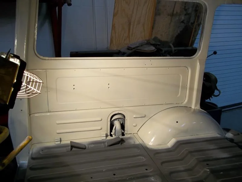

Shot the interior today. Probably will need another coat. I know I have a couple of runs and I imagine I'll find some light spots when I get some light on it.

Hit the rear interior with white yesterday. I'll second coat it today and hit the floor with whatever I decide to do there some time this week. The DP90 flat black sealer looks good and is pretty close to correct. I have plenty to do it in white even though I'm going to cover it up. Or I could bed liner it.
A little touch up, then I can start assembling the interior. If nothing else it will help to get some parts consolidated and out of boxes.

I vote for bedlining the floor.
I would look at Lizard Skin Products. Sound Control and Ceramic Insulation combination for the inside. Friend of mine shot them and said he was impressed with the stuff. He does a lot of cars so I trust his opinion. He said it has the texture of Schutz or Orange peel undercoating, not too rough. I think I will be using Raptor outside with the LS inside. They are sending me texture samples.

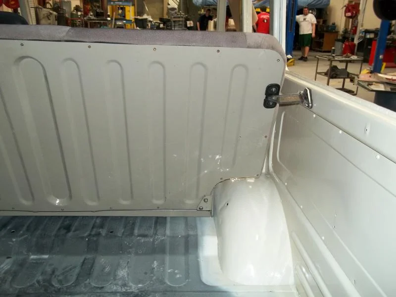

What are the two holes for in the wheel wells?
I don't think the holes in the wheel wells are factory, neither of my '64s have them.
