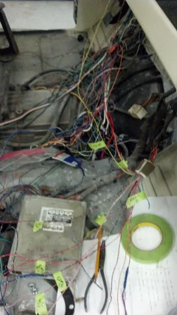

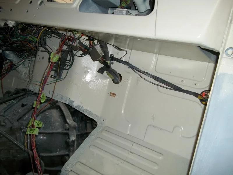

Getting the two big engine harnesses all labeled and run
About 8 hours of sorting, soldering and shrink wrapping.
Both harnesses are mostly all in under the dash.
A lot more of the stock harness will come out including all of the fuse box, but I need to work it out one circuit at a time. I'm using the 80 series fuse boxes and relays, but all the 45 switch gear. I need the space where the stock fuse box is for the heater and the space under the glove box for the FJ55 factory AC.
And yes, I will be installing grommets.

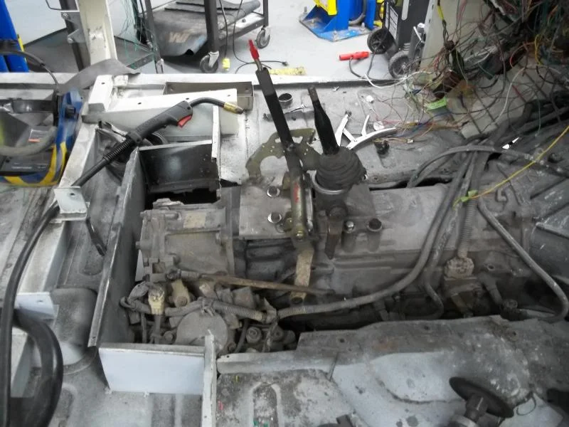

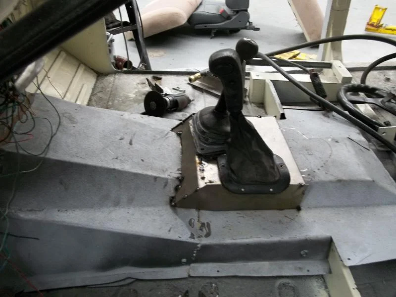

Spent the last two days mostly messing with the shifter. I need to use a 80 shifter, because lokar doesnt make a good mechanical shifter with a right hand linkage. I hated the giant console I would have had to use to use the whole shifter plate so I cut it up into the basic parts and am reassembling it to be clean and less automatic looking.

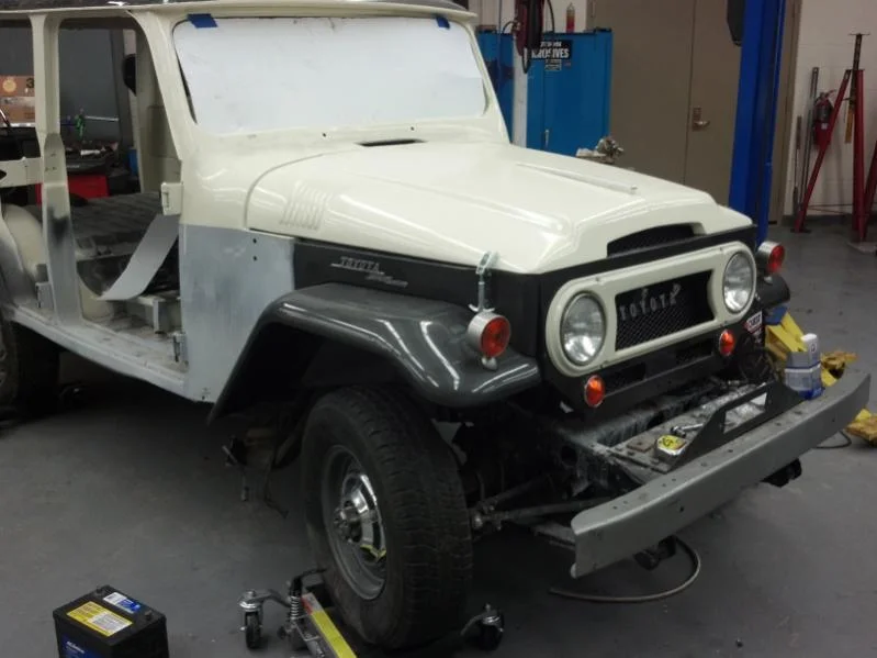

I also put the front clip back on to look at radiator/condenser clearance and such. The headlight bucket hits the battery tray.

I built a plate that bolts onto the top of the transmission to hold the shifter assembly. then I built a riser about an inch off the tunnel. The transfer case boot from a 40 covers the selector comb perfectly. I took pics but left the camera at the shop. I just need to fab up a shifter rod since they are discoed from Toyota. I am missing the shift lever from both A343s I have too. I found a lever from an air valve with the correct hole and shape. I just need to measure a stock one to figure out where to put the hole so the detents in the trans line up with the shifter stops.

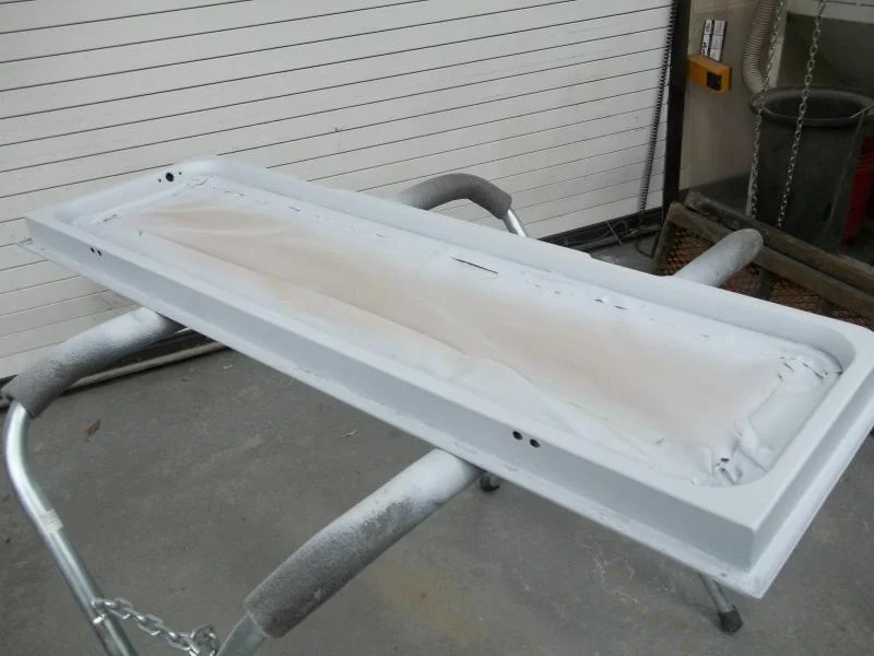

Today was a good day. I got mostly left alone and made some progress. Welded up the shifter console. Sanded down, epoxy primed and high build primed the upper tail gate. Put the drivers side doors in high build as well.

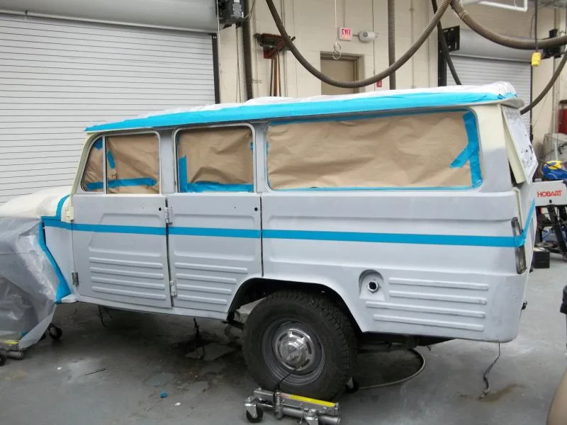

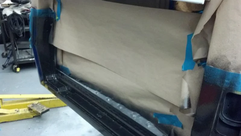

Painted the insides of the drivers doors, lift gate and tail gate. Masked off the roof and front clip. Mounted the drivers doors and tail gates so I could run the line for the color change and masked the jams.
It was nice of Mr. T to put that body line in such a random place.

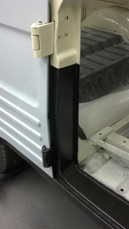

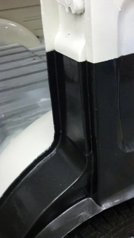

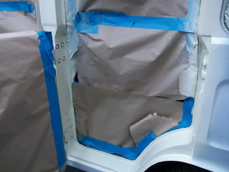

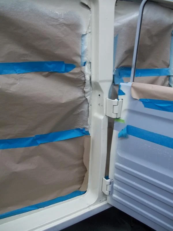

blocked and painted the jams white. Painted the tailgate insert white as well.

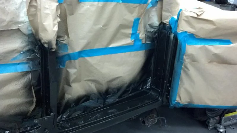

stated masking off the jams and doors for grey. Ran into a couple of soft spots so I called it a day, took a couple of pics and went home for a nap.
