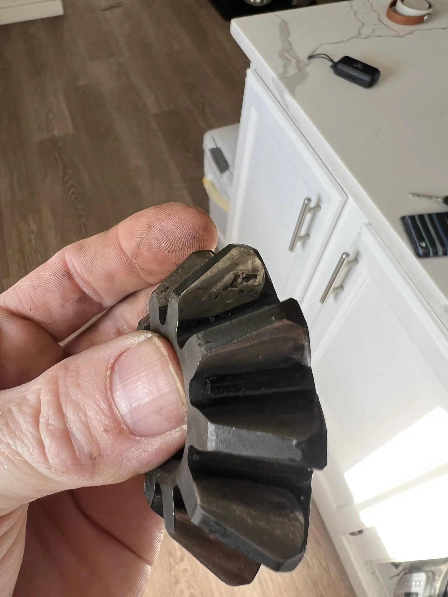

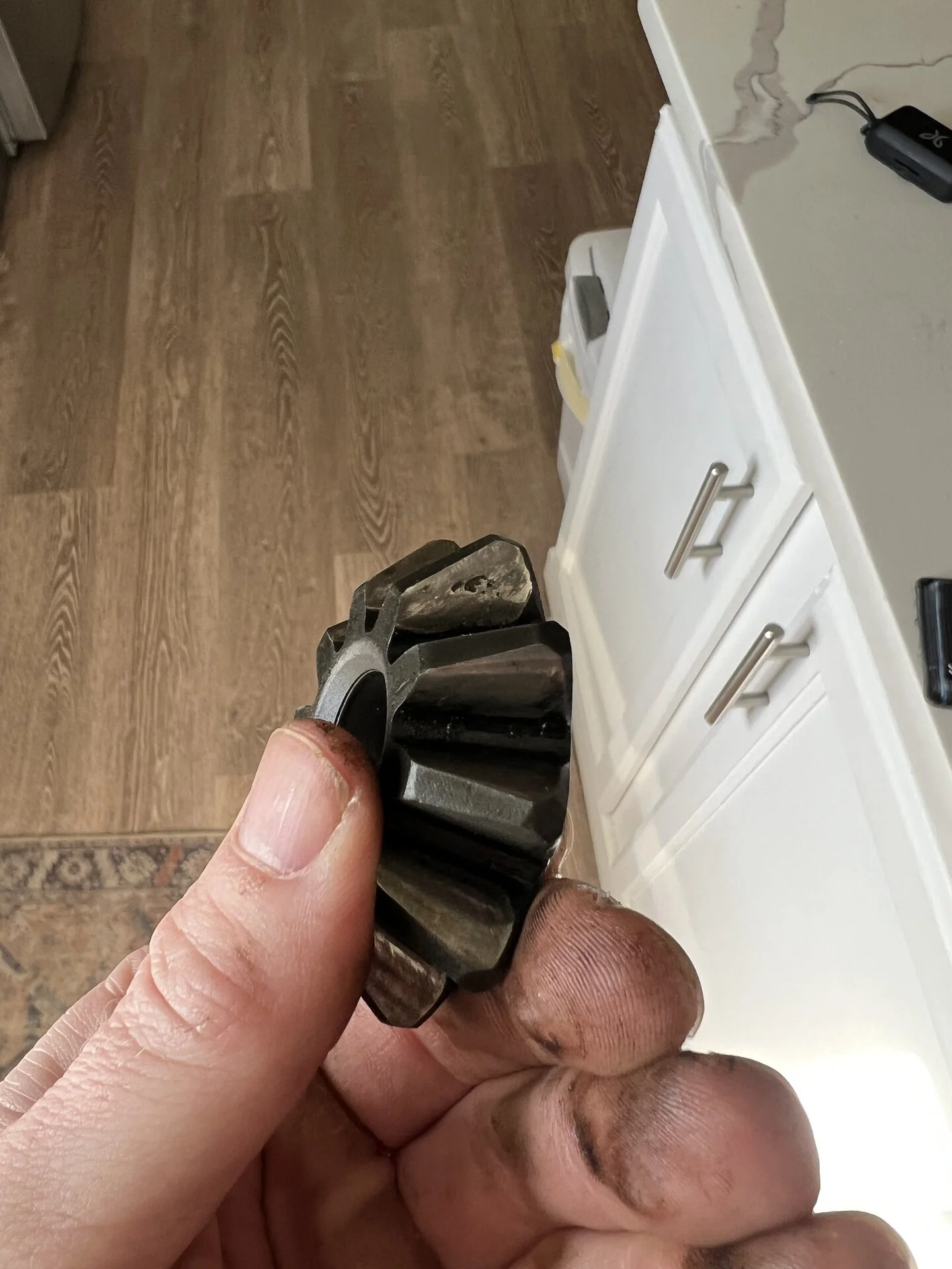

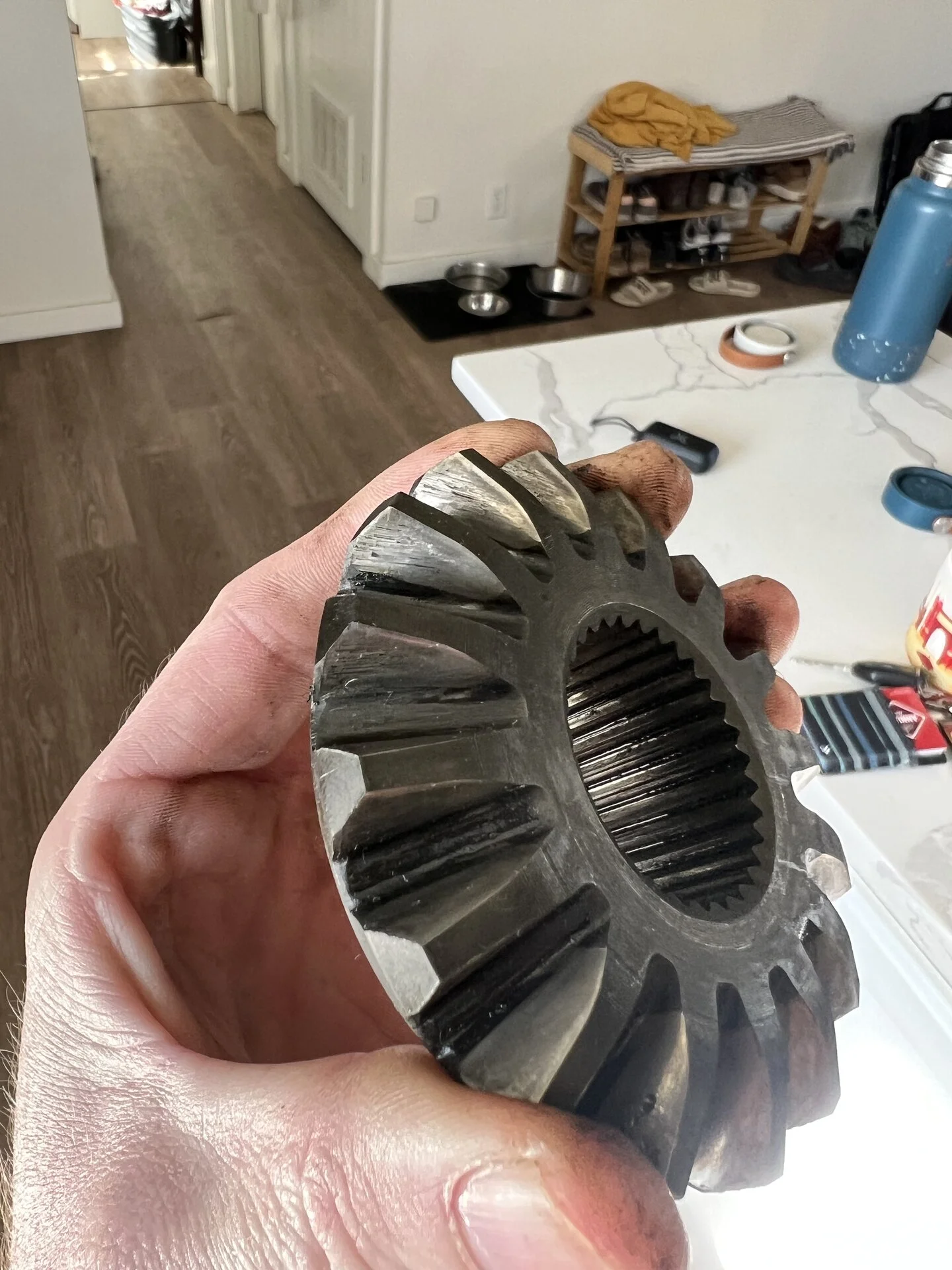

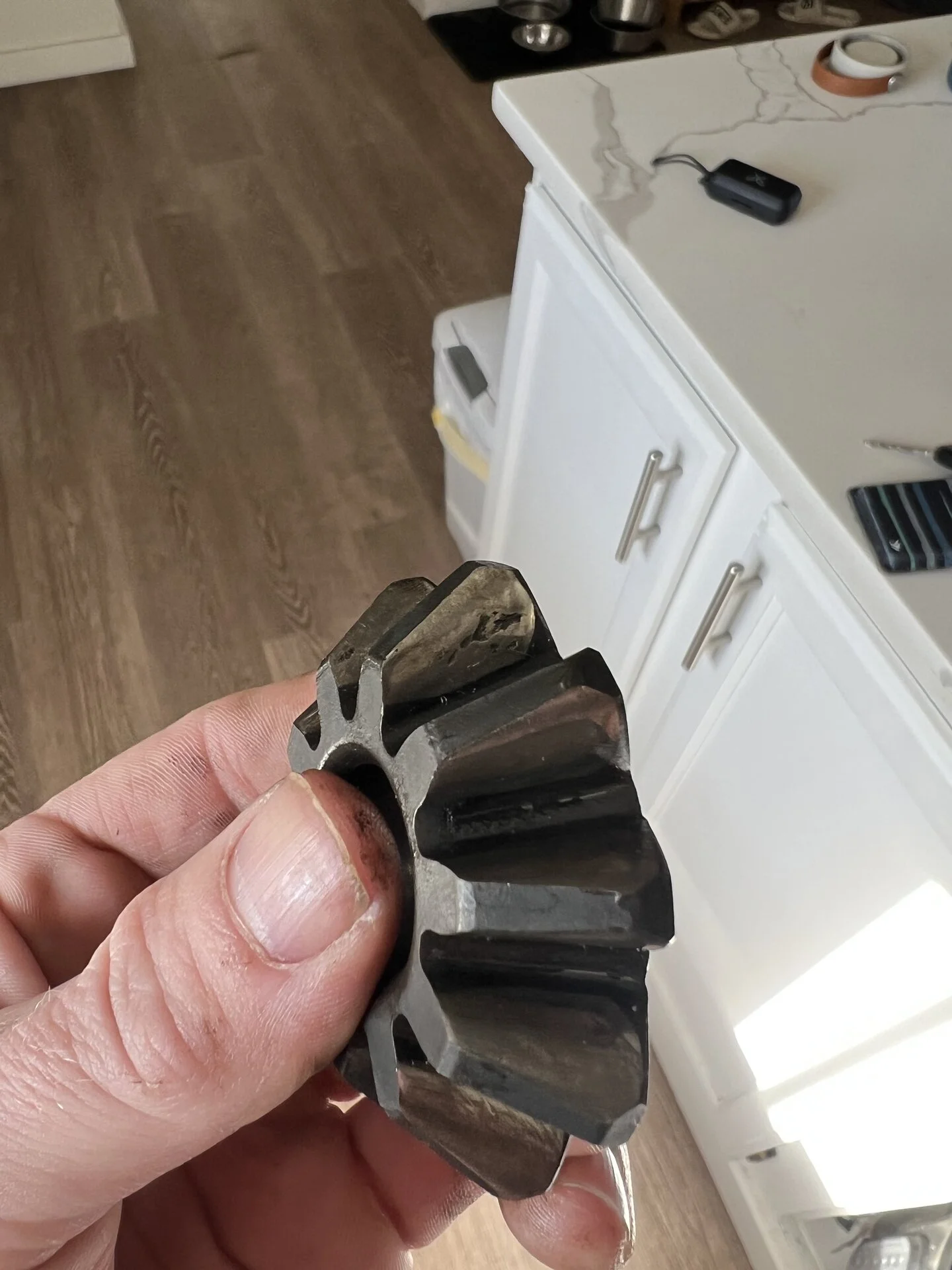

I’ve been working on a regear to 4.88s I noticed some pitting on my spider gears and just wanted to check with someone who is more experienced with these.
I’m only asking because I’m having a hard time finding/getting the replacements.
I attached photos of the spider gears, let me know what you think.
Thanks in advance!

My pinion gear sheared off a couple teeth on the trail. The damage wasn't horrible because as soon as I heard it I stopped and pulled the Driveshaft and axles. I imagine these nicks are from pinion gear shavings since its only on a couple teeth. Before taking them out of the Carrier everything ran smooth. Just not wanting to install if they are just going to break into pieces after a few thousand miles.
No crazy chunks of metal on the magnet. No prior work on diffs that i know of. I assume diff failed because the axle seals failed and pulled all the moly grease from the knuckles in.
