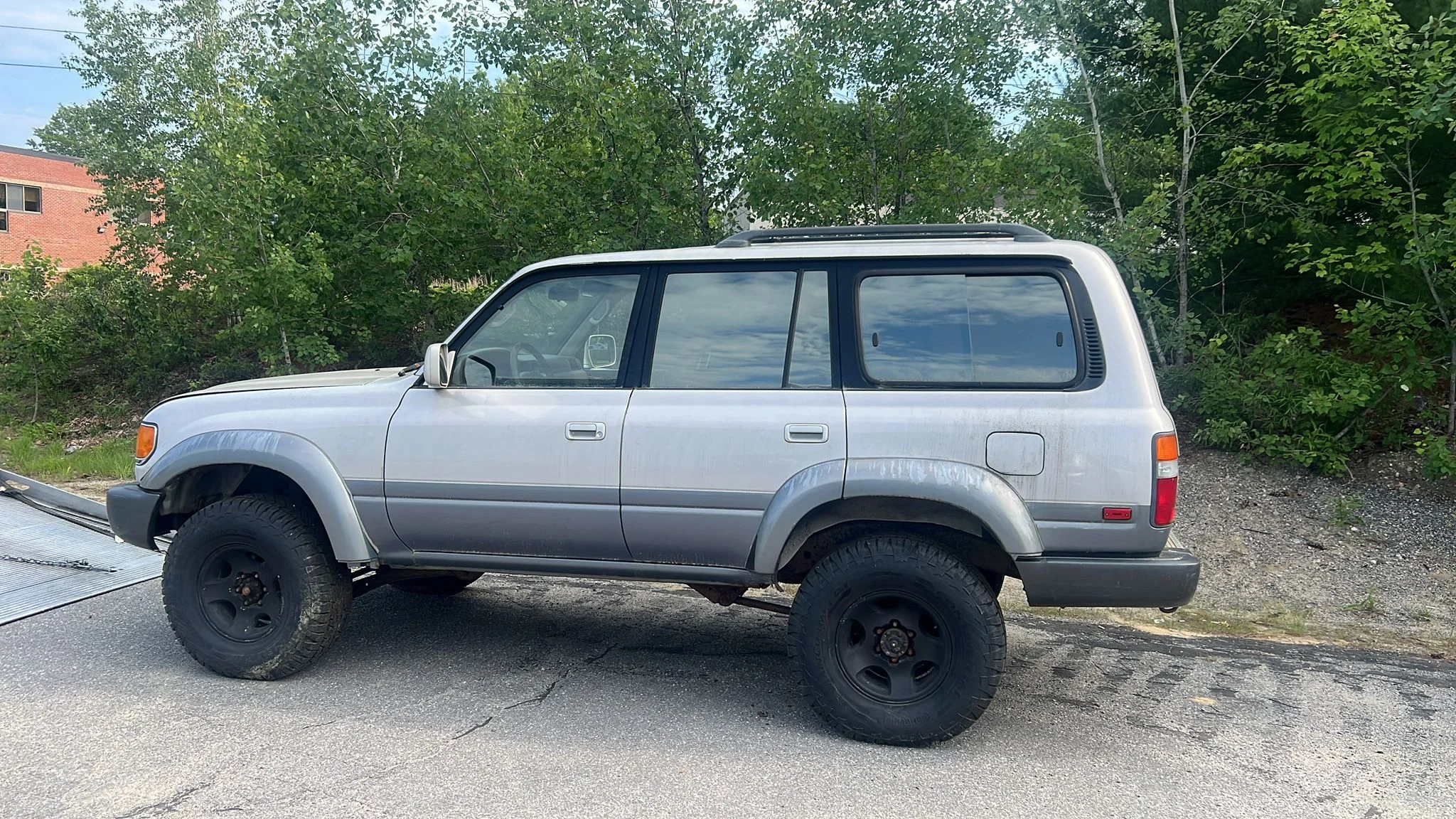

Just picked up this beauty 1997, its been off of the road for 9 years. As far as I know I am the third owner , interior is imaculate, exterior is decent, no accidents. It does seem to have a minor lift along with a snorkel. I have starting wrenching on it already, took the seat out as it needs the slide gears replaced, then took out the air box as it had some leftover acorns in it that got removed. At the moment I am working on replacing the heater hose that resides beneath the air intake.
I need to rebuild the knuckles plus get doing some research on how to resolve the surface rust on the frame along with a couple of rust through spots on it.
i see we have a 1FZ masquerading as a 3FE ;)
