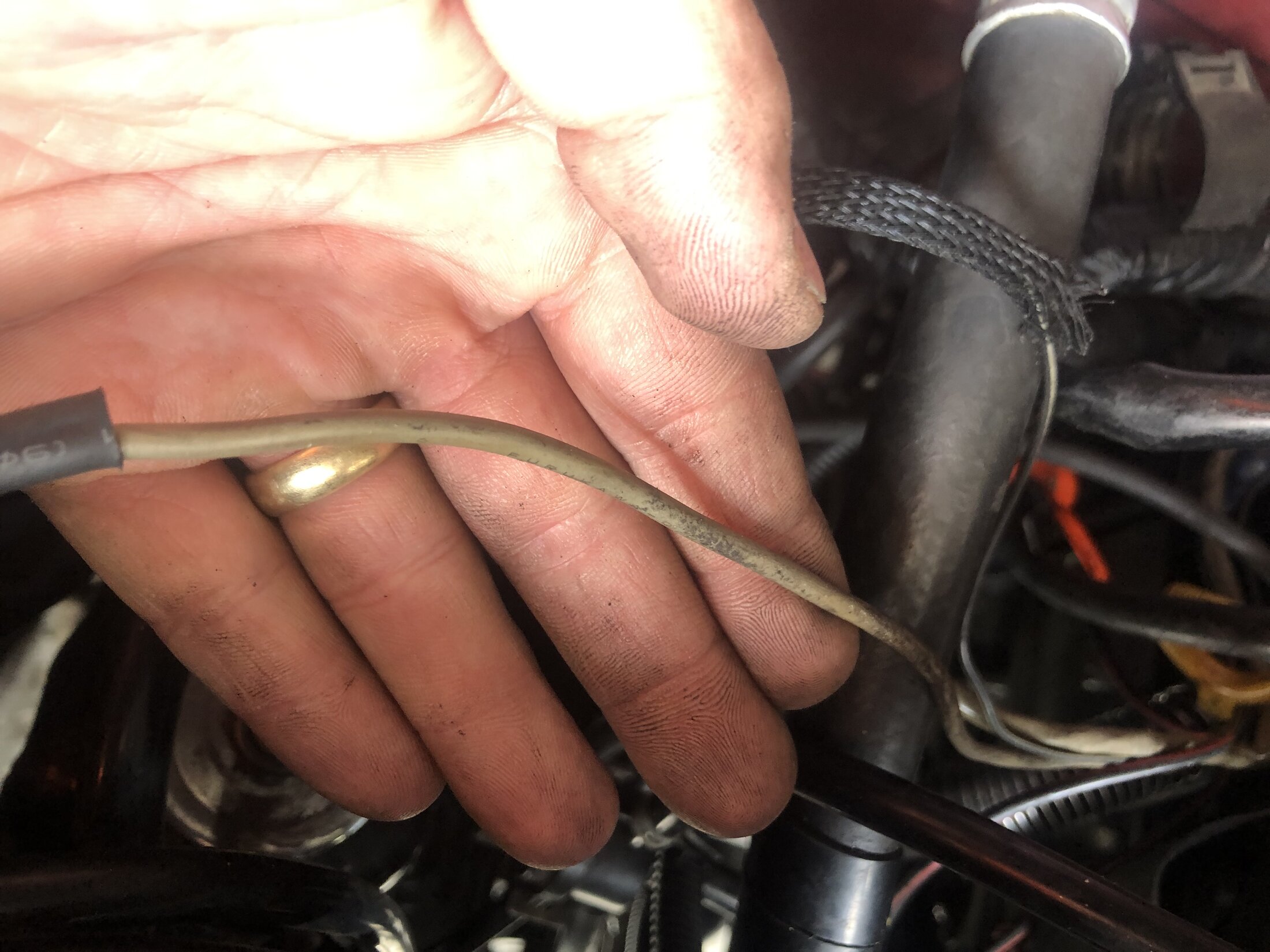

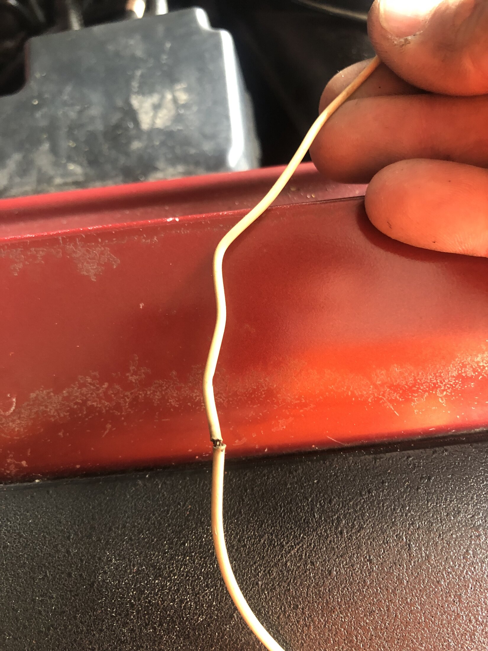

I chased the wire back to the first large Y. I’m seeing a shielded grey wire that used the shielding as the ground. No stripes present.

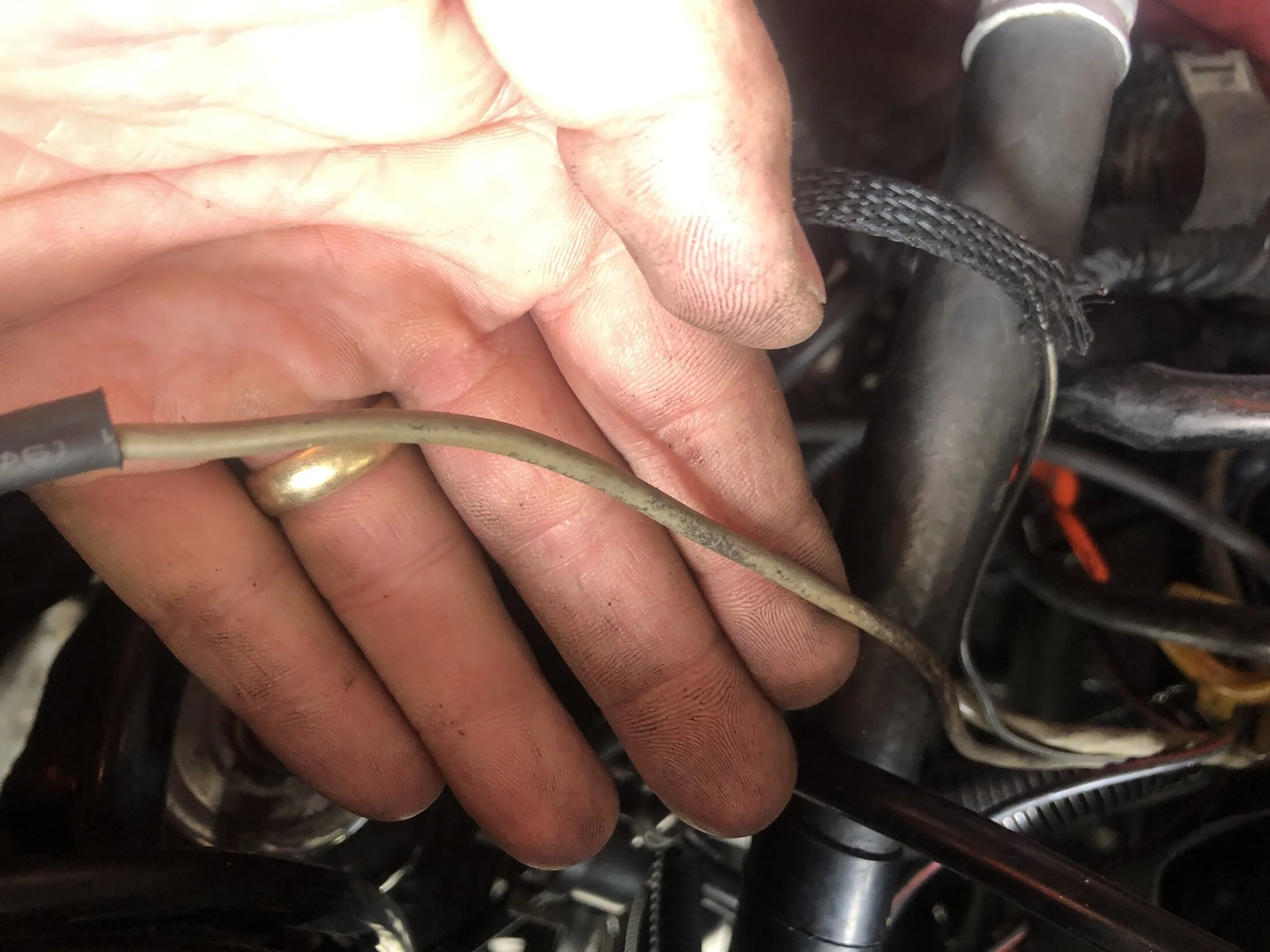

lets hit the PAUSE button here for a moment please
what model year is your engine bay wire harness ?
i will get the correct OEM paper print media EWD , so we can confirm and verify what we see here above
100% solid
so you have a
SOLID YELLOW

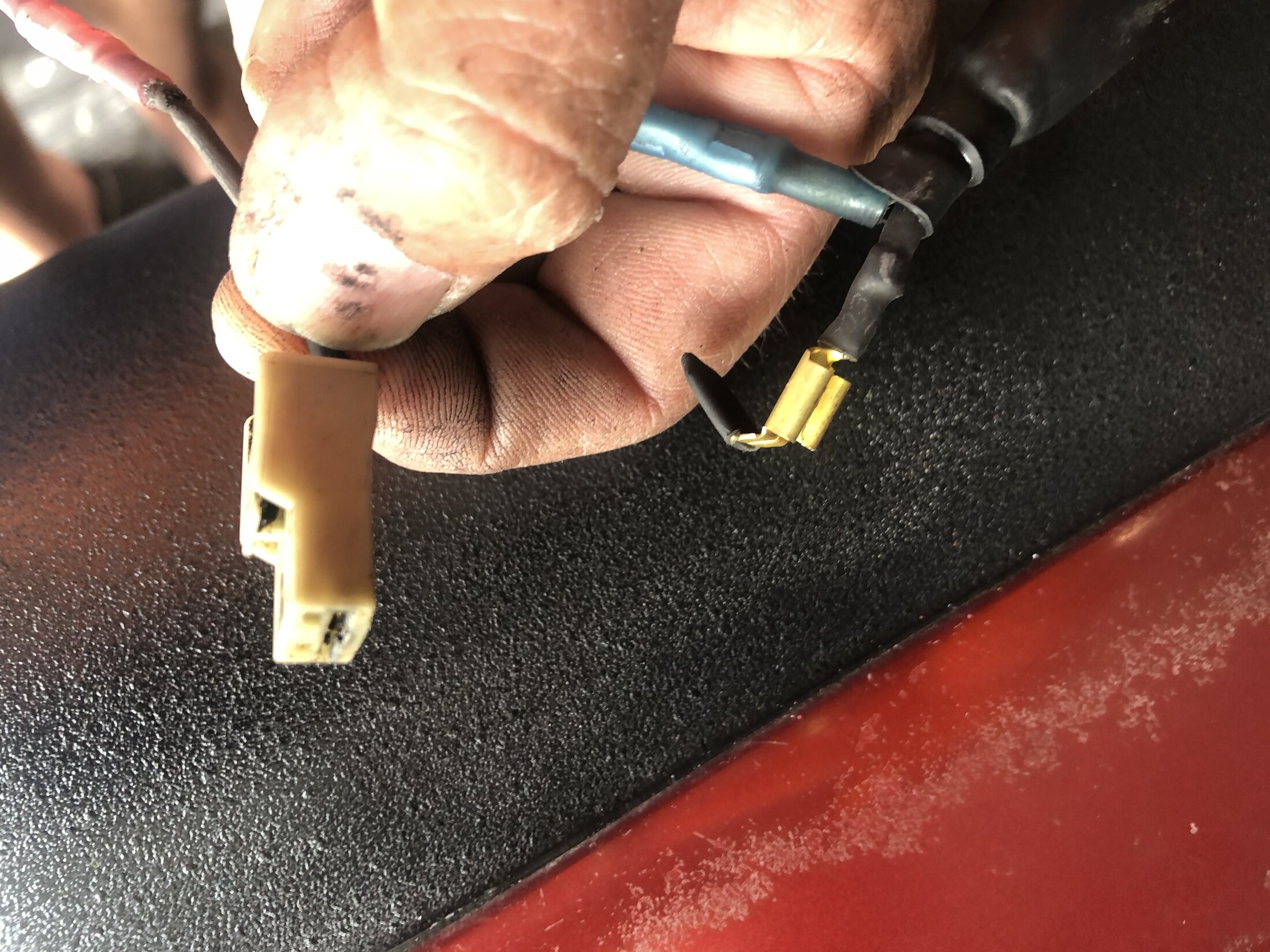

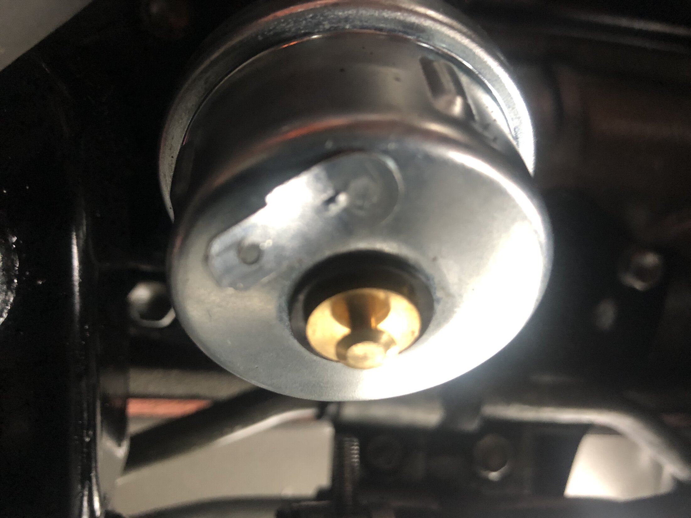

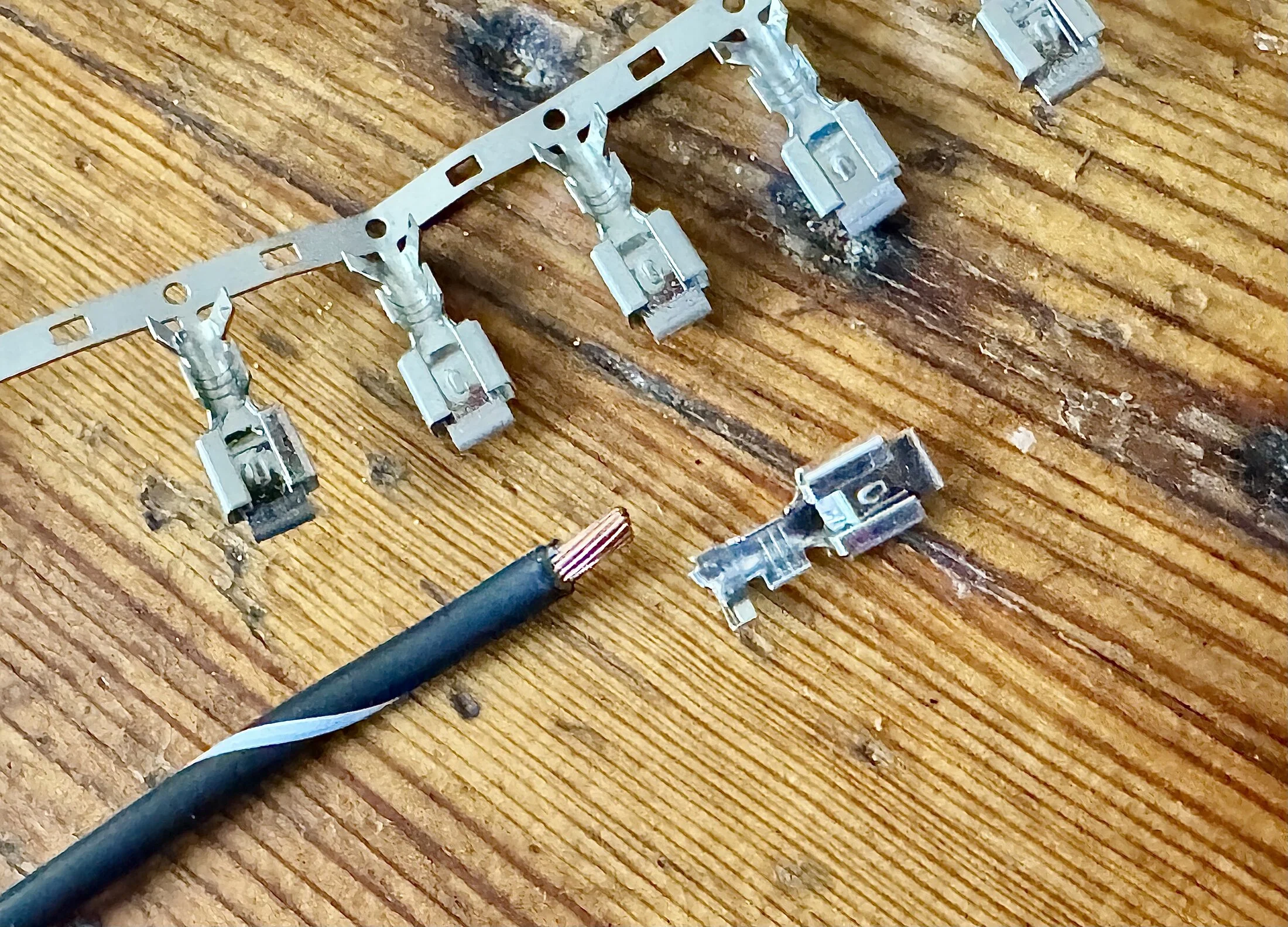

what color coded tracer stripe is the 2nd wire there in your hand , we are going to make certain confirm and verify is in-fact for the oil sender BELL as well ?

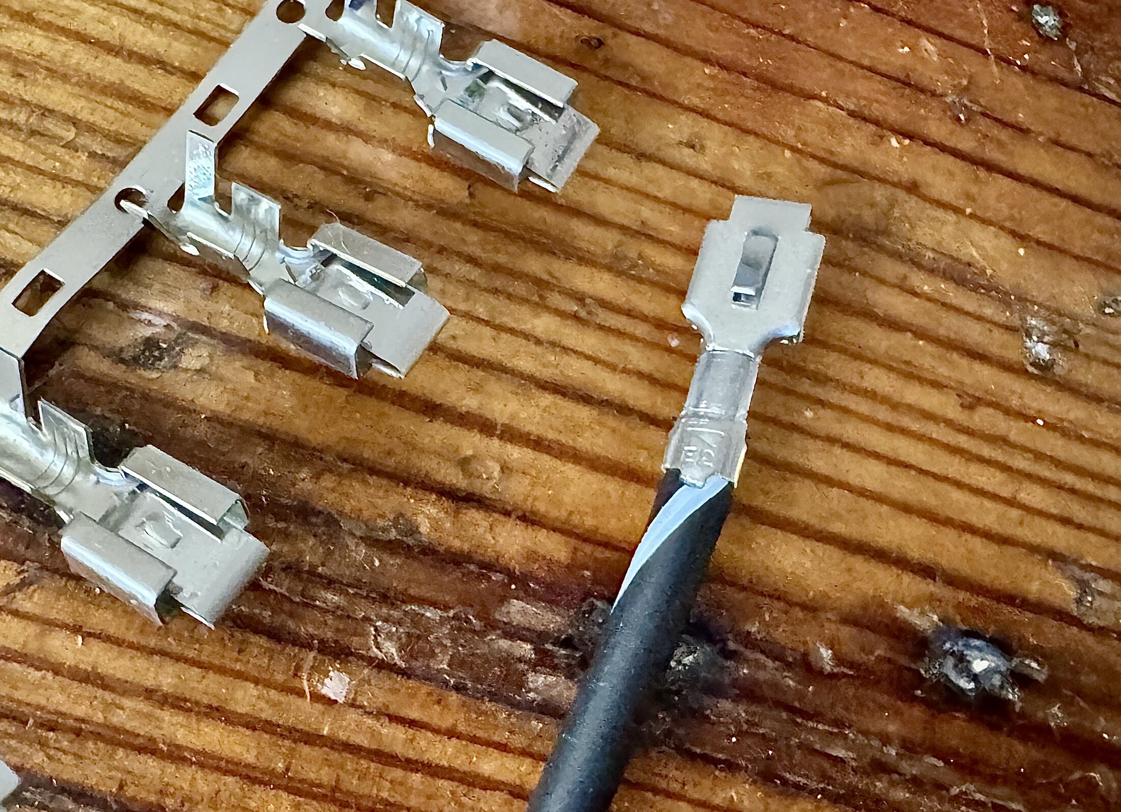

i now have as in my hands , from my most recent in-coming JAPAN parts stock order , this past Wednesday a new modern age 2025 OEM YAZAKI updated / upgraded special positive grip detent locking ball female terminal same in-kind you saw in my starter motor lift-off desk-top tech video .
the shape / profile has been tweaked a bit ,but the real CAT's MEOW MEOW here is the application of a unique metallurgy surface treatment i have only ever seen on OEM YAMAHA various MARINE Outboard Motor Electrical terminals .

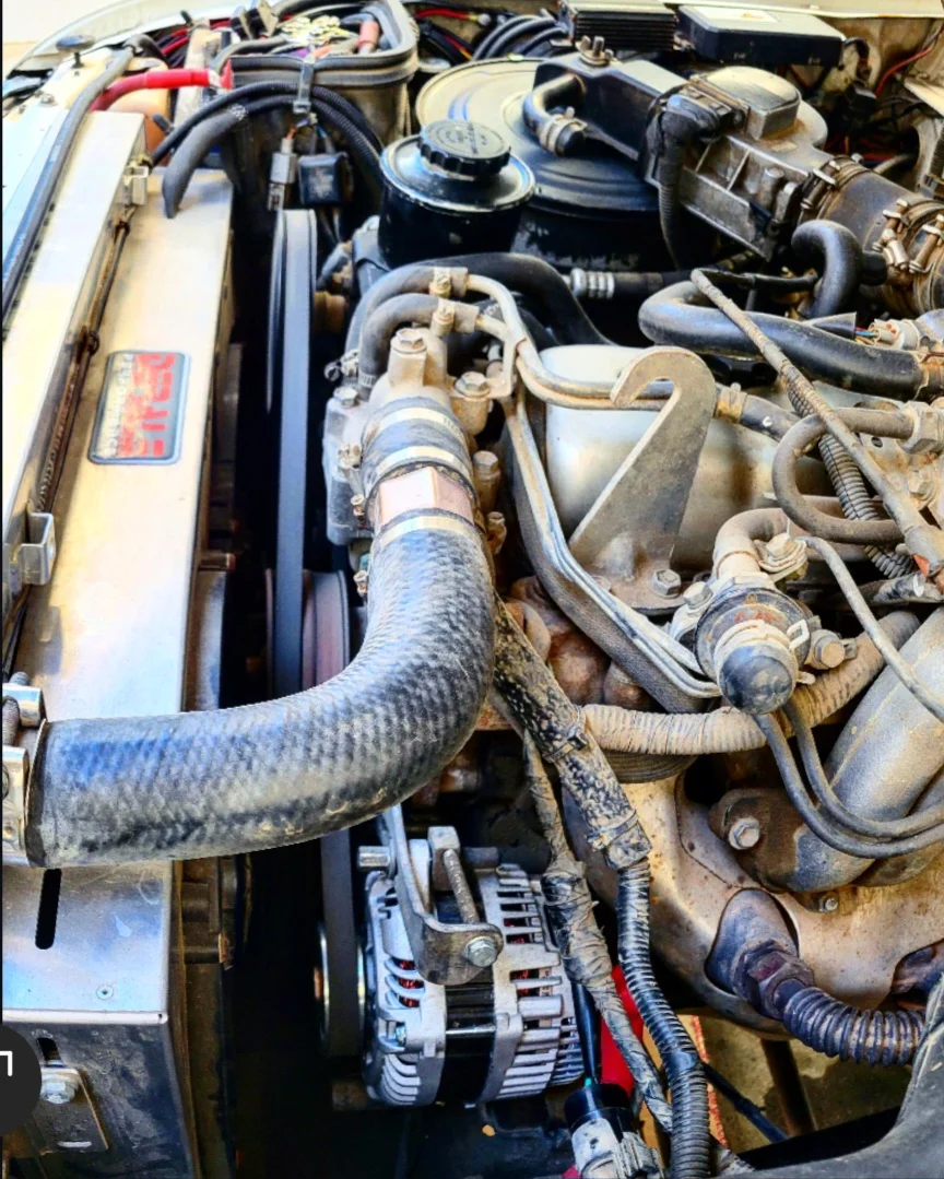

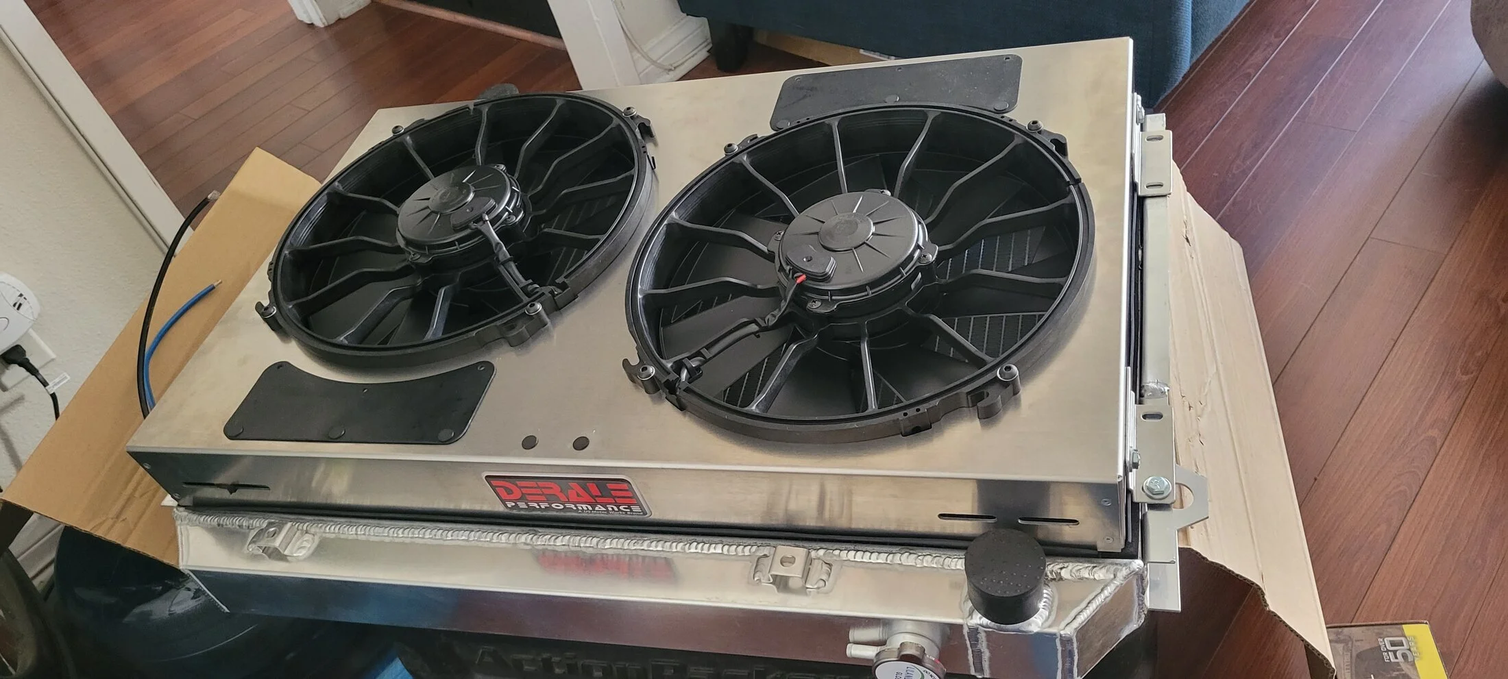

Marco what fans are you runnin? I picked up an aluminum rad and plan on switching to electric this summer…

What model derale is this for our 1991's? And how did you install that stereo? I want to put in a double din one but I'm not sure what I'll need.
There is no specific kit for the 3FE, you just need to make sure there are enough clearance for the fans and shroud. Converting to elec. fans is not something i would recommend for most ppl on here. The factory fan clutch with modified green hub works very well with factory cooling system and if you have factory radiator in place still, i would stick with the factory fan clutch. Upgrading to elec. fans open up a whole can of worms and require power upgrade, etc. as our 80 amp alternator will not support modern elec. fans load demand. The double din unit is an older alpine unit and installing these are pretty straight forward if you follow instructions. You will need to refer to the FSM for stereo wiring as i have done this many years ago and couldn't recall the procedures anymore, but it a 1-2 bananas job.

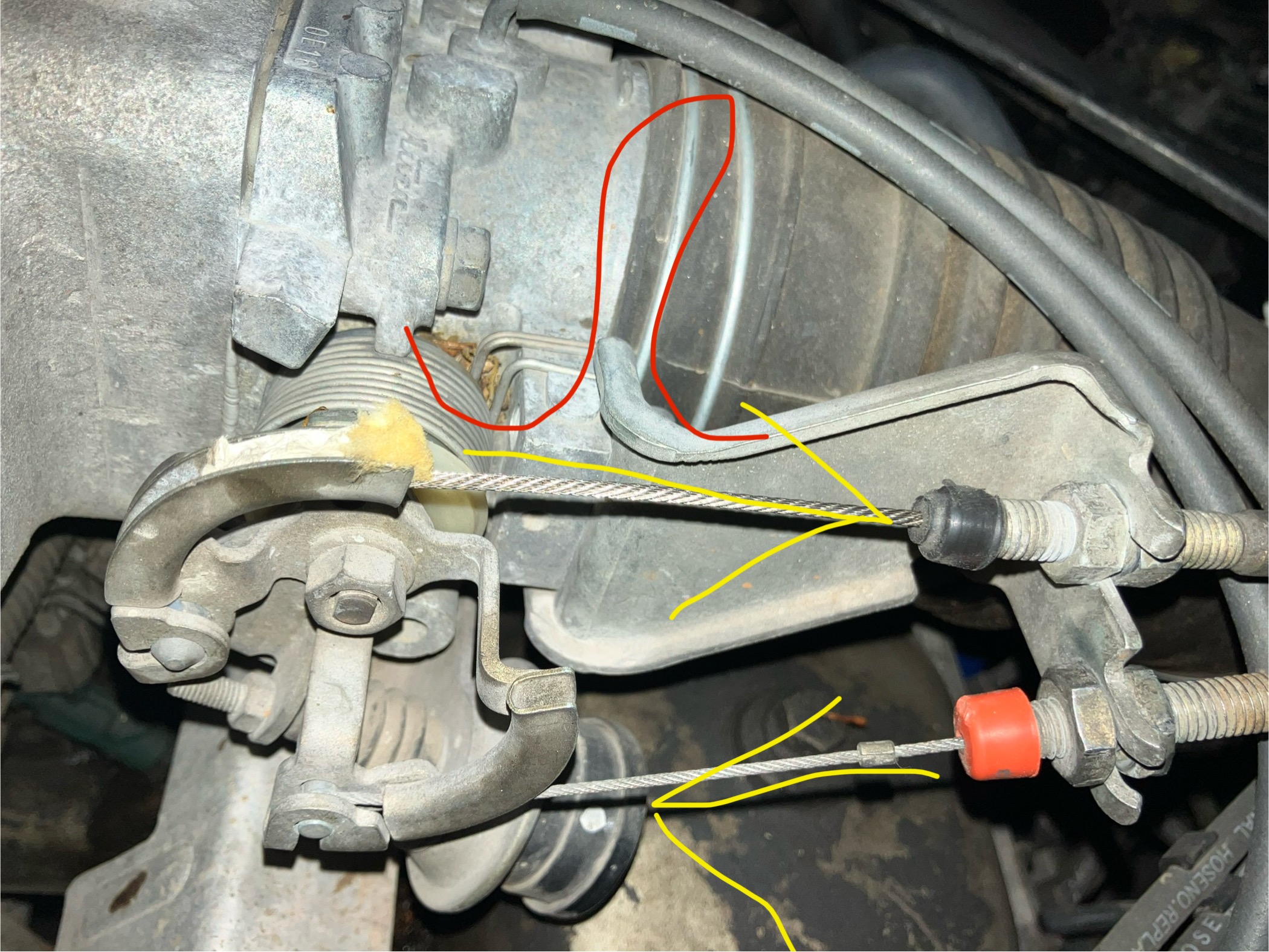

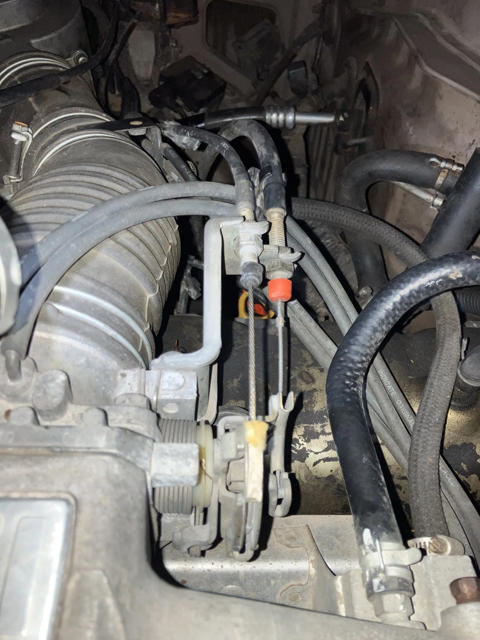

Anyone know where to source the accelerator cable and kickdown cable for a 1991 fj80 3FE ??? Have a ciggie shoved in it currently to compensate for slack. Will shift hard as hell otherwise. Need the part asap so I can drive her!!!!
