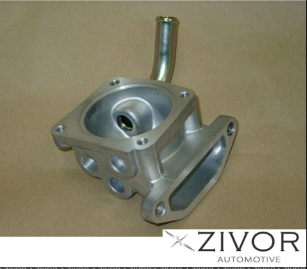

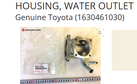

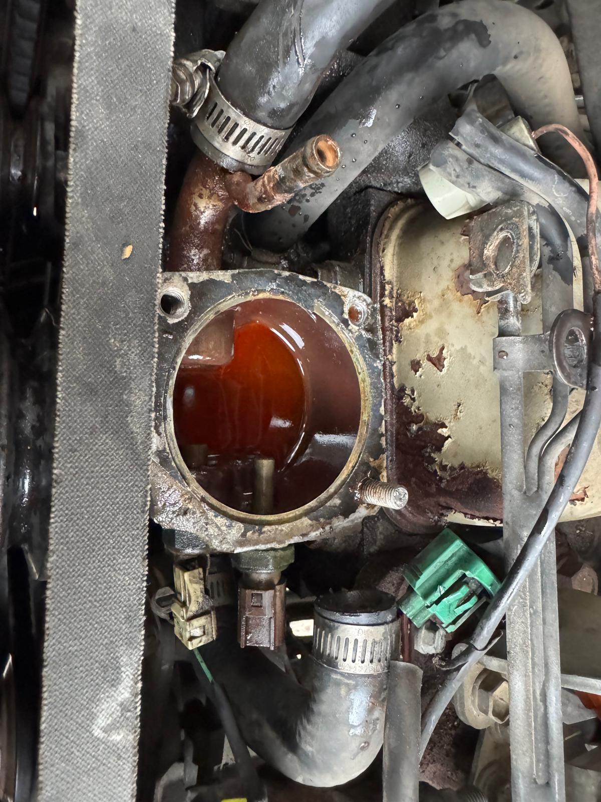

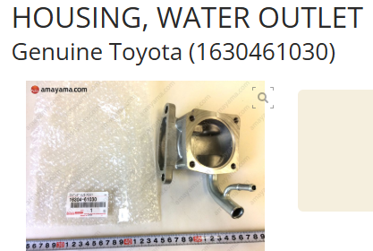

Hi! This is my first post on here and am not sure if this is the correct place to post but I am having some issues. (1992 FJ80 3-FE) My thermometer went out the other day and I attempted to fix it myself..... should be easy. I was prepared after reading other posts here that I should expect breaking a bolt or two, what happened next i did not expect.
If you are able to see, I did break a bolt, but also, a part of the lower housing completely broke off. I have now learned this is either called the lower housing or the water outlet. Alas I must replace this part. I am having a huge issue finding the part though. I already found out that I ordered the wrong thermostat, so I am being very careful with what I order.
Many diagrams show this is part number 16333, and it is mine since it has the double pipe coming off of it. This one on eBay is a similar part but it only has one pipe! Another listing shows this may infact actually be part 16304? Is the pipe coming off something that is interchangeable? Or does someone have a link/place where I can get a secondhand one?! Thanks guys

you can order a new housing from here
Also get the alternative stud kit from Matt
