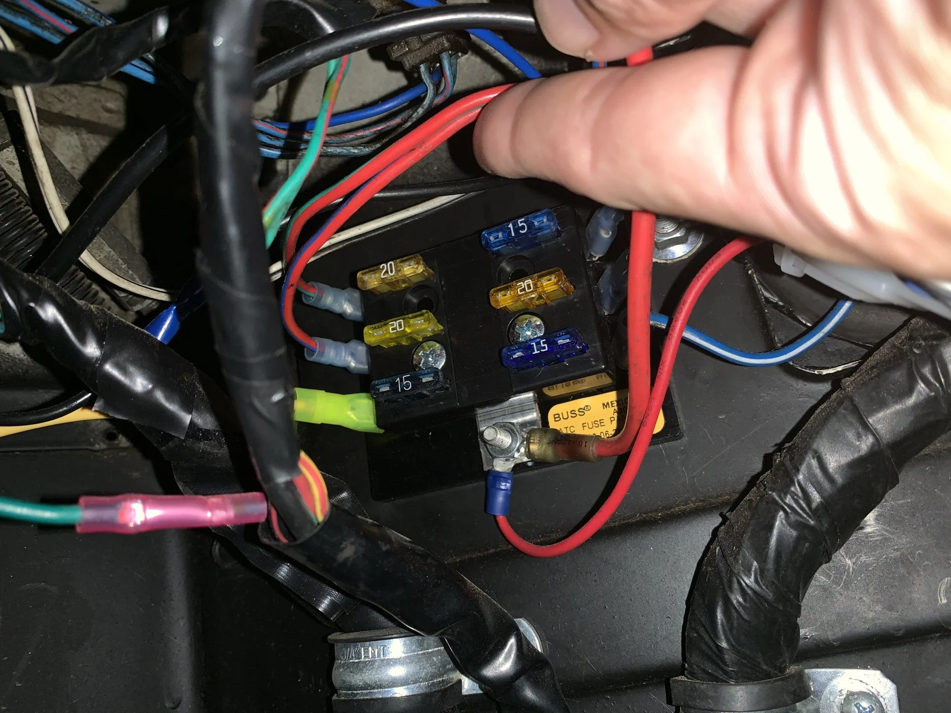

-I did not do the wiring
-I have an aftermarket, out of tank fuel pump
-new fuel filter

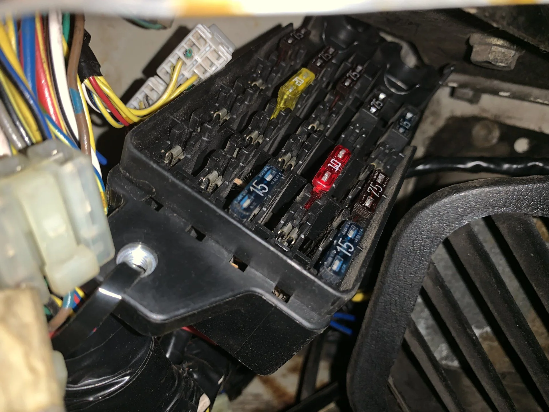

-the small fuses all look new
-all grounds that I can see are tight

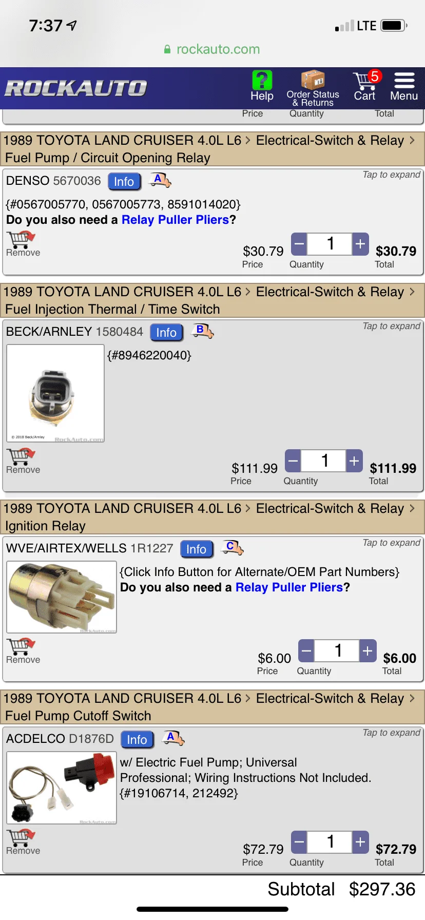

The EFI relay is discounted by Toyota, but I was going to use a Bosch like in this thread:
—-Any other parts I should carry/replace beside efi relay before I take off on a road trip again?—-

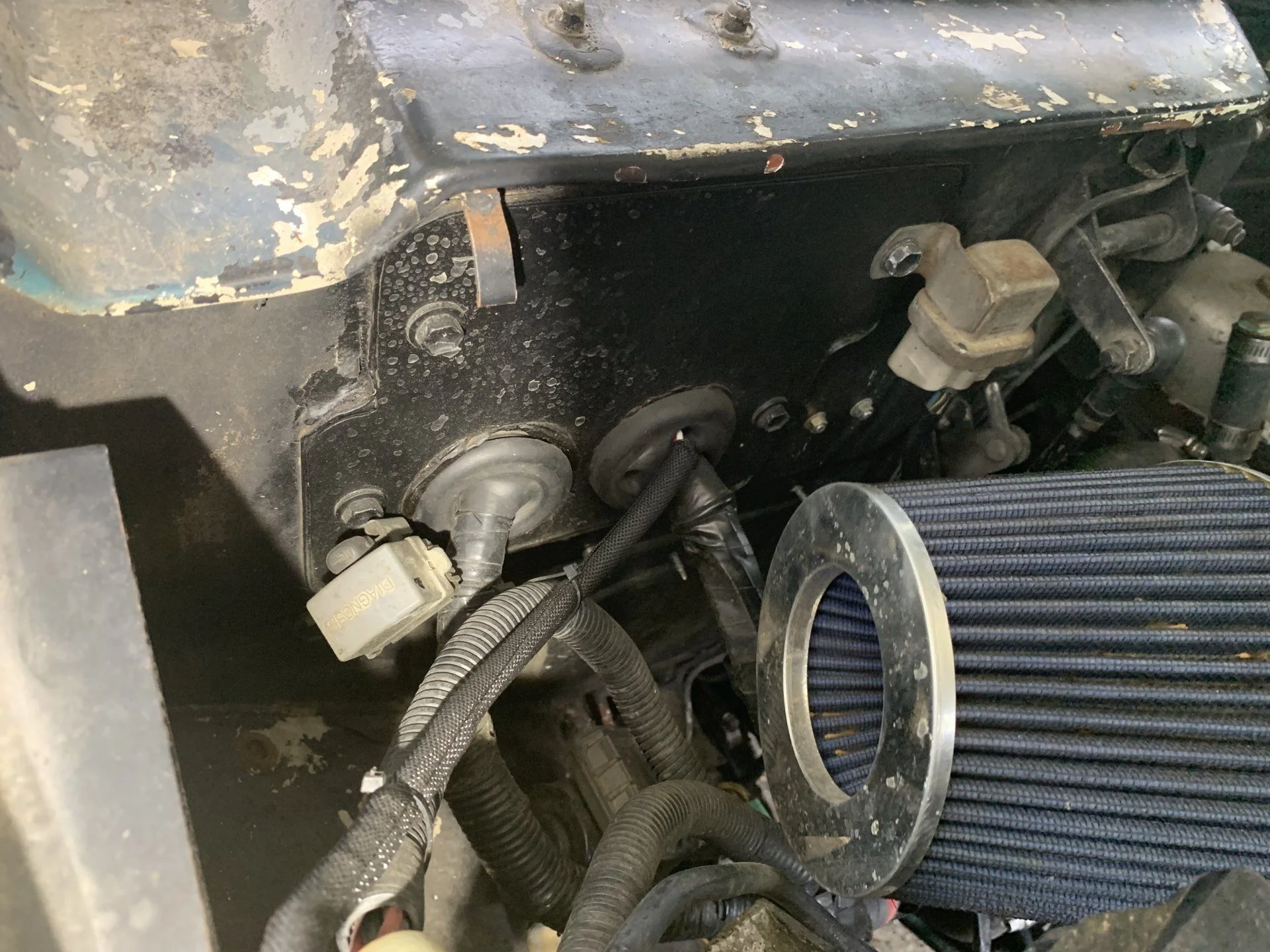

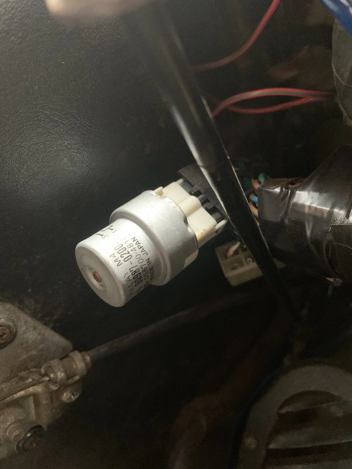

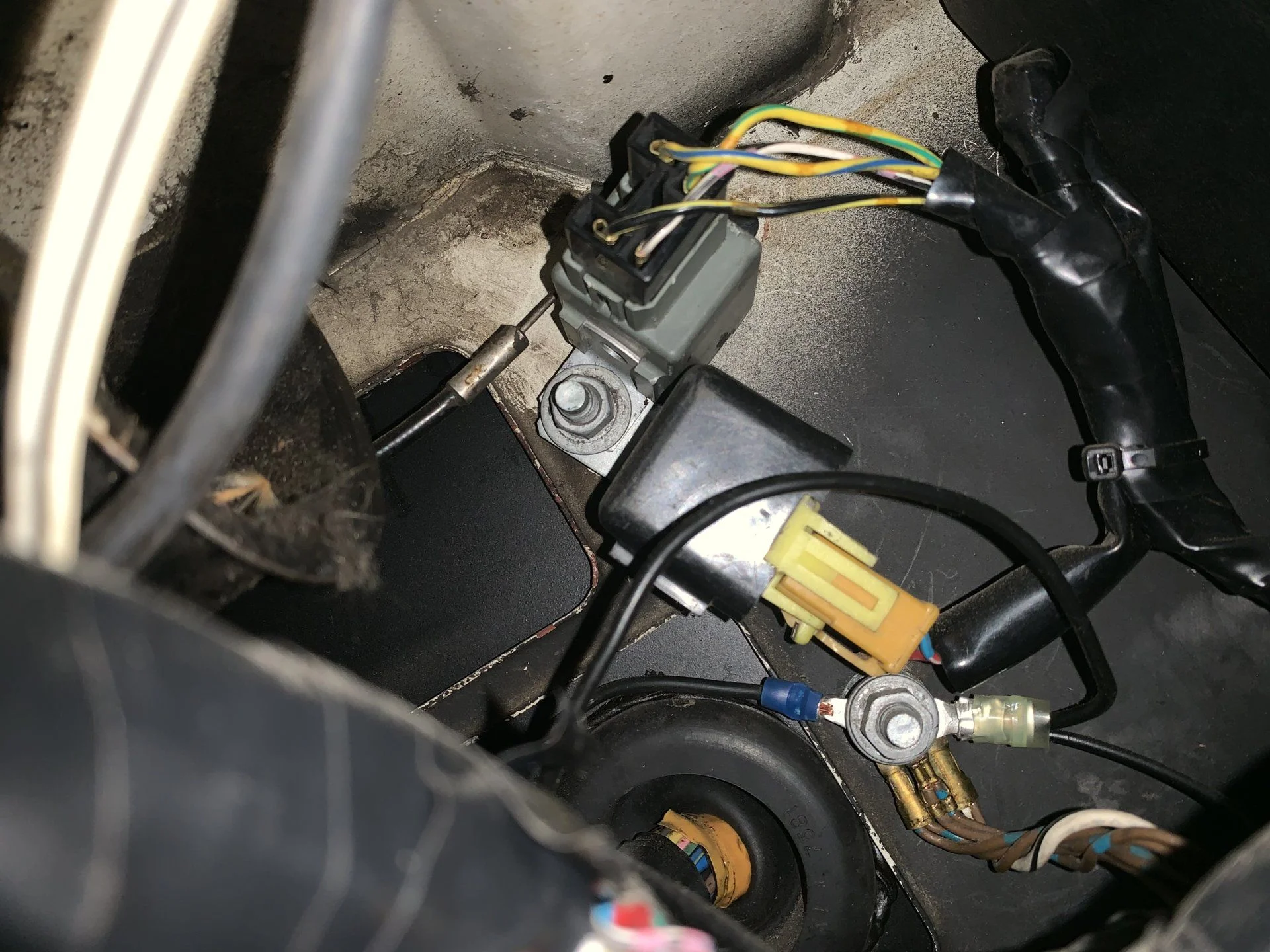

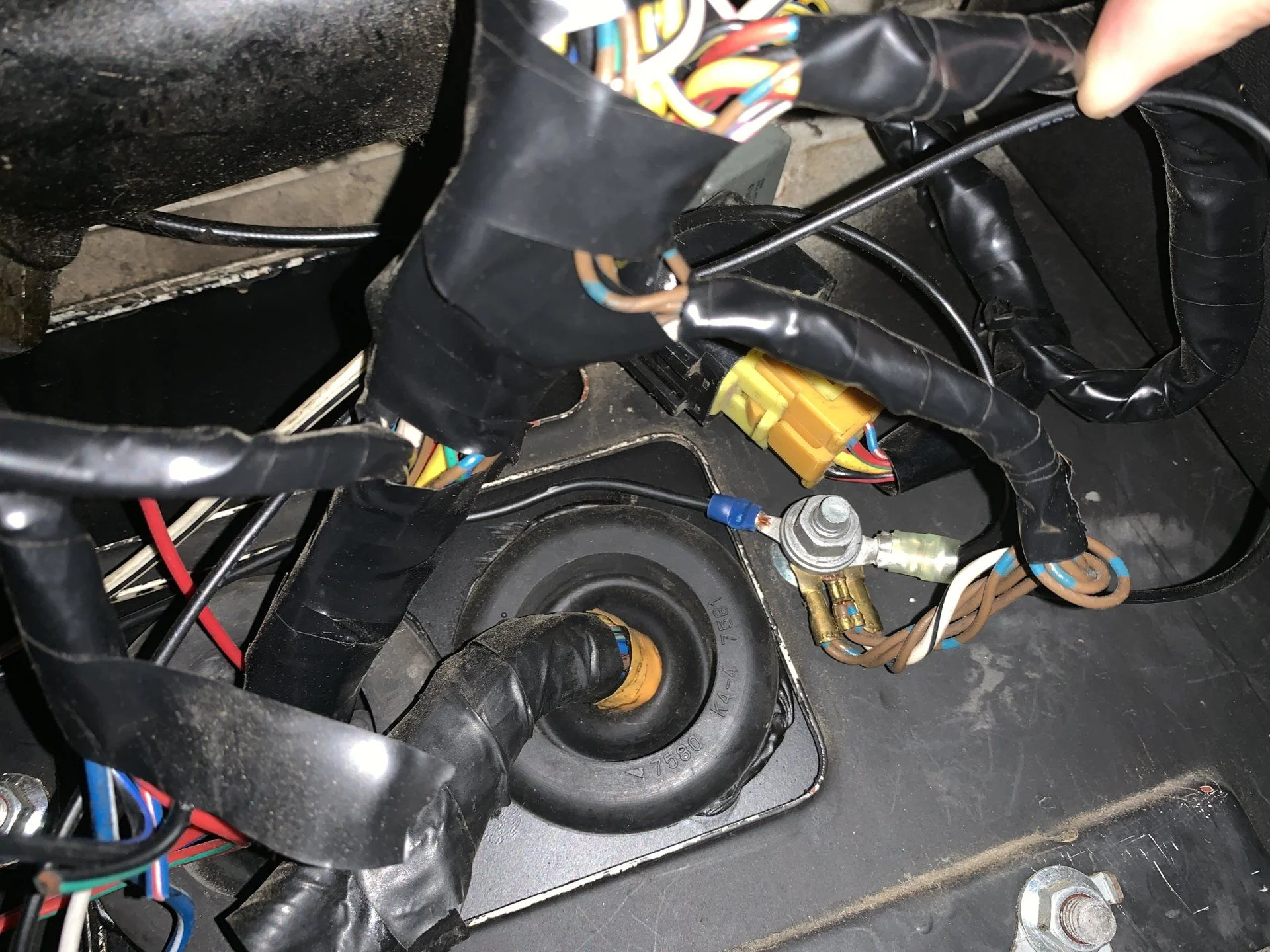

Have you tested the EFI relay yet? Relays are usually either good or bad but for whatever reason the EFI relays can be intermittently bad. Does it just have all the dash wiring and everything from a 62 in it?
Was the check engine light wired in with the swap. If the EFI relay is bad the CEL will not light.

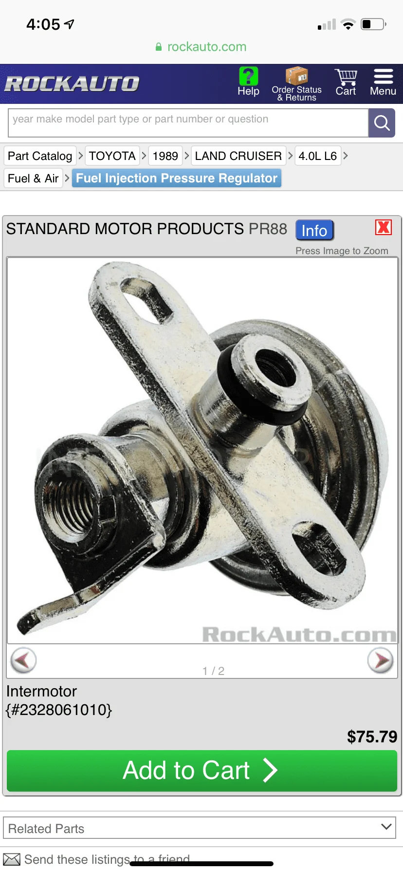

Intermittent issues like this may also be cause by a failing fuel pressure regulator (FPR), also discontinued by Toyota.
Did you change yours out?
This little guy?
