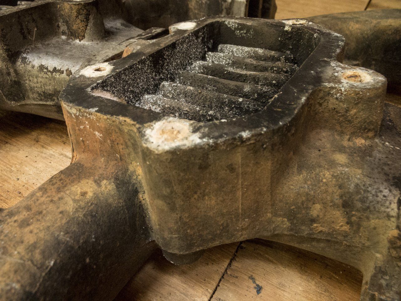

An unmolested intake. This is the underside and one corner needs to be ground down to eliminate the interference with the 3FE exhaust manifold. The white material in the holes is dirt dobber mud :hillbilly:.

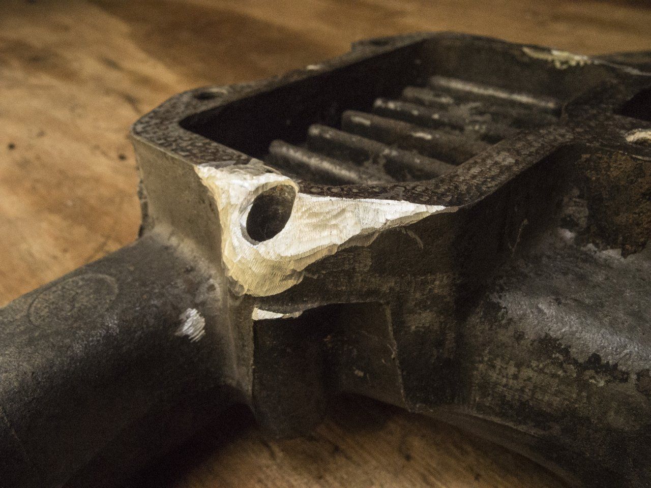

The is the manifold I've worked over and you can see the corner where material has been removed. A fair amount has be taken off.
Before actually mounting on the 2F I'm planning on dry mounting the manifolds on a head to check final clearances.
Godwin, looks like your more careful approach has left you with potential to use on a 2F manifold, maybe. I took off more material than that, but because I didn't feel like taking my time to clearance- just made a cut to be done with it. Good Work! I'm still on the fence about weather to take off the face of the exhaust flange, or to grind down the back of the where the bolt come up against. the face milling would net a cleaner look, but would be alot of material to take off and leave potential room for warpage...
