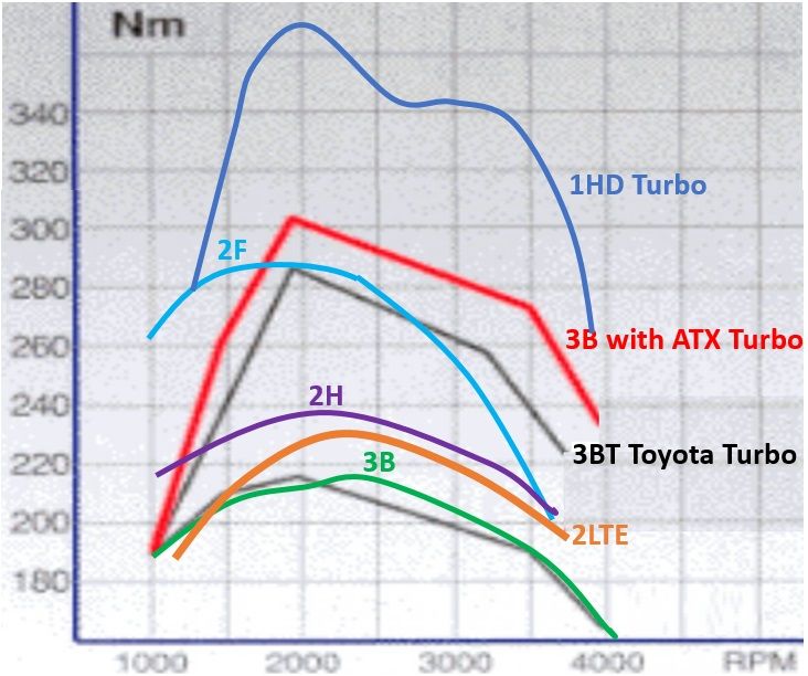

Let me give it a shot this weekend. But my 12MP camera phone probably has better resolution than thr scanner.
Please keep in mind that the actual size of these images on the SOR Catalog pages are the maybe 1.5"x1.5" at most.
I like data, so i might try to overlay them all.

Torque vs. RPM
Updated with 1HDT

You're taking this hijack very well.
Sorry guys... I did not mean to hijack.....just wanted to help with data because for me its very important for decision making on a turbo path....
Oh we appreciate the data, no problem at all. Once you've got it all it'd be great to dedicate a thread to it.
