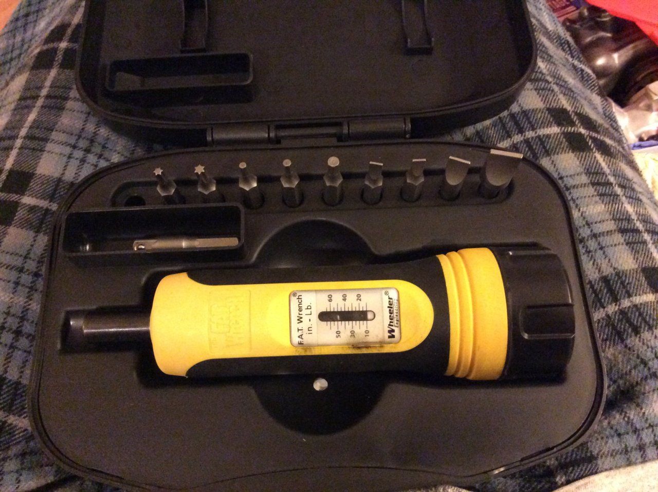

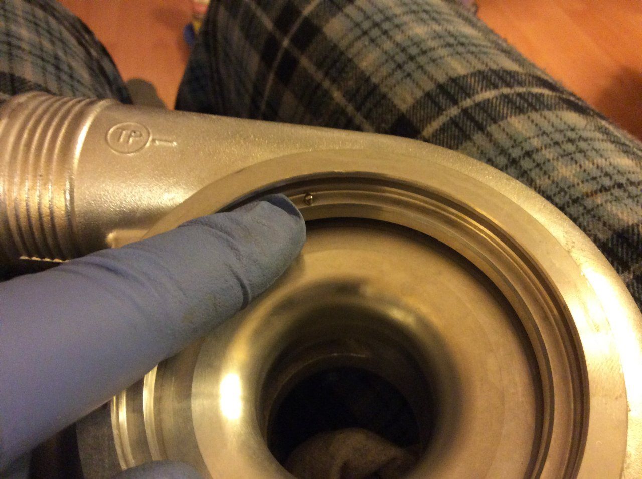

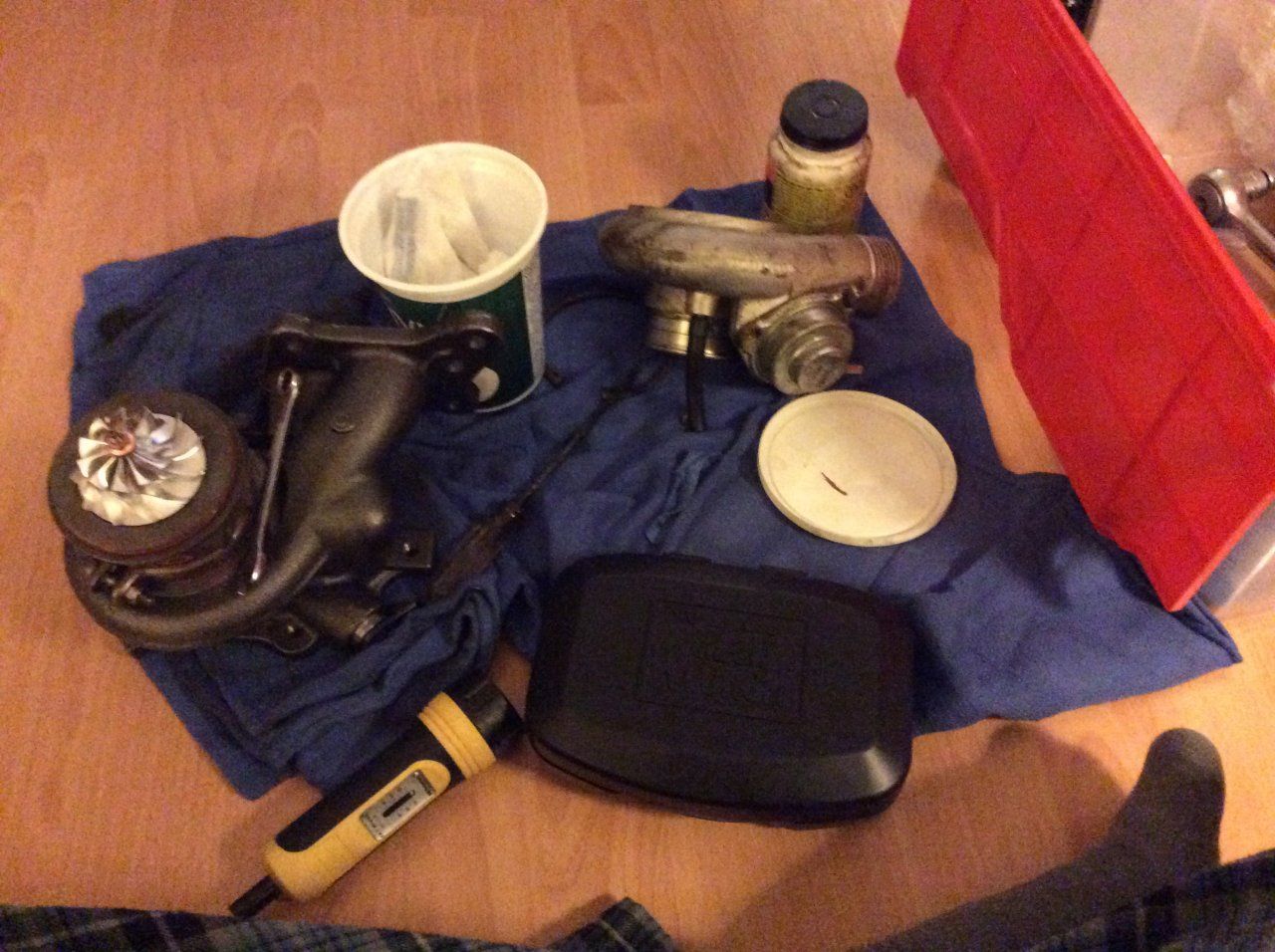

So bolted together the 11blade extended tip 13t with the 11blade turbine to swap over from the stock turbo while watching chronicles or narnia with the family. I've never like Turkish delight since reading that story. I know I said id test each one at at time but Im so slow with my projects as it is I had to cut the time down somewhere.
When I reassemble the compressor housing I always put a swipe of rtv silicon on the back flange where the o ring is as I've had minor boost leaks there before. I Also slather the turbine housing mating surfaces with copper never sieze to make it easier if I have to disassemble it later. In a few days I'll bolt it up and post a video for all to enjoy.
