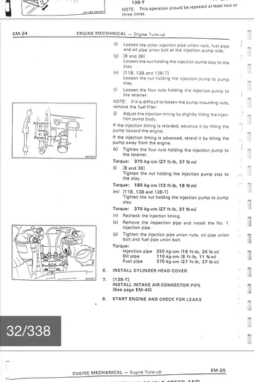

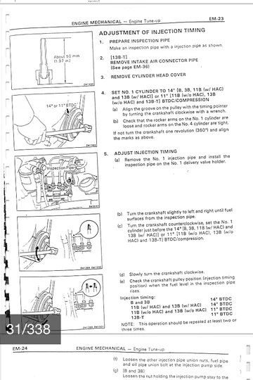

what your saying makes sense and is one of the ways i have heard to time these engines, i was going by the manual which seems different, these are the pages
see if this makes sense to you
yea thats the method with a straight pipe, and no pressure and is quite inaccurate. drip timing with the pump pressured up is much more reliable, and accurate to 0.5 degrees and better. you need a test pipe with a upside down "J" shape.
You follow the same basic procedure, but you wont have to eyeball the pipe to see if fuel is starting to come out. you just have watch for when the fuel stream turns to a drip. This is how we set up inline pumps on the bench, and you dont need to be so exact with the length of the test pipe. You can actually use the injection lines on the motor. Just remove from the injector side and place a clear cup under so you can see the stream/drip.
You can feed the pump with a small inline electric fuel pump. Bleed the air from the bleeder/outlet, and install a plug. rig up a little switch to turn the pump on/off when you need it. once you get set up, its a much better way of doing things, and you can set/change your timing with ease.
