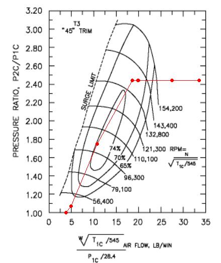

heres a map for a 50 trim and a 45 trim. Im right im between these.
I hardly ever rev past 3000rpm, so its a pretty decent match.
the dots are 1000, 1200, 1600, 2000, 2250, 2500, 3350 and 4000 rpm.
this is assuming A/F ratio of 20:1 and target power of 150HP.
An HX30 seems like a good match with the same goals.

The overall turbine flow (calculated from your specs) is about what I expect, but I think the wheel is a very old high trim design that won't be very efficient.
You're probably doing as well as you can with that turbo. Measure drive pressure if you get the chance, I suspect it'll be high for the boost produced.

With an efficient turbo that is well matched you'll be able to get drive pressure under boost at high load and low rpm. In worst case it should be about double boost.

The higher trim turbines are generally more efficient yes. This means they can extract more power from less drive pressure.
I was looking at a td04e 50trim turbine. Hybrid?
The 50 trim T3 looks to be a closer match for high efficiency in the mid range torque rpm...
For efficiency you really need to ditch the old series turbos altogether. The compressors might look okay, but your combined efficiency is compressor*turbine and I'm pretty sure those turbines are poo.
Outside the GT2052 that I've already sized and has many happy customers (who've paid me nothing btw) I'd recommend a TD04HL-19T. 16T/G would likely be fine too, but the 19T actually has more surge margin than most and with a 6cm turbine housing will do all you need.
