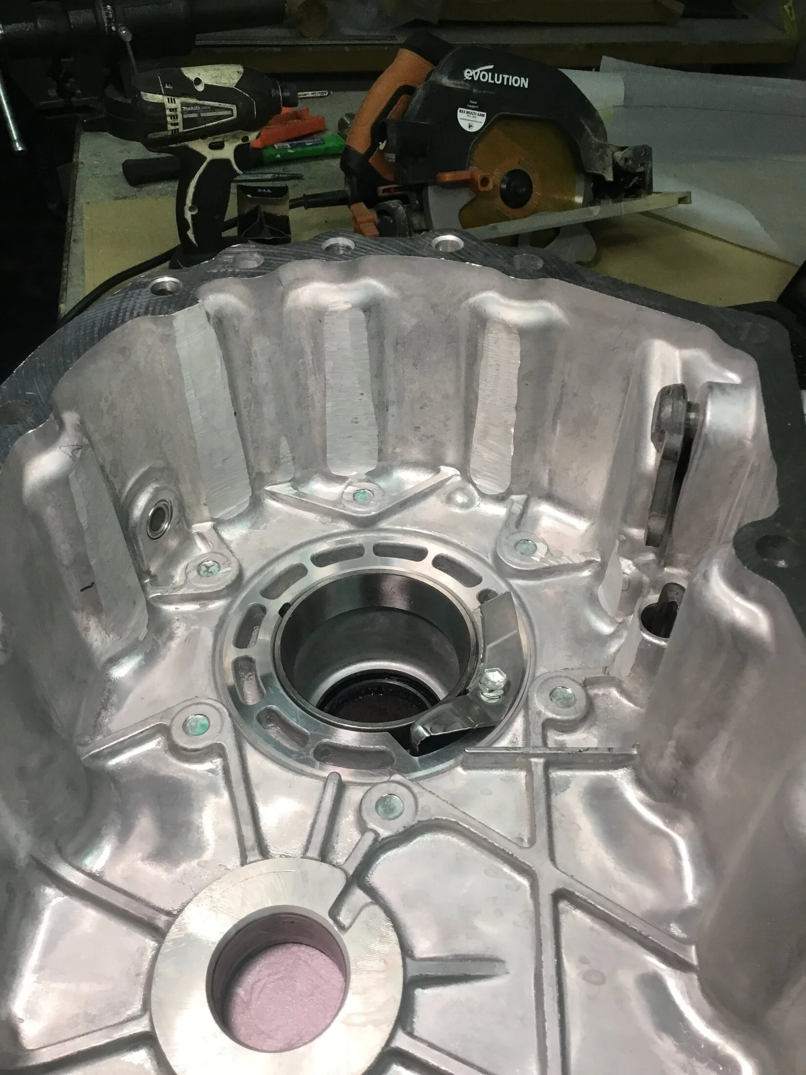

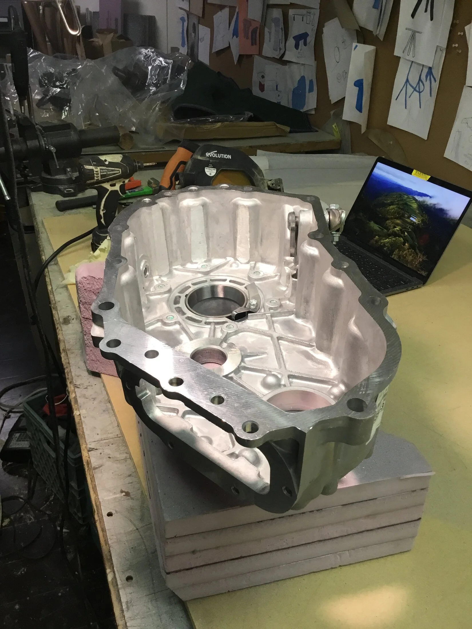

ok so for anyone interested in what i was interested in, here is a pic of my grinding for 3:1 low range gears in the split case.
did it with a s***ty ryobi grinder, in my office, sitting on a block of foam. took me 1:45hrs. no clearance is needed on the gear with 2 gears (hahaha good with the terminology) just need to do the part where the pressed on gear rides. Basically i would hold the gear cluster in place and it makes marks where its toughing, shave some off, do it again, shave it off... till it spins freely. boom, done. If your at all good with things of this nature then I would highly recommend doing it yourself. it was nothing at all. and no welding was necessary, still plenty thick as far as i can tell. this is what mine looked like. its in the car and kicks ass. not sure if its chill to crawl obstacles in 4th with 5 passengers and 500+ lbs of film equipment and camping gear, but i did, and it was great.
