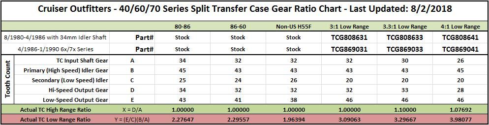

I have a bunch of numbers... if anybody likes numbers...
(let me know if you see any errors)
That is great.
Any chance you want to add the 3.1:1 & OE 2.2956 ratio too?
Actual tooth counts are shown here:
1916950
I want to do one that relates high range/low range axle gearing and tire size for the effective gear ratio as we've done for the 80 Series.
