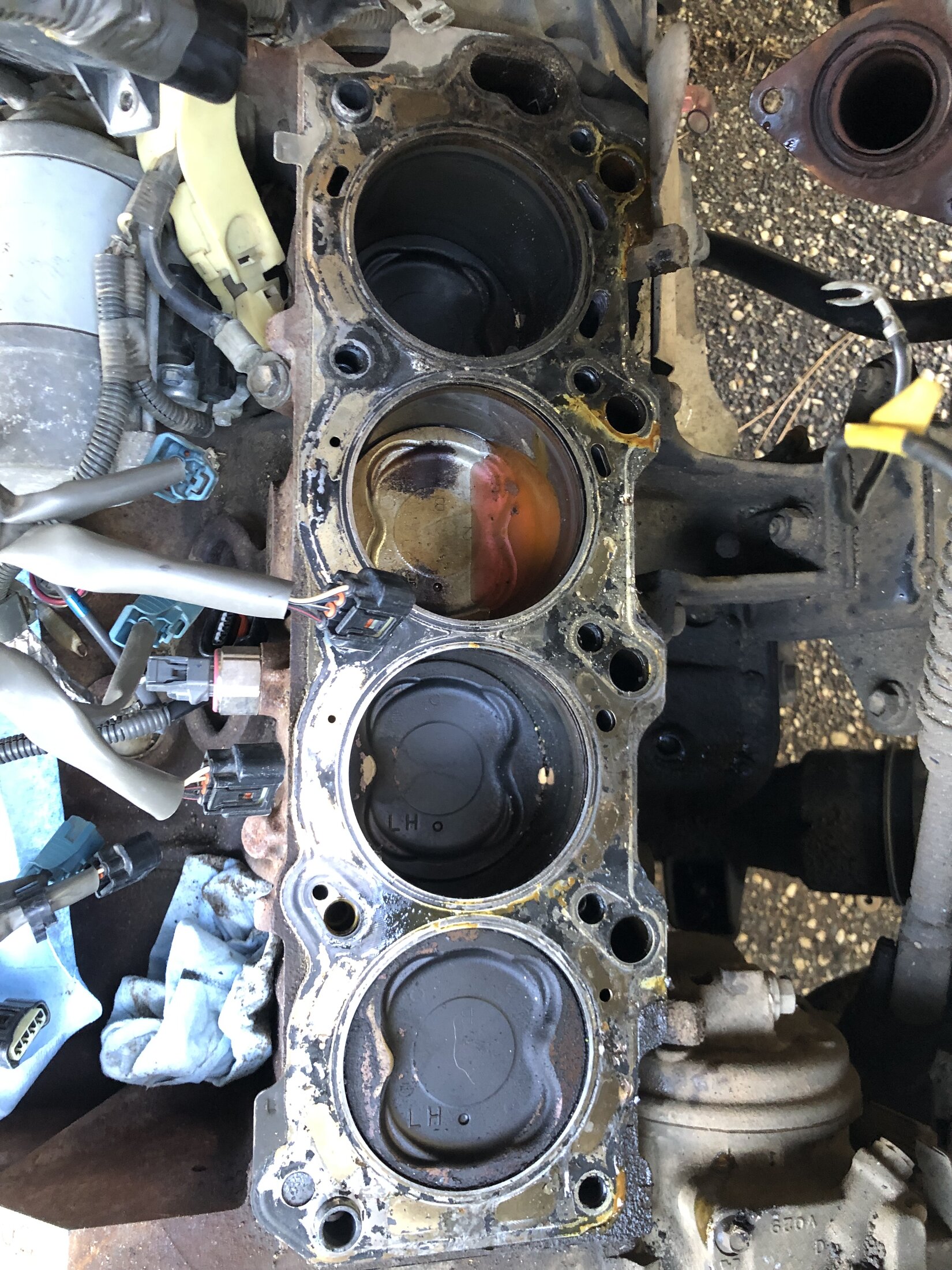

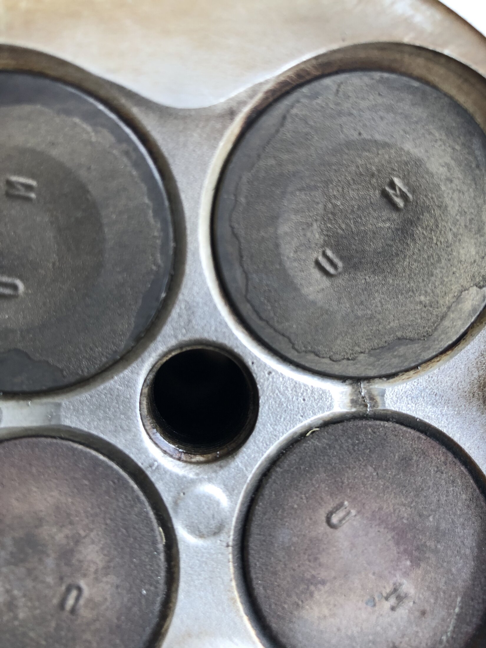

Mine was throwing misfire codes, primarily P0305, but others too (which I chased with plug swaps and injector swaps, etc.). Started blowing clouds of white smoke and running very rough, so concluded it was a head gasket. Pulled the heads and saw Gatorade in cylinder 5 and cracks in the head between the valves at cylinder 5.
Noise after I installed the new head.

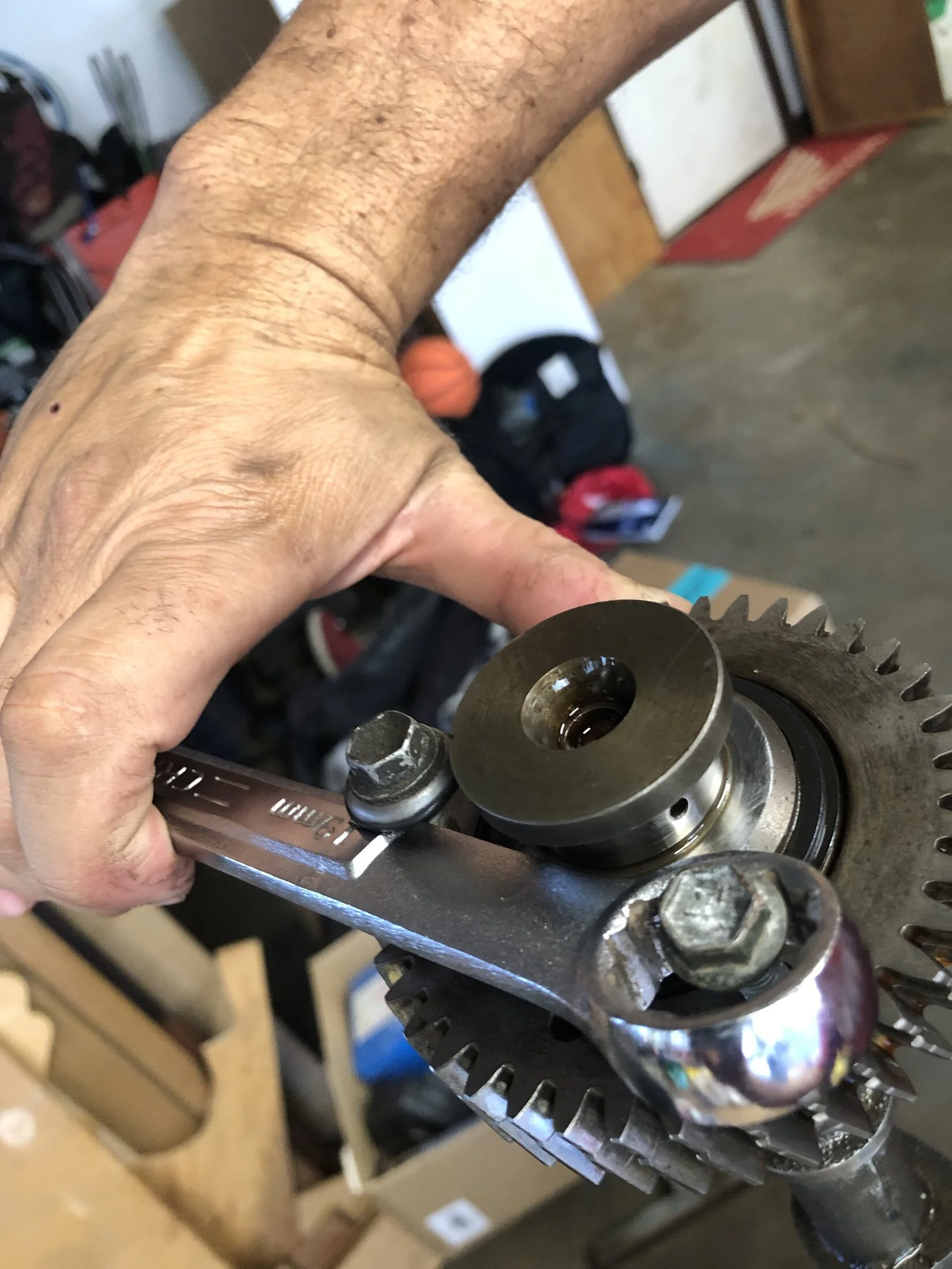

Ordered a refurb off ebay (TOYOTA/Lexus LANDCRUISER TUNDRA 4.7 DOHC CYLINDER HEAD 2UZ NON-VVTi driver 98-04 | eBay - https://www.ebay.com/itm/176559616231) and then experienced the clackety clack from the exhaust cam gear.
Pulled it apart again and clocked it. The clackety clack is gone.
Sorry to the OP for crowding your thread here, but @2001LC always has such detailed and great questions helping us get to the answers that I wanted to follow up. I've lurking on here for years, probly time to come out of the dark with my 2002 beater rig.
