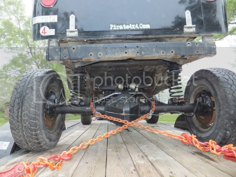

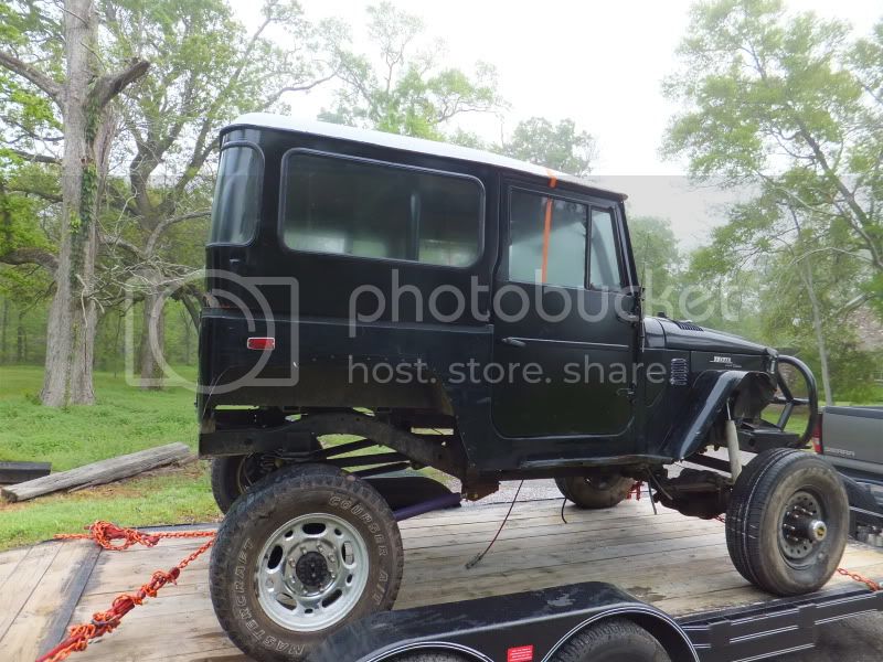

Picked up a new project, the FJ 40 from Hardline Crawlers forum:
FJ40 Land Cruiser (Tons/Linked/v8 etc) PLUS LOTS OF PARTS
Its a 73 frame with a aluminum tub, and cut front fenders. CUCV dana 60 front with 4.56 gears, Detroit locker, rear is a 14 Bolt 4.56 gears, gov't locker. Rear has been four linked with some stock TJ springs, Rusty's offroad joints and have the brackets and joints to link the front. Chevy TBI V-8 engine swap, that is for sale.
This will be a slow build, but the plans are to remove the Chevy motor, install the 2UZ from the wrecked Tundra, Inchworm prerunner adapter for the 2wd trans to mini truck T-case, and some properly sized tires to get it road worthy. Sliders, tube fenders, roll cage, and then link the front with some ORI struts to get it trail worthy.

Mounted the 40" Trepadors on the H2 wheels and did some clearance checks, all looks good so far. Unable to flex it to much with just a floor jack, but I know its going to be tall.:frown:
Also took one inch out of the 2 inch body lift, next is finish cleaning up the frame in prep for the engine swap.
