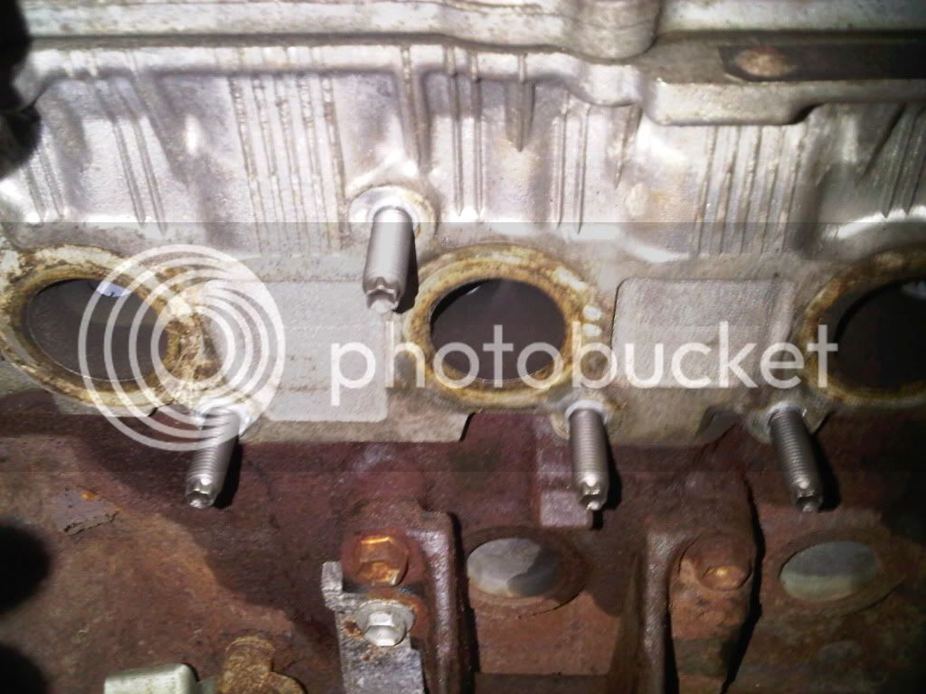

Well...I replaced the cracked passenger side manifold with the DT header. You need to be creative with your extensions, universal joints, sockets, etc. to get to some of the nuts/studs. The hardest part for me was getting to the lower front passenger side bolt/stud. All of my studs backed out so I was glad I purchased 16 new ones. I'll replace the drivers side this weekend. I'm gonna say I officially have 12 1/2 more hp with one DT header on! I'll let the pics speak for themselves:
New studs:
