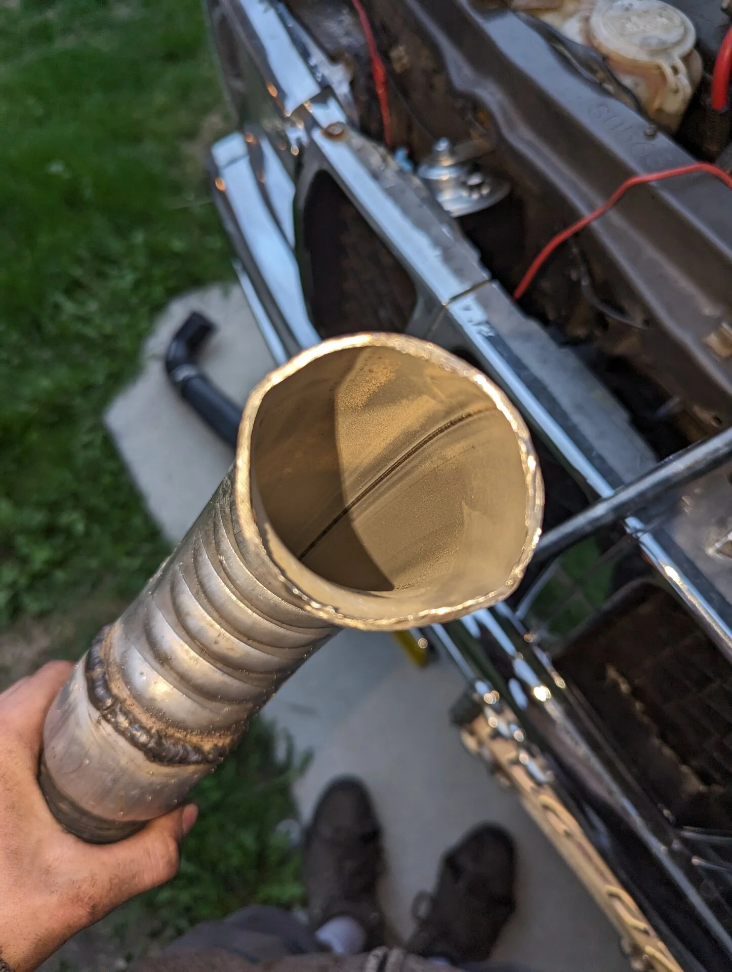

huh looks like that oil didn't make it far, the other side of the charge pipe is clean still. I guess I'll just keep and eye on oil consumption.
that amount of shaft play isnt out of the ordinary necessarily...... unless it is contacting the housing, the oil pressure centers it, you have to take out the whole center section to test properly for shaft play... or so ive heard
doesnt mean its not toast though, oil's is probably a bad sign,
you may need a oil restrictor in the feed
its ....well...UGLY AF but no, that wont do it
you can get mandrel bent 90 deg exhaust pieces from lordco or other auto parts stores and cut to work if your worried about it
What do you mean? Its excellent
