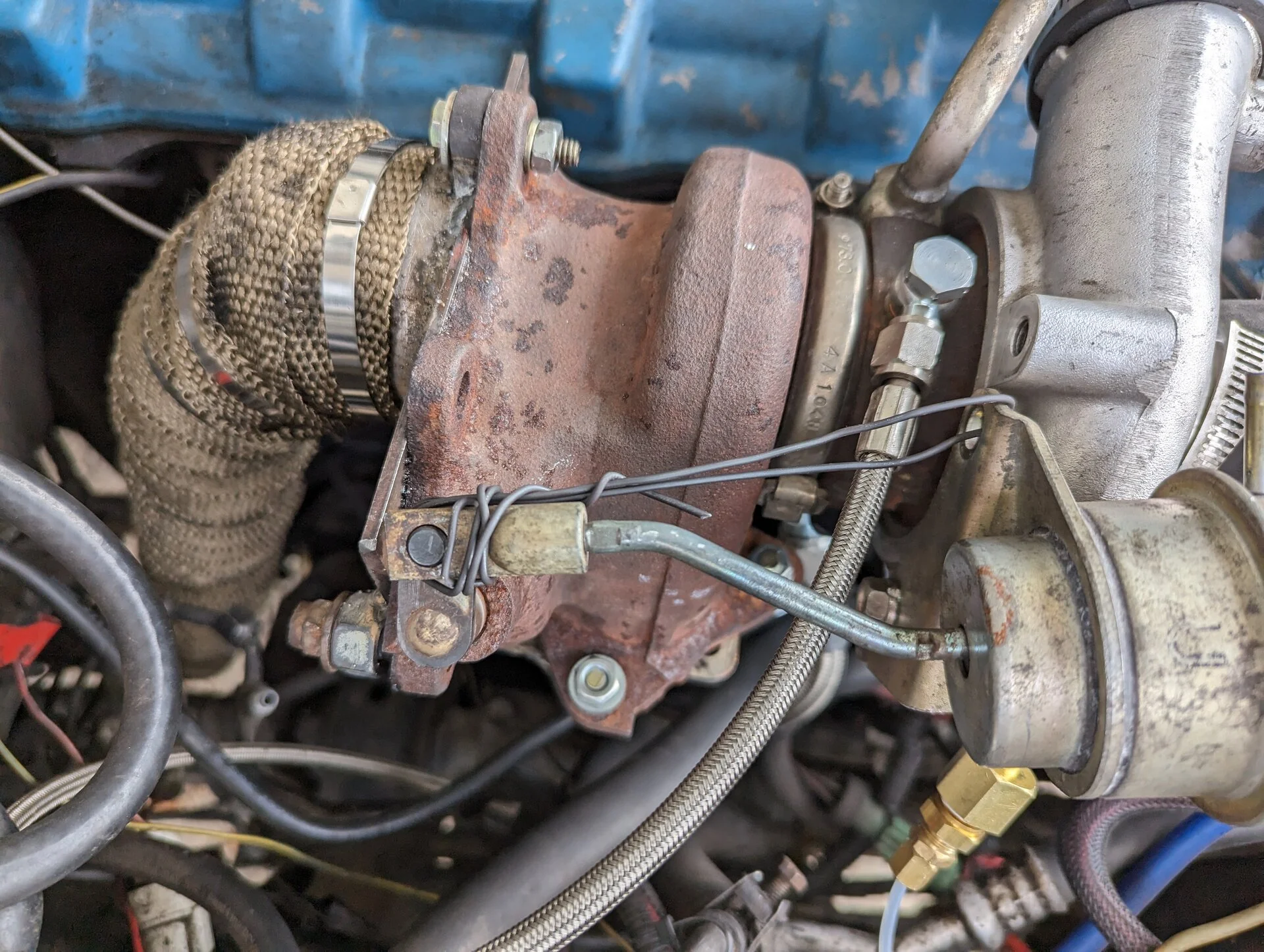

I just did this temporarily. It builds 1.5psi in 4th at 2000RPM just cruising up a slight hill. Not bad. All you hear though is the exhaust leak so I'll try to weld it once it stops raining later.

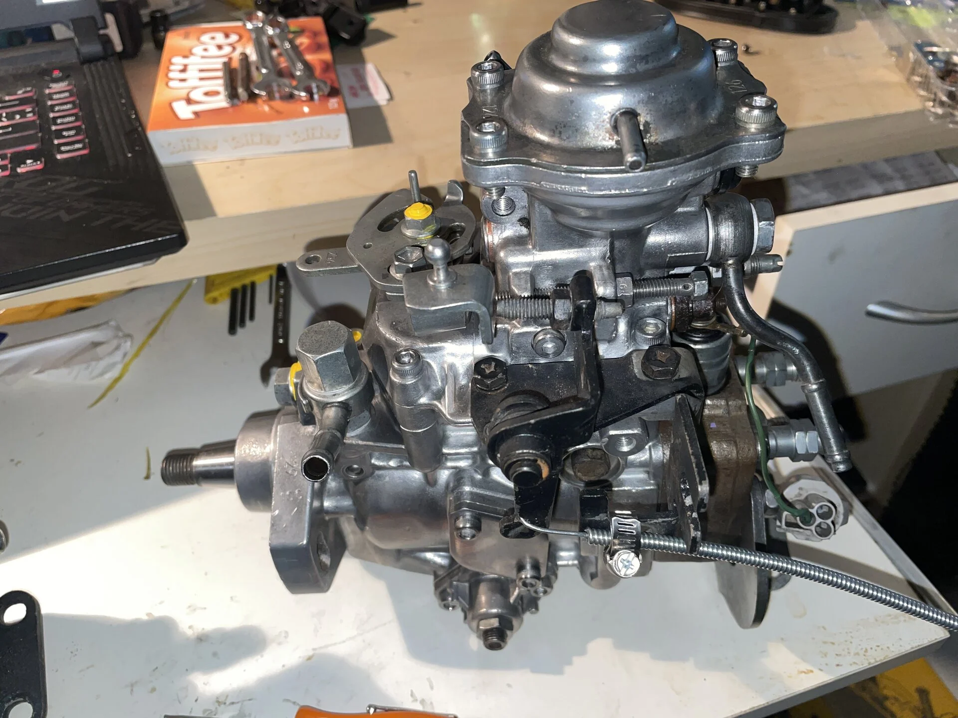

Your timing has to be too far advanced. Mine builds 2-3psi basically with any throttle input and builds 20psi on hard acceleration with EGTs peaking at 1200-1250F

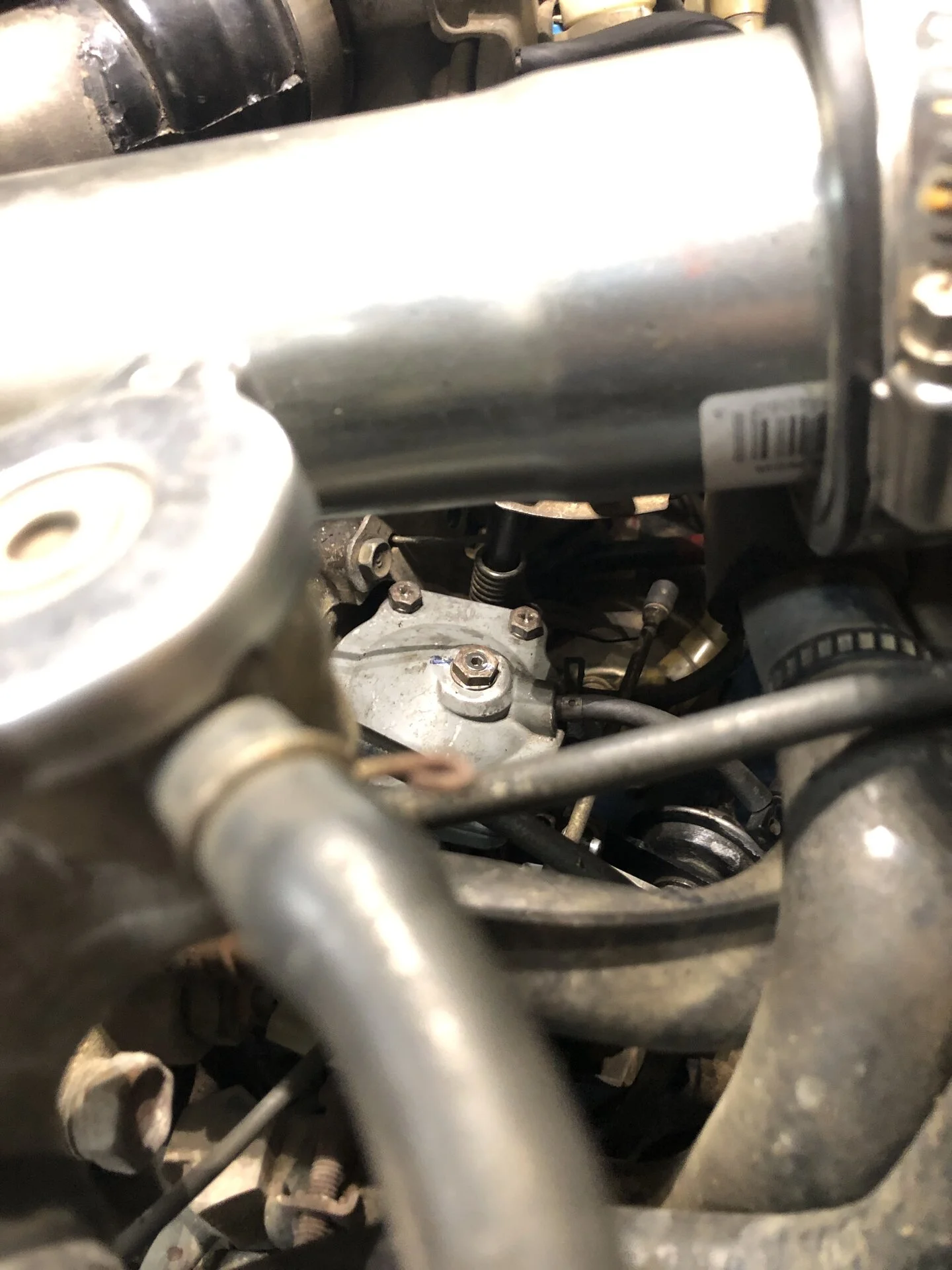

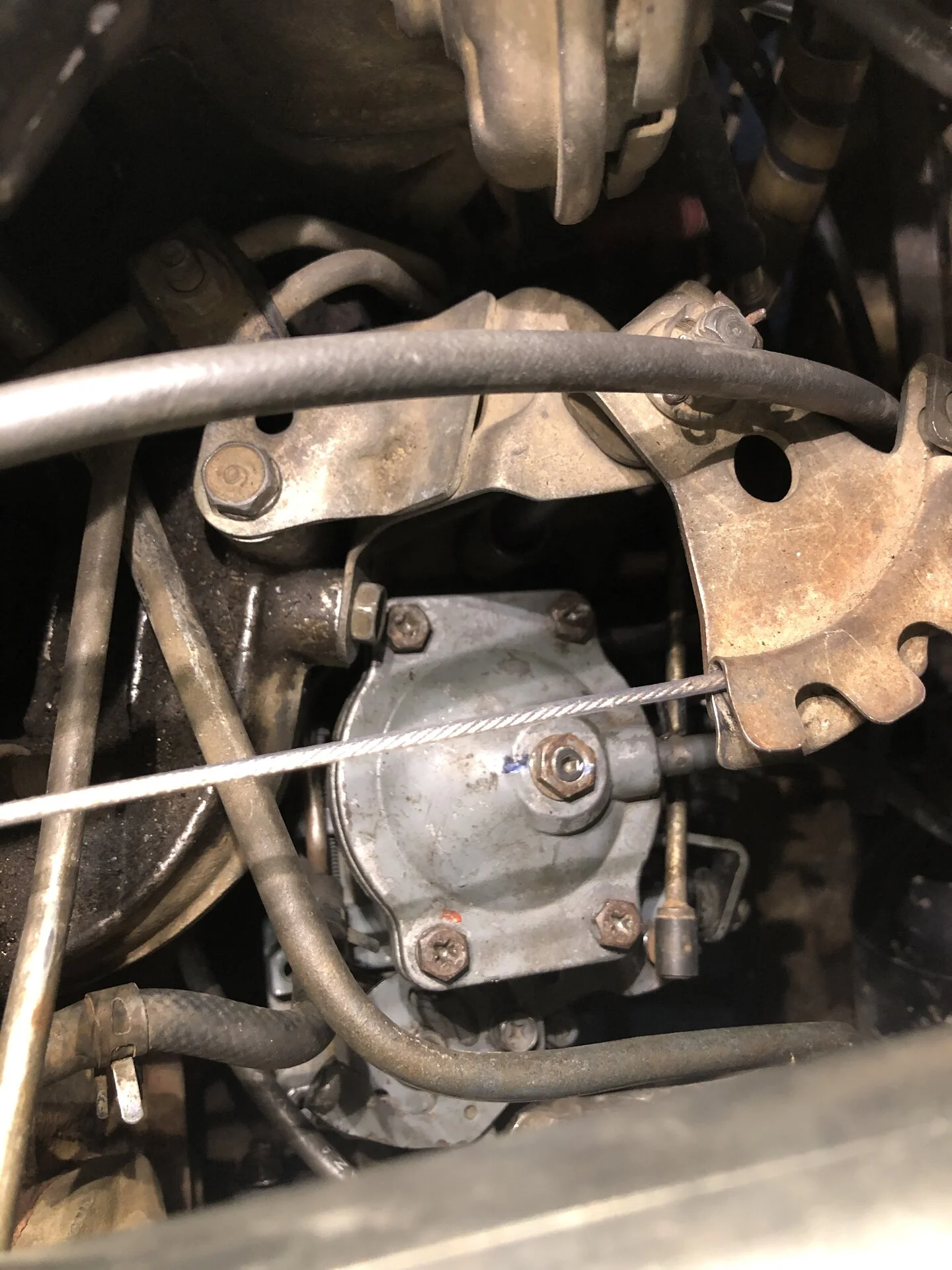

Oh 9kay that could be the case. My pump is pretty far tilted. What does your pump look like?
Yours looks to be a quite a bit more advanced than mine for sure.
I usually use the top left bolt(from this view) as a reference point to the bolt for the throttle. You can see what I mean in the second picture
View attachment 3424489View attachment 3424490Yours looks to be a quite a bit more advanced than mine for sure.
Thank you that is very helpful to get a baseline! Yeah wow my pump is way too advanced.

I have a bad spool leak though on the bottom of the turbo. Then again I don't have a gasket, ones coming in the mail, hopefully that'll solve that issue.

Well after tinkering with the timing a bit, it runs nice. Spools early, it doesn't build more then 3 psi unless I'm really pushing it, but I can get it to hit the wastegate at 10 psi. Normal driving I see around 1-3 psi. I still have a bit of a spool leak so I've been driving with the windows down until I can get a gasket in.

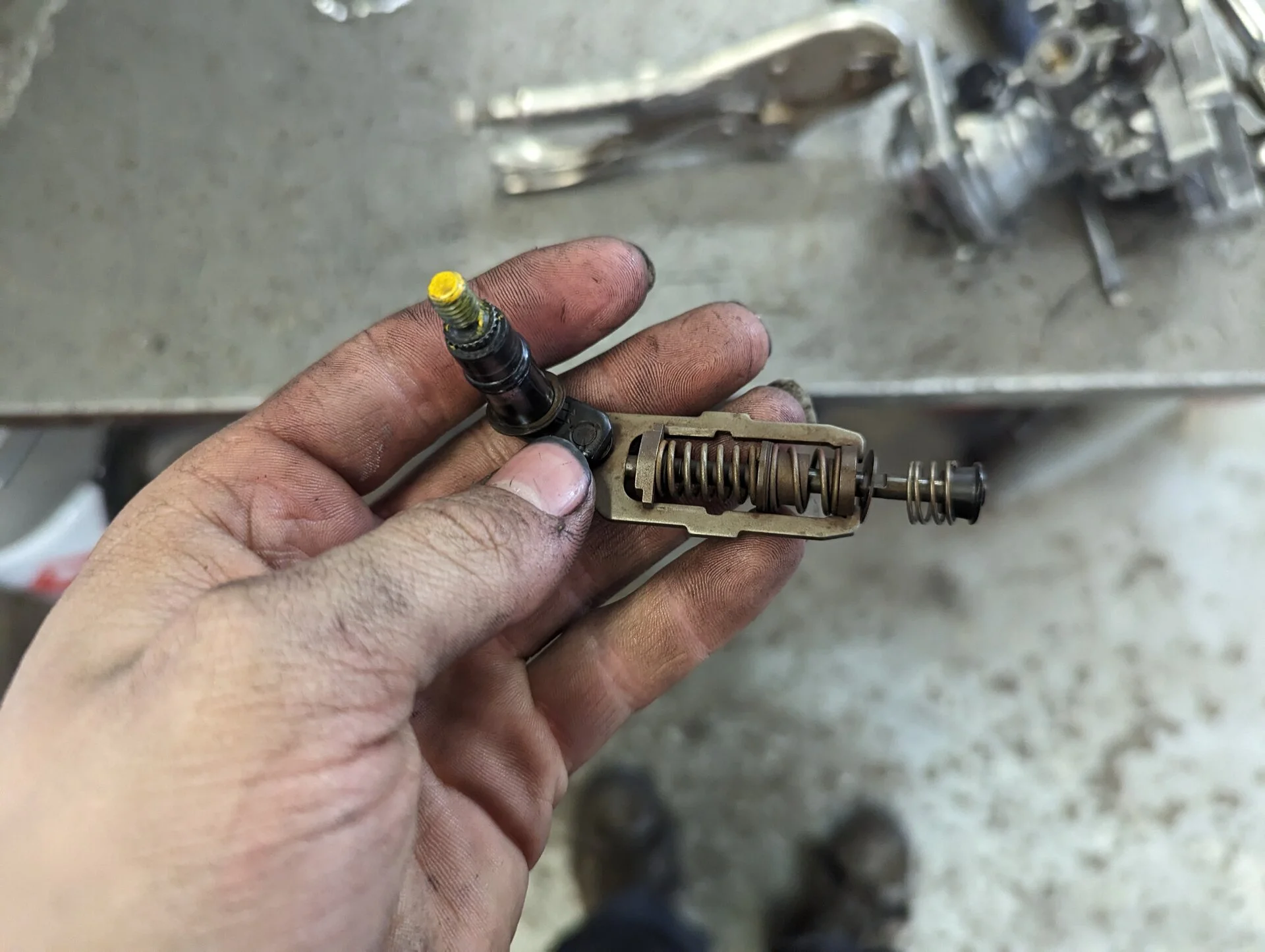

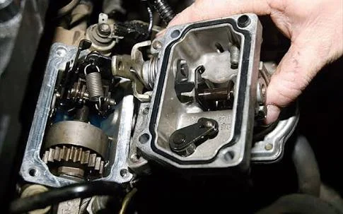

The star wheel is turned about 90% of the way in, I'll leave it like that for now. A weird thing I noticed, the governor spring is this weird looking thing
On my current pump top, it's just a simple spring. Do I need to use this crazy contraption or can I just pop my throttle shaft out and use the other spring setup instead?
Hmm yeah I think I'll just use my other spring. Looks like this one

Hmm yeah I think I'll just use my other spring. Looks like this oneView attachment 3426755
That spring is 100% a backyard job. You should return and get your money back to who ever built and calibrated that pump. With a spring like that installed I'd be seriously concerned about the parts used and the calibration of the rest of your pump. Where'd you get this pump from?

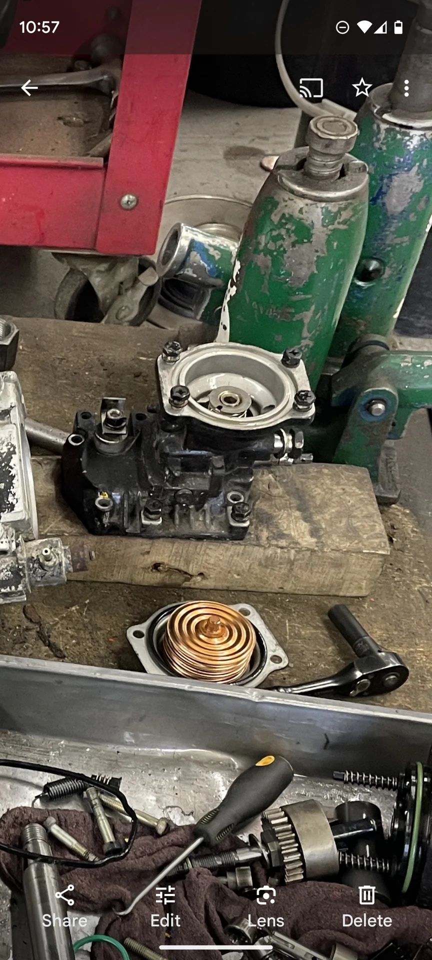

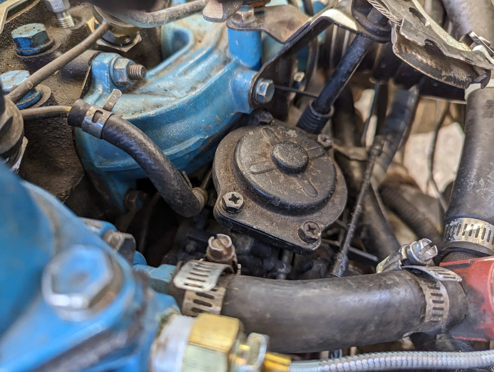

Also. Looking through my photos, I found 1 terrible picture of the inside of the altitude compensator.

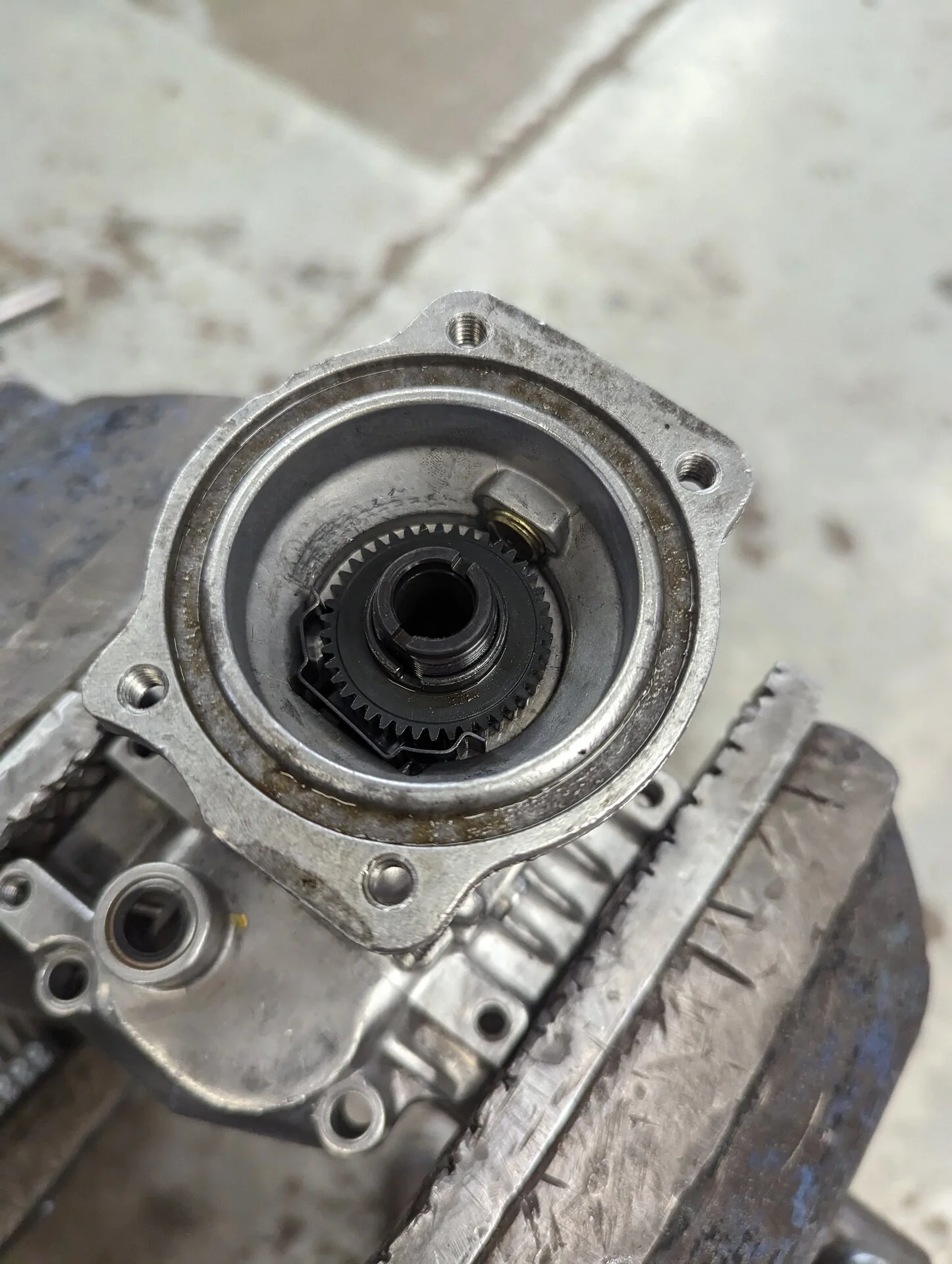

It looks like I might actually be able to swap the top internals without having to pull the pump to switch over to the boost comp. I might take the cover off tomorrow and see if the housings are the same. Would save me a weekend of finagling with fuel screw settings again.
