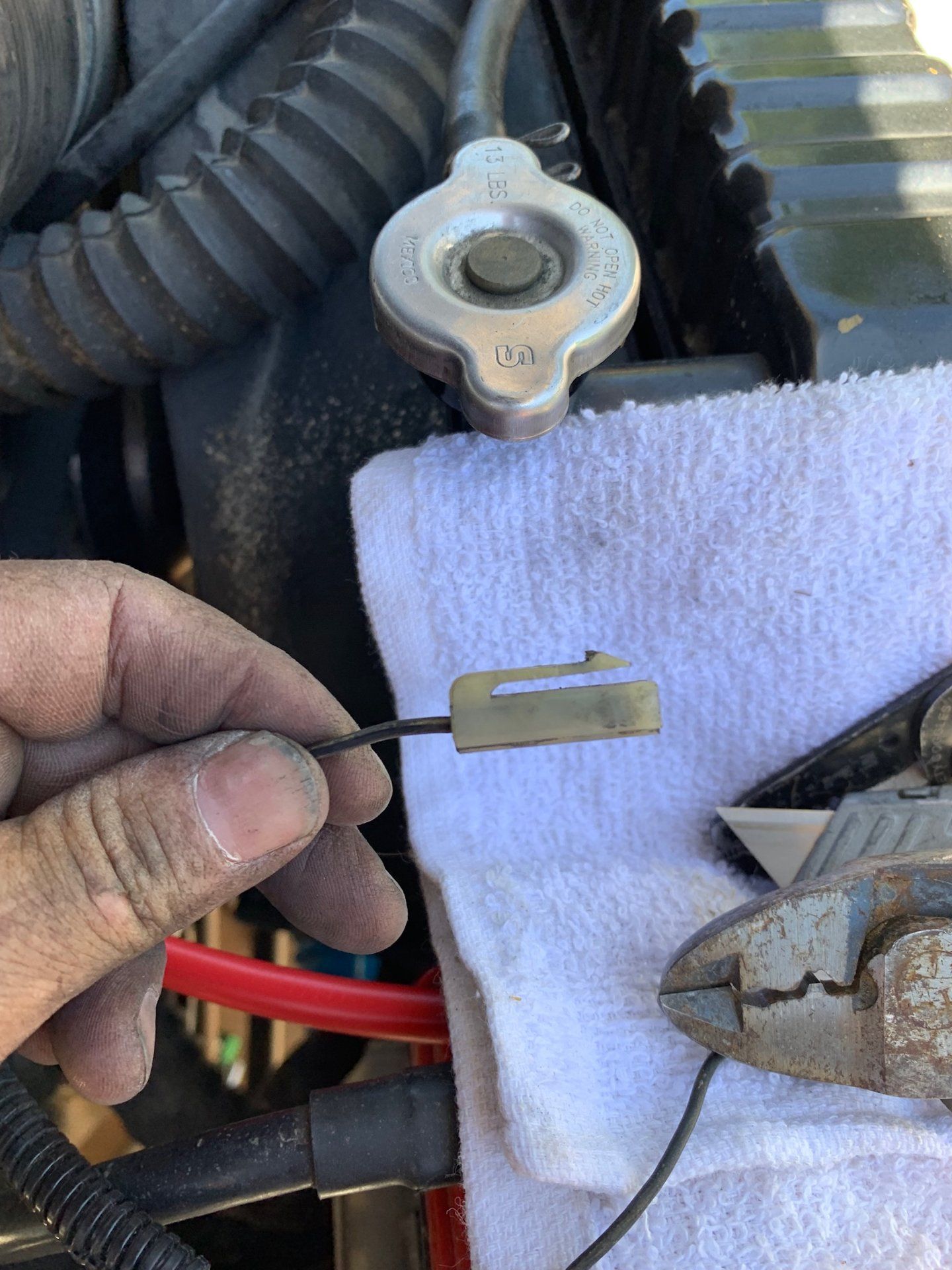

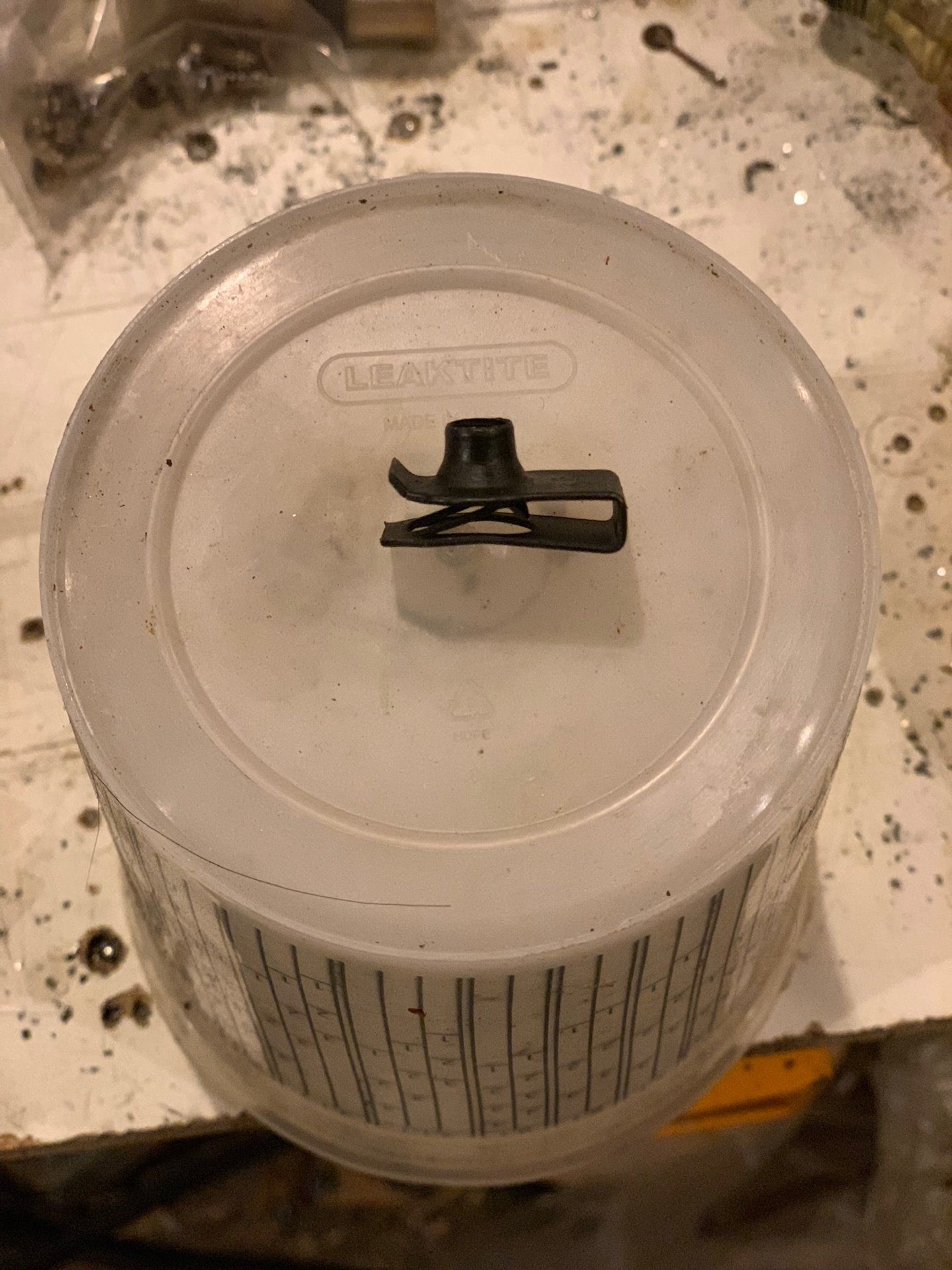

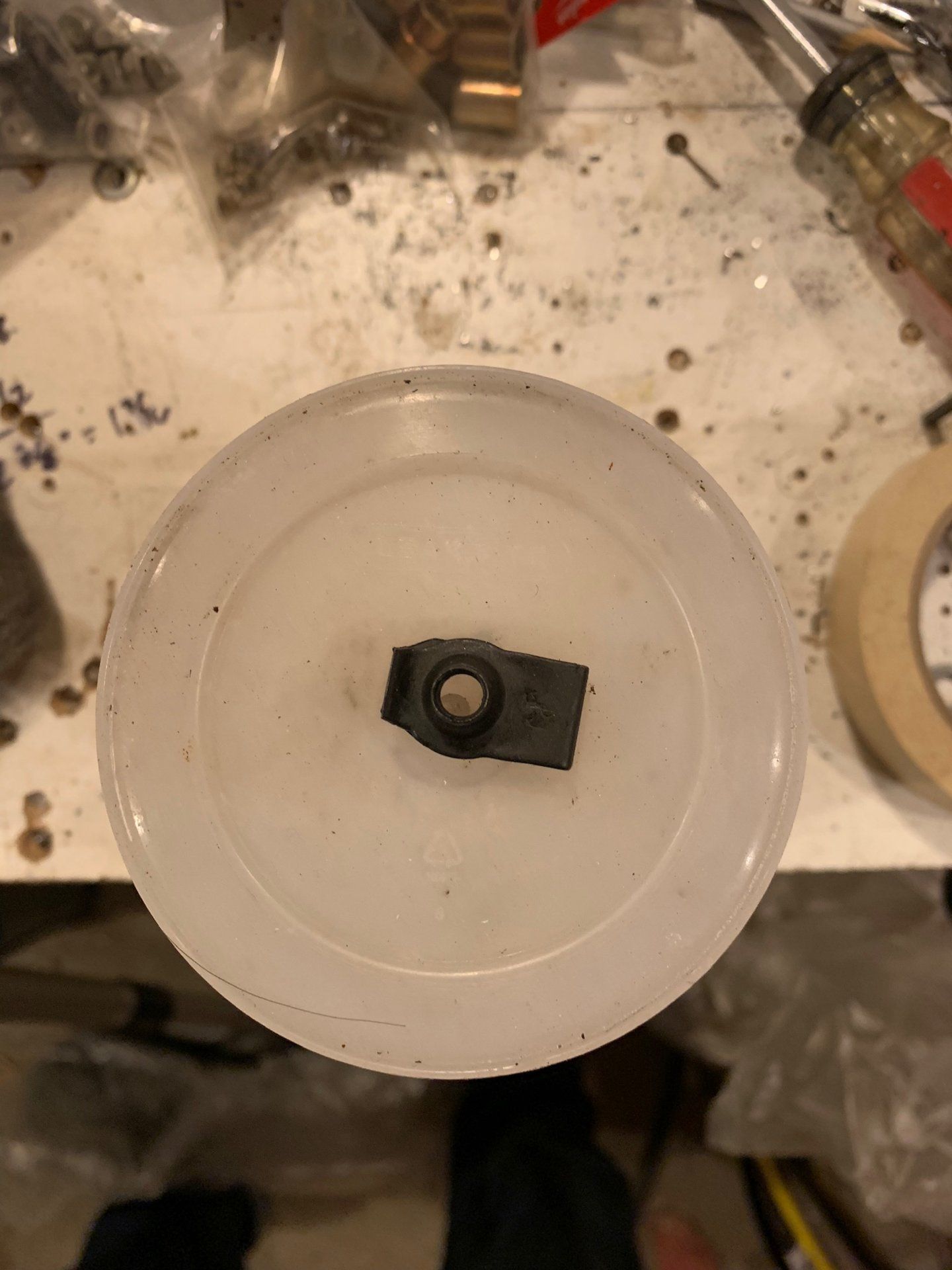

looks good...you've put a lot of work into that. What are you using to capture the fastner on the interior panels in the cargo area? I put in some crude wood panels on my truck but I keep having issues with the screws coming out, as I recall I used some type of plastic insert in the body panel...and the screw bites into that....but over time the screws come loose.
Hey Elbert, here’s a pic of what came with the panels. It’s a metal clip and is working awesome so far:
That looks fantastic. It reminds me of Volvo’s Atacama interior.
I wouldn’t worry about tossing stuff in the back. Leather over metal is much more durable than the vinyl over cardboard that was original to these trucks.
View attachment 1978376View attachment 1978377
ok, thanks for the feedback. I know about those (forgot the real name). I need to go back and see what I used....I think it was some type of plastic nut which as noted .....has not turned out well. I'll have to deal with that a little bit later this summer. I'll round up the parts...and get some of those "clips"

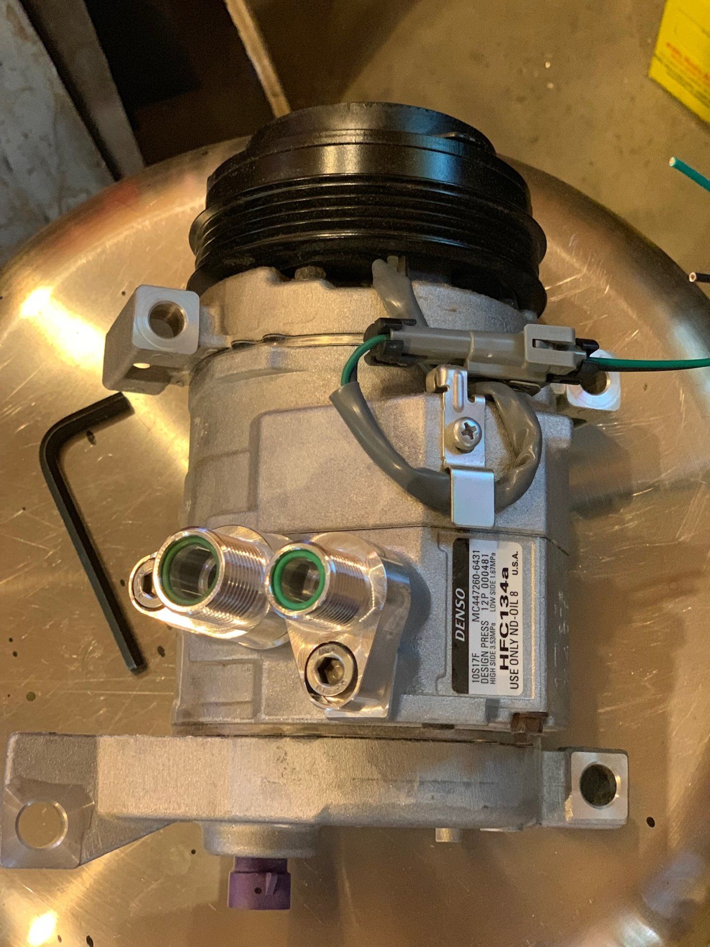

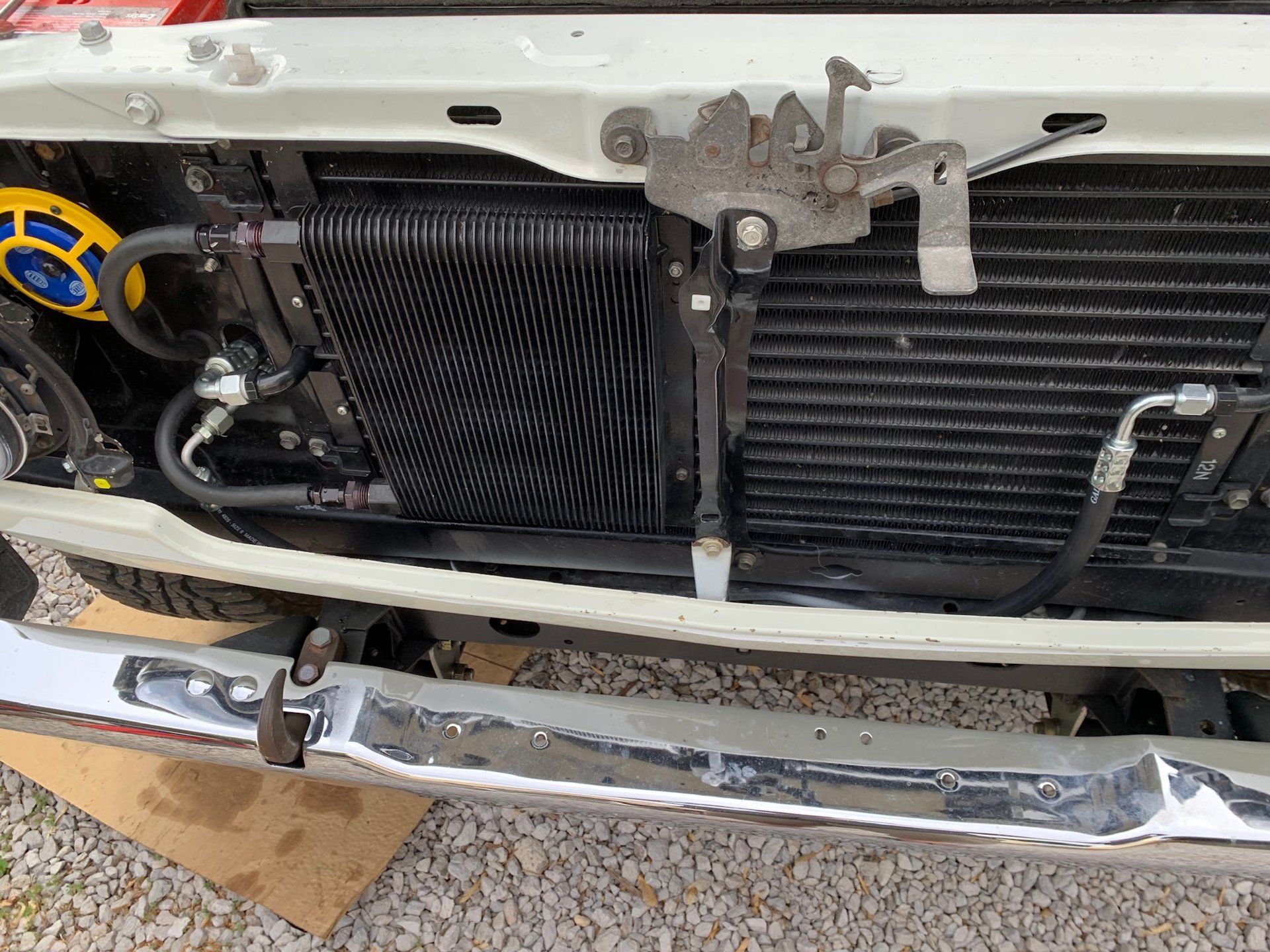

Thanks to Mosley Motors aka @FJ60Cam I picked up some hybrid hoses already set with the correct Toyota/GM hoses and adapters to plumb my system. I also sourced a new Toyota OEM dryer, condenser, pressure switch and thermistor from @Onur and I bought a new GM/Denso compressor. Almost a practically new system! I just drive it home from the shop that charged up the system and it’s blowing beautifully cold air! Just in time for brutal summer temps!
Here’s some photos and backstory:
New Denso compressor
GM factory pigtail
The wire that goes to old Toyota compressor connector gets spliced into green wire of the GM pigtail. Black wire on GM pigtail goes to chasis ground (thanks for your guidance here Cam!)
I modified my AC amp by following the sage advice in this thread: The A/C Amp Thread
Worked perfectly.

The custom hoses from Mosley Motors are almost idiot proof. They come labeled and with all the correct ends. One end of each hose is already crimped. Simply cut other end to ensure a perfect fit. The shop that charged my system crimped the ends for me but I could have sent them back to Cam for crimping if I had preferred.

Nice. I got my system all set up last week and did my compressor wiring today too. I made a little bracket for the compressor connector to clip to, now I see in your pic how it's supposed to clip to the compressor. I was wandering what that little bracket was for :lol:
I'm glad yours is working good, I'm really looking forwards to getting mine charge up tomorrow.
