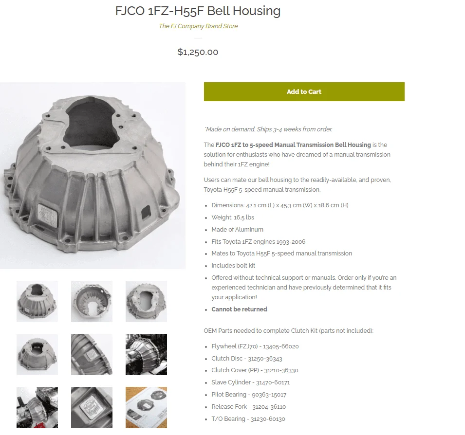

How about the 1FZ-FE?
Though the 2FE is the period engine that should have been....I think the 1FZ-FE is the engine that would make a nicely balanced 60.
