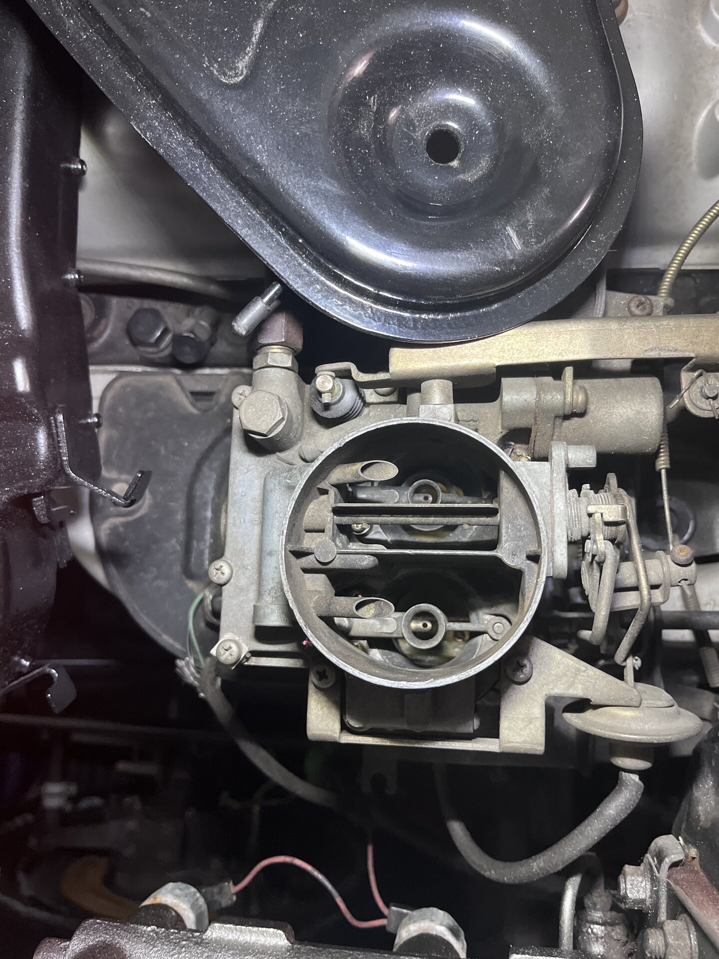

Hoping someone can help. This carburetor was on my 2F 40. Is it correct because I don’t see a spot to add the stud bolt.

is this a 2F engine
or a F1.5 with a 2F on it ?
Thanks! Any recommendations to plug the hole since there is no stud bolt?
that air cleaner will not work with that carb
either get an earlier air cleaner or a later carb

The scale appears to tip towards replacing the carburetor. It looks like you have a 2F insulator on top of a 2F intake. So unless your pedal linkage has been compromised, it should be a happier, easier fit than adapting an F engine air cleaner, with the attendant risk of breaching the head gasket to mount it.

Thanks all. Would CCOT be the best place to get one?
