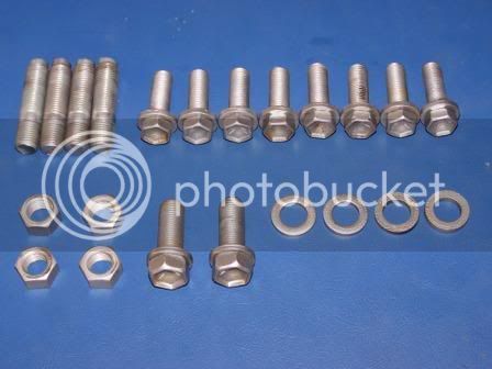

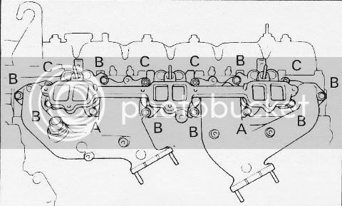

Made a start on the manifold bolts today which I kept separate as their seemed to be a strange mix of studs and blots as well as various sizes. I have noticed in the past genuine Toyota bolts have head sizes that maybe different to what the local auto shop may supply and these are fine thread too.
A 17mm Bolt Torque spec 51ft-lb or 69Nm
B 14mm Bolt Torque spec 37ft-lb or 50Nm
C Nut Torque spec 41ft-lb or 56Nm
Work has a pressure washer that has a fine grain sand in it, a little like shot blasting but far less abrasive, It wont damage the surface of steel.
Works a treat too:cool:
Bolts turned out nice! Any damage to the threads for just a gentle cleaning?
Just a gentle cleaning, the pressure washer/soft shot blaster is designed for cleaning precision plastic injection mould tools with a highly polished surface without damaging them. The sand/grain in it is extremely fine unlike the shot blaster we have that's very course in comparison.
Works a treat on my nuts and bolts too.:grinpimp:
