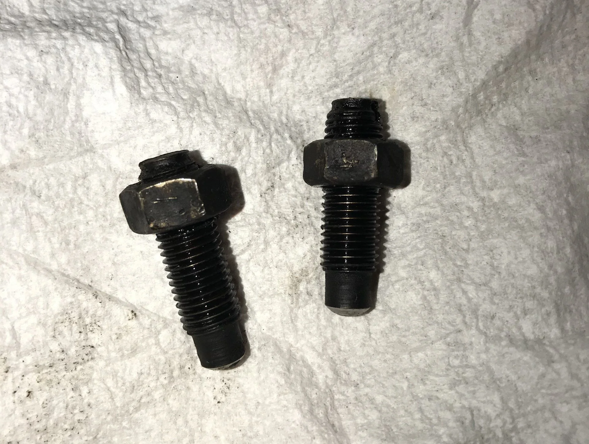

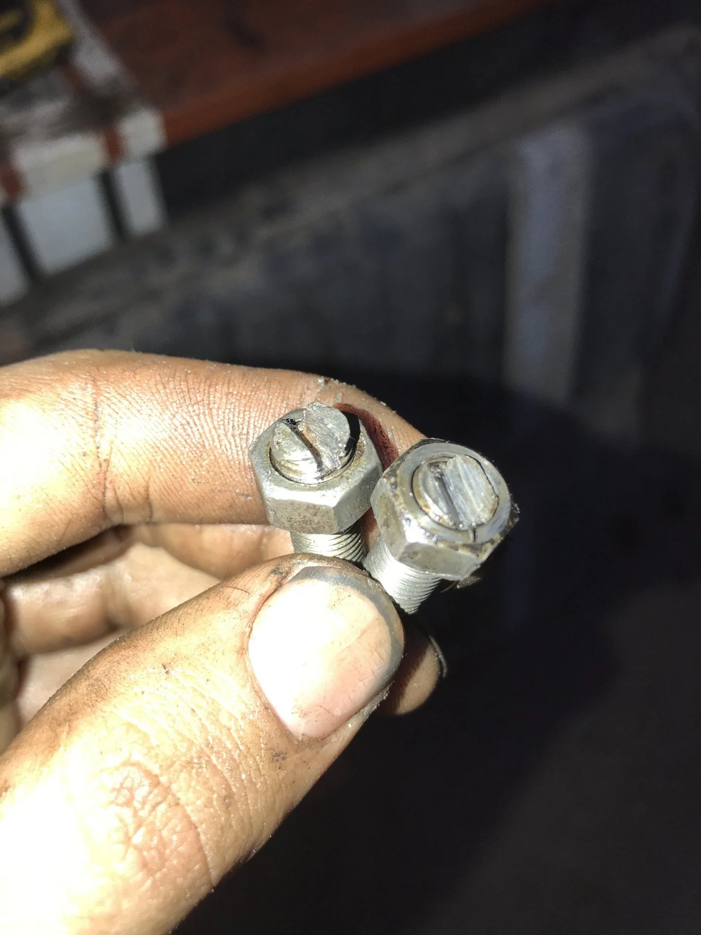

Last night after posting the above I salvaged the orig rocker screws, put em back on and adjusted. Quieted it down! Need to adjust the valves again, but that’ll be when the rad is out and getting repaired. Or will it? Might just JB weld the rad for now. Not much else to do on it until my delayed fuel tank sealer and the rockauto order I haven’t made yet gets here. I just want to bandaid the radiator so I can get it up to temp to do an oil change and proper valve adjustment.
If you want some that aren't mangled let me know. I have a few extra lying around.

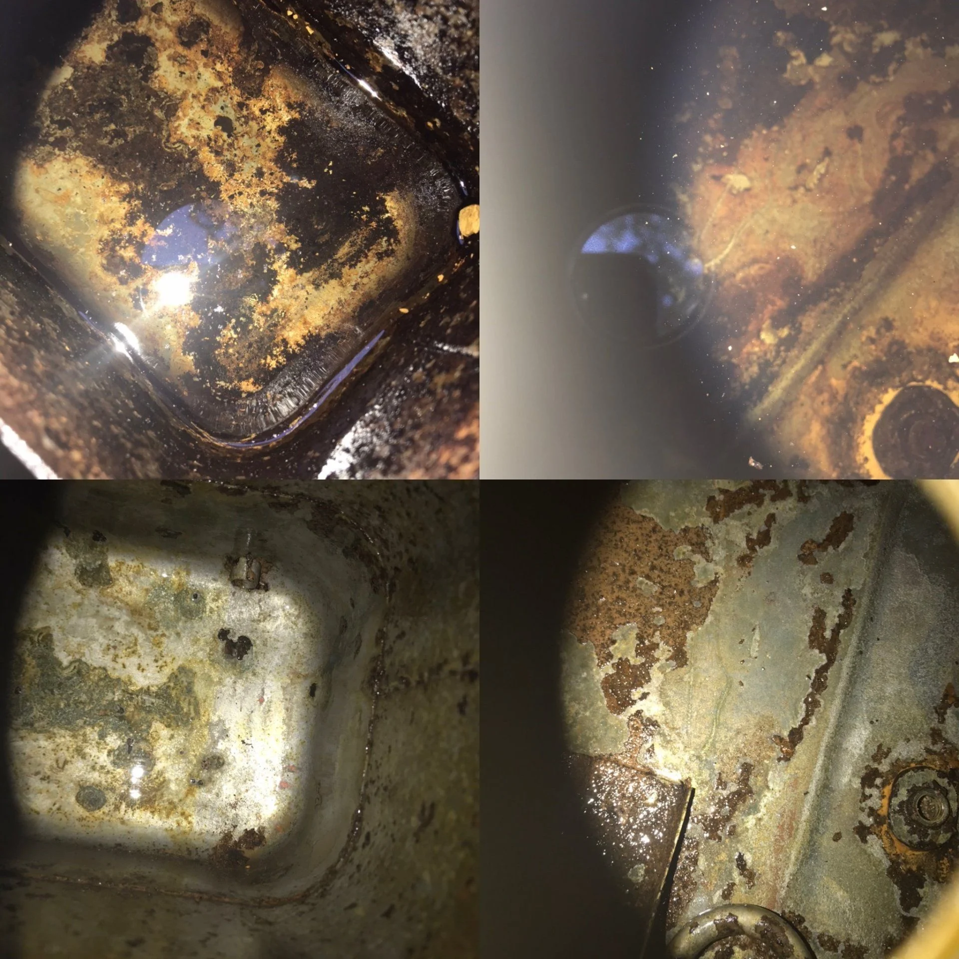

Did some chemistry in the driveway after work today. Tank is looking a lot better! Almost ready for a coat of sealant.
Hi, Looking better. Seal inside of tank and run non ethanol from Buckies. Mike
I think I’ll run another round of acid through it this weekend and then use the sealer.

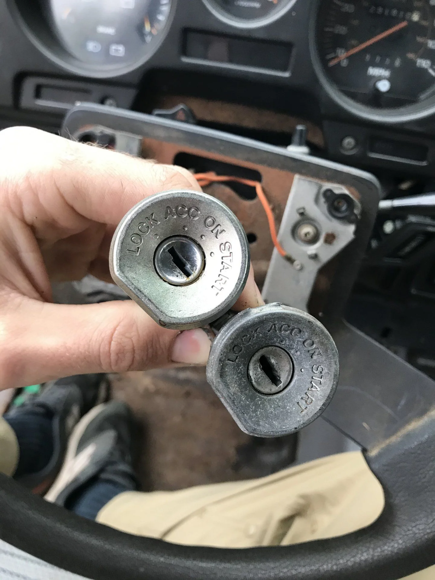

Trying to get the interior back together, and a new lock cylinder will get this process started. The old one was trashed. The problem is- I can’t seem to get it in?
That second pic is as far as it’ll go. Searching only led me to dead ends, doesn’t just pop in like my FJ60’s did. Any ideas?
If I remember correctly, there should be a little hole in the Cylinder housing ,right behind the wiper stalk, that you will need to insert something to depress the latch.
