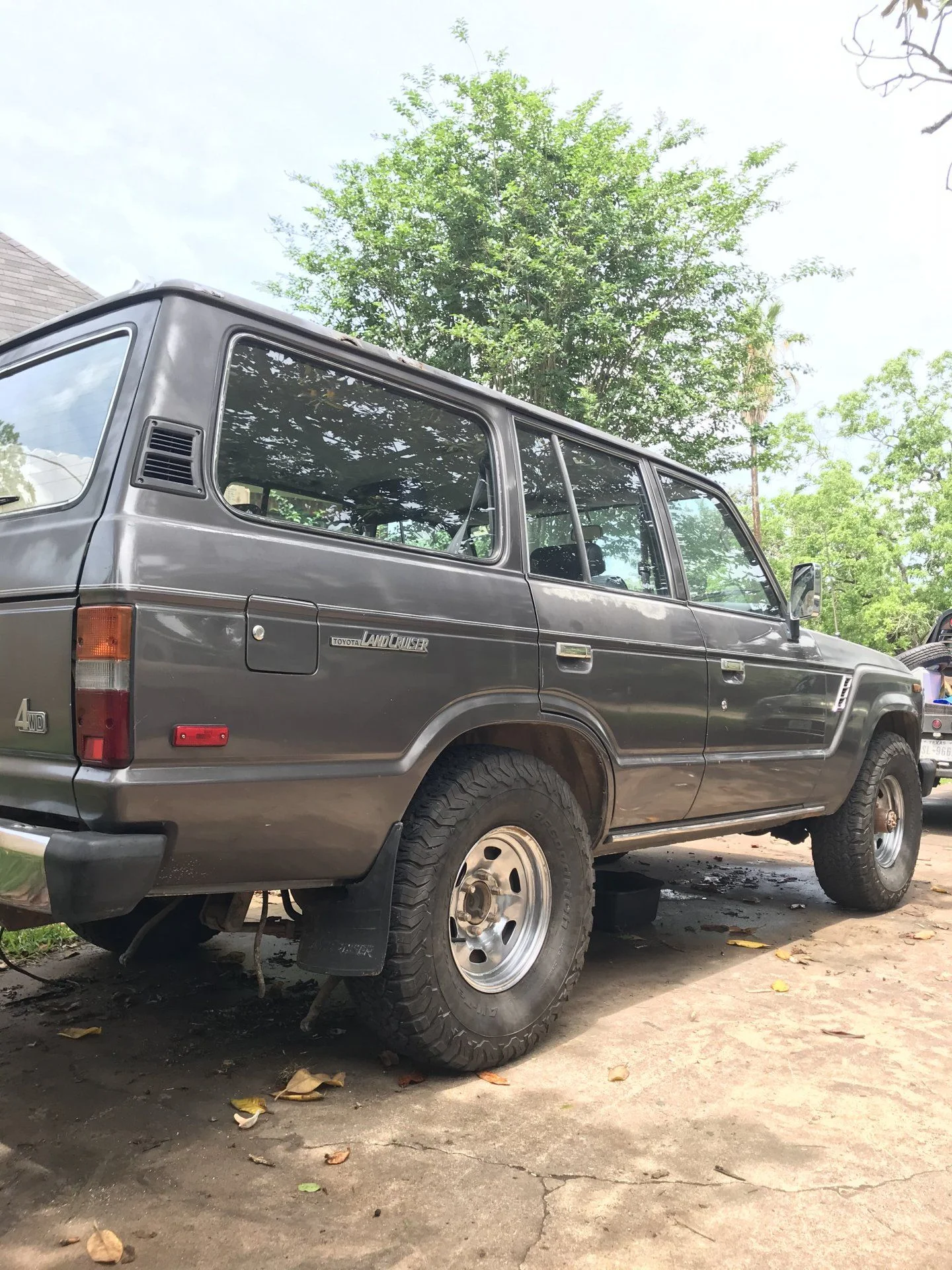

This thing looks damn good on some 33x10.5s! The stock suspension isn’t as bad as it is on my 60, so I put the wheels and tires that are going on the 60 on here until my OME comes.

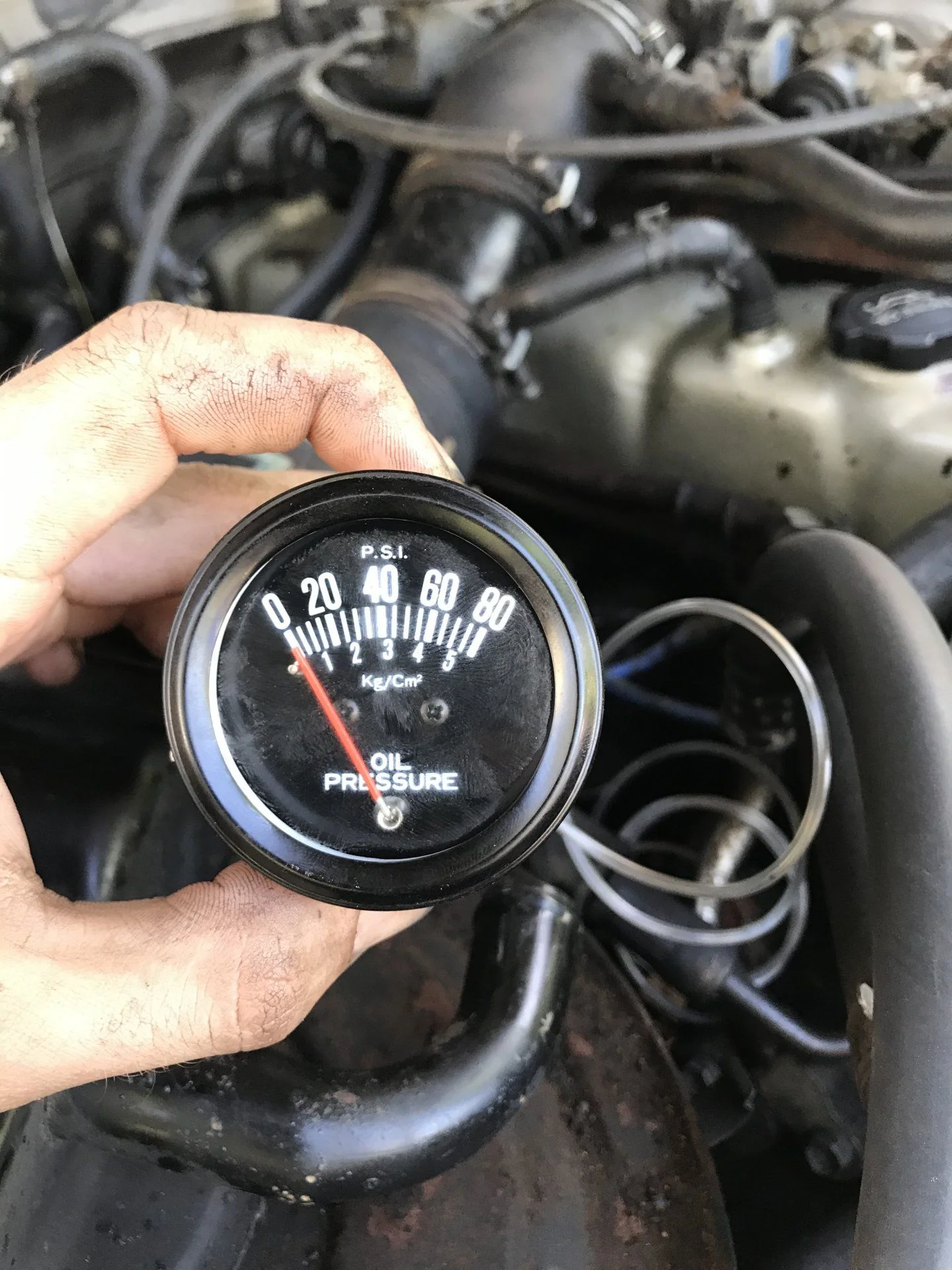

It’s alive! And has 60psi oil pressure at idle!

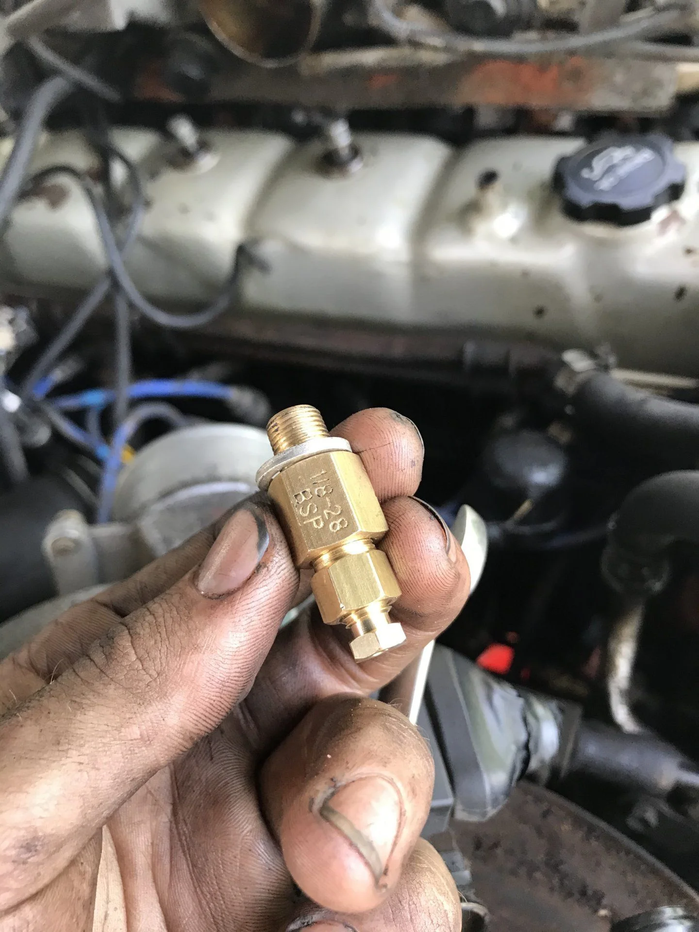

I installed a harbor freight oil pressure gauge with a BSPT adapter to keep tabs on that.

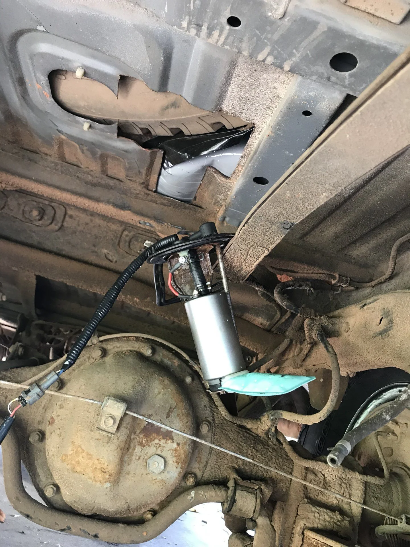

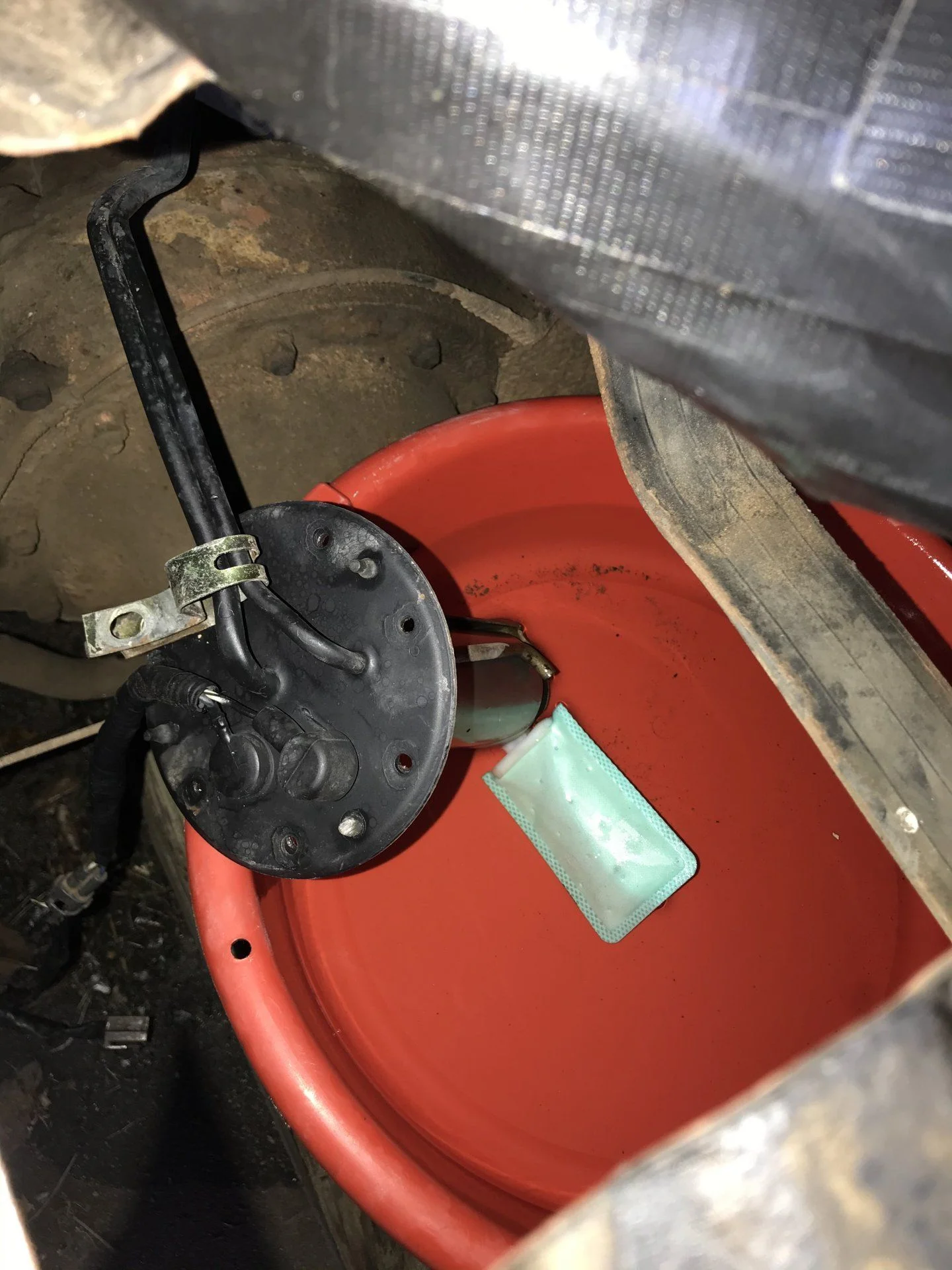

The last piece of the puzzle was fuel. This is still not 100%, as the tank isn’t restored and installed, but I connected the new fuel pump and put it in a tray of gas.
After a bit of cranking it roared to life! There are a couple of leaks right off the bat, either radiator or lower rad hose, and fuel at the sending unit. Maybe where it screws to the hardline, maybe it just splashed out of my tray, I haven’t investigated further. I’m just ecstatic that it runs and sounds smooth!

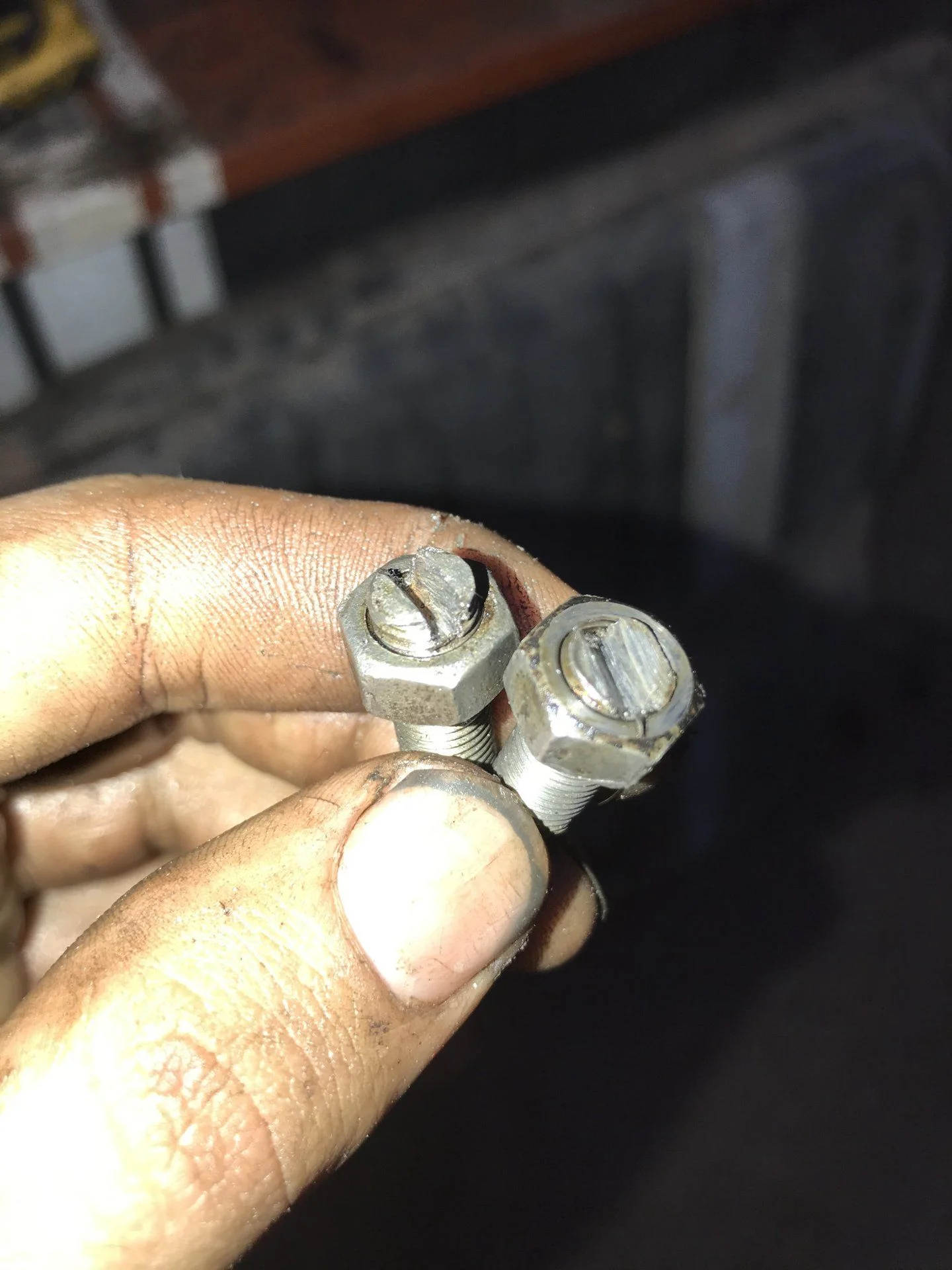

Needs another valve adjustment, and I need to pick up some of those valve adjustment screws to replace the ones I smashed.

Was the Harbor Freight Oil gauge NPT? I'm assuming the Japanese engine has BSPT.

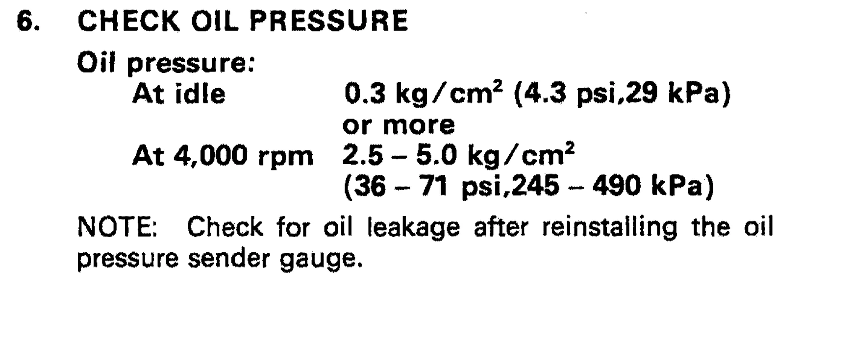

Oil pressure is a mystery to me... FSM states it should be 4.3 psi???? you have 60 psi. But perhaps it hasn't fully warmed up so the RPMs are around 1K.
I ran it for exactly as long as the video, it had no coolant and a large fuel leak so I shut it off quickly, and is full of a combination of mystery oils (most of which is 15W40). I’m just happy it had oil pressure!
Next time I run it, the resealed fuel tank will be installed and I’ll throw a bunch of tune up parts at it. Replace all bad hoses, change filters, new spark plugs, belts, etc. Then I’ll pull the valve cover and make sure oil gets to every rocker.
My original concern was a clogged pickup aka no oil pressure. This debunks that. Could a clog elsewhere cause 60psi oil pressure? Maybe, but I think it’s just the cold thick oil.

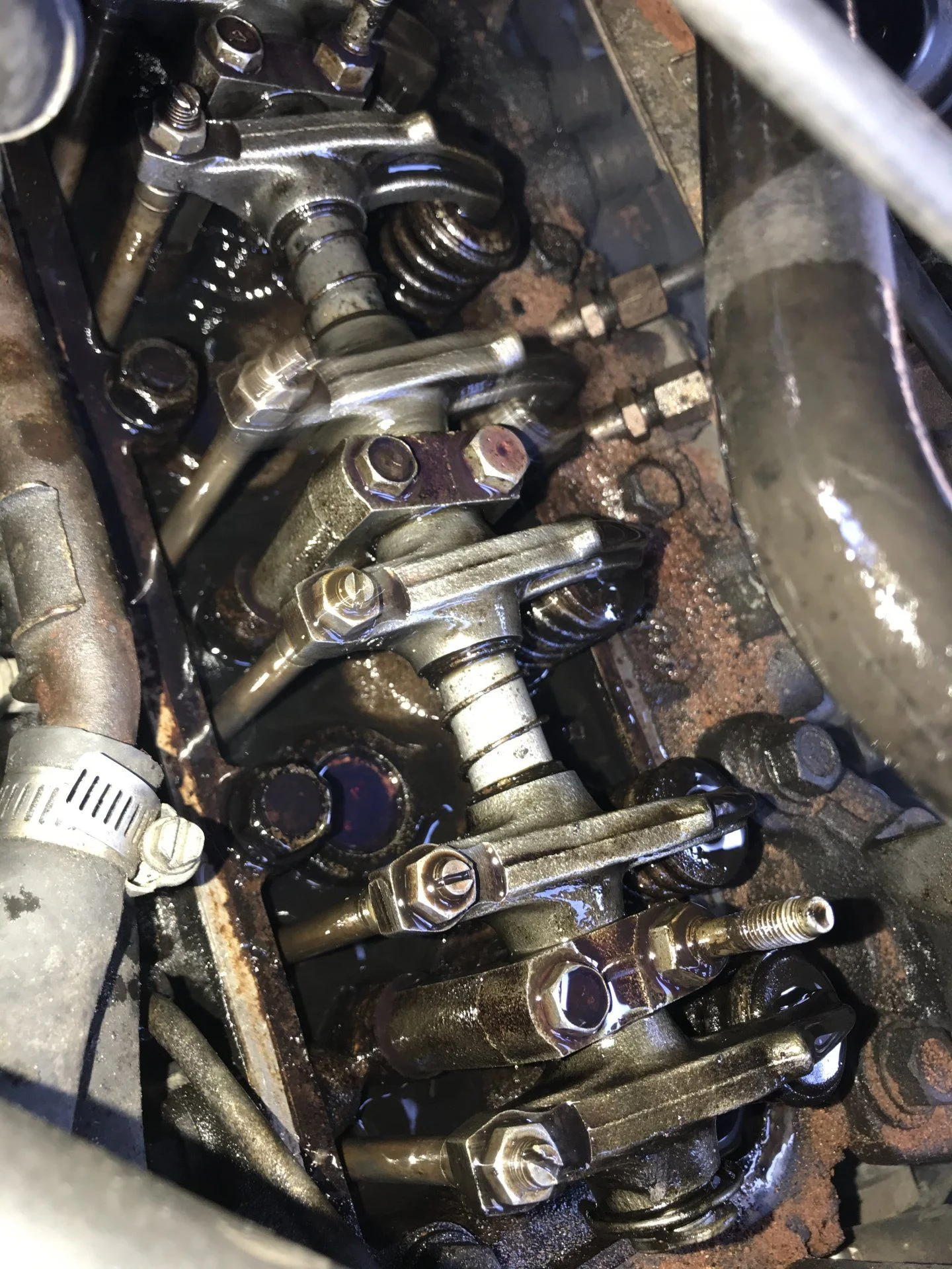

Well, decided to spend a few minutes on Touch of Grey this afternoon despite claiming I wouldn’t until it got a rockauto tuneup.
Fixed the fuel leak by tightening the fuel pump holder (or whatever it’s called) to hardline connection. Wasn’t even close to tight.
I then pulled the valve cover and plugged the hoses that go to it.
Cranked it up and she started right up. Observed the rockers and oil was coming out of them. Score!
Still 60 psi oil pressure at cold idle, but seeing as how oil is getting all the way to the top, I’m not concerned.

For now I’m going to attempt to salvage my smashed valve adjuster screws, because getting OEM ones shipped to me would be like $20.
Last night after posting the above I salvaged the orig rocker screws, put em back on and adjusted. Quieted it down! Need to adjust the valves again, but that’ll be when the rad is out and getting repaired. Or will it? Might just JB weld the rad for now. Not much else to do on it until my delayed fuel tank sealer and the rockauto order I haven’t made yet gets here. I just want to bandaid the radiator so I can get it up to temp to do an oil change and proper valve adjustment.
