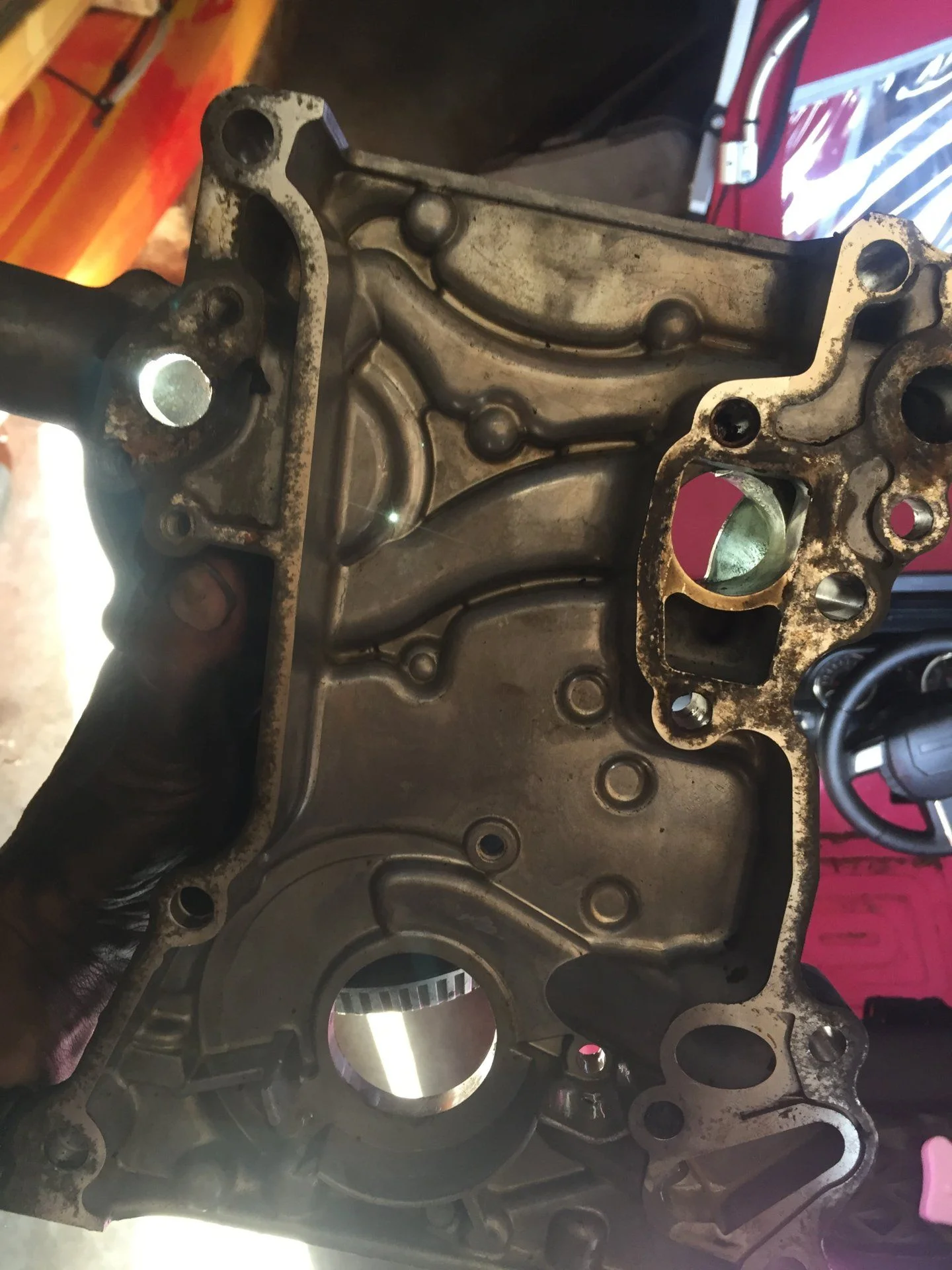

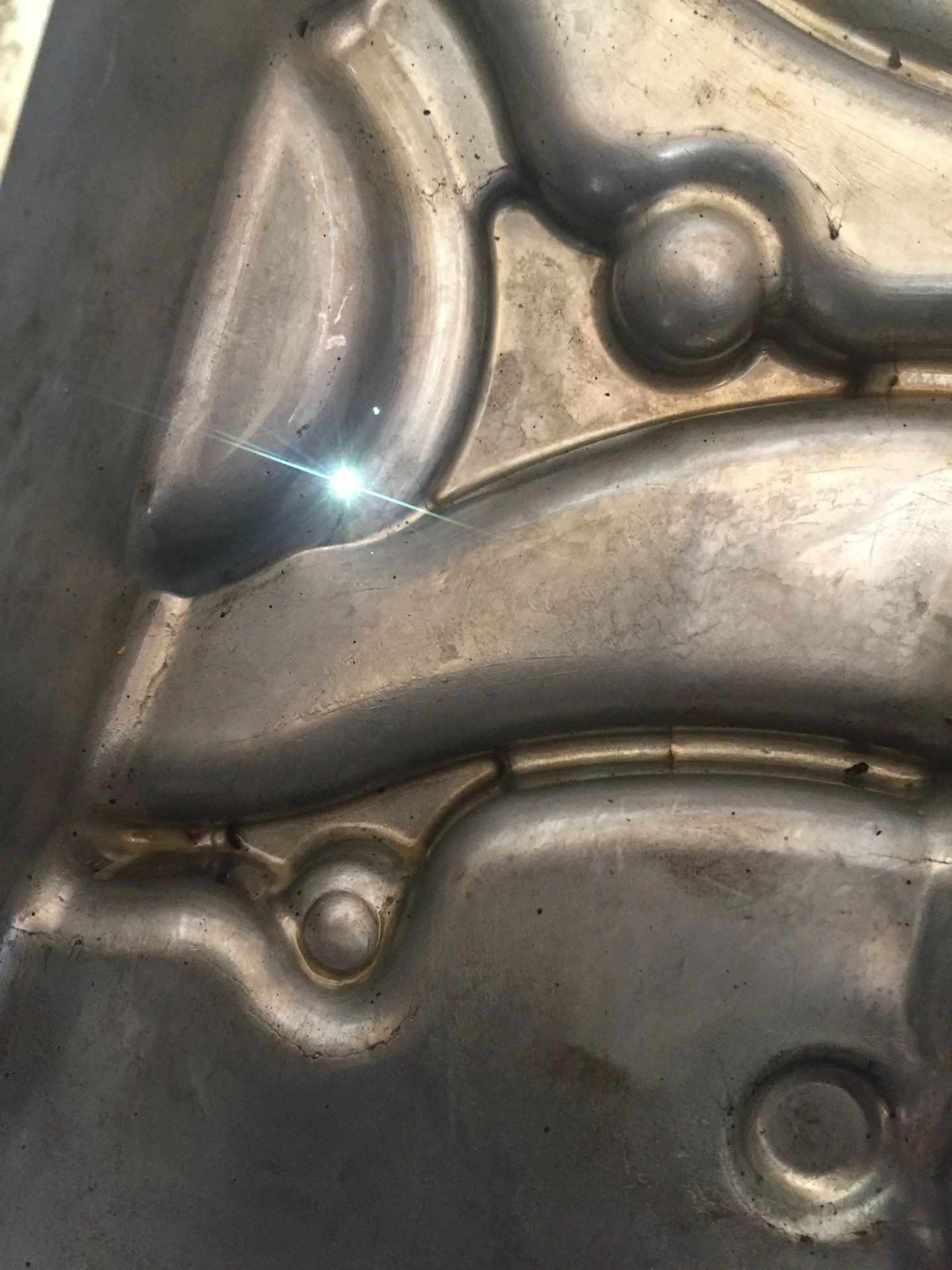

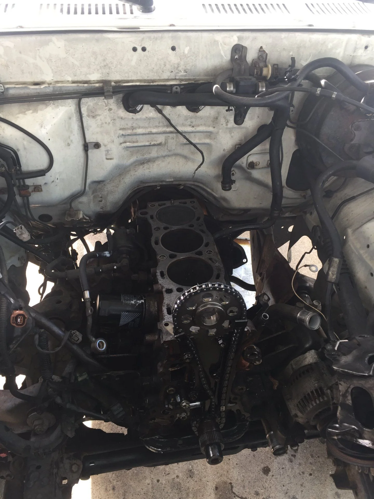

I was waffling about whether I should drop the pan to replace the timing cover or pull the head. The pan is glued on so well that I could not get the timing cover to budge at all. truck is 1994 that is still IFS so dropping the diff ads to the fun of doing it the "easy way". I opted to pull the head, The only part that really sucked was fishing the damn wire harness out of the intake manifold (Yes I disconnected the tranny/O2 sensors and pulled those ends through). Once I was deep into that process I discovered a cracked CV boot so ultimately I will be dropping the dif anyways. ugh. BTW, I had the motor "professionally rebuilt" about 70,000 miles ago. Much to my dismay, I discovered an epoxy patch job inside the timing cover at the water pump that I presume was supposed to seal up some corrosion around the water pump. the epoxy is eaten away and the corrosion has resulted in a pin hole that pumped coolant into the chain despite my annual coolant changes. In the attached photos you can see light shining through the pin hole.
