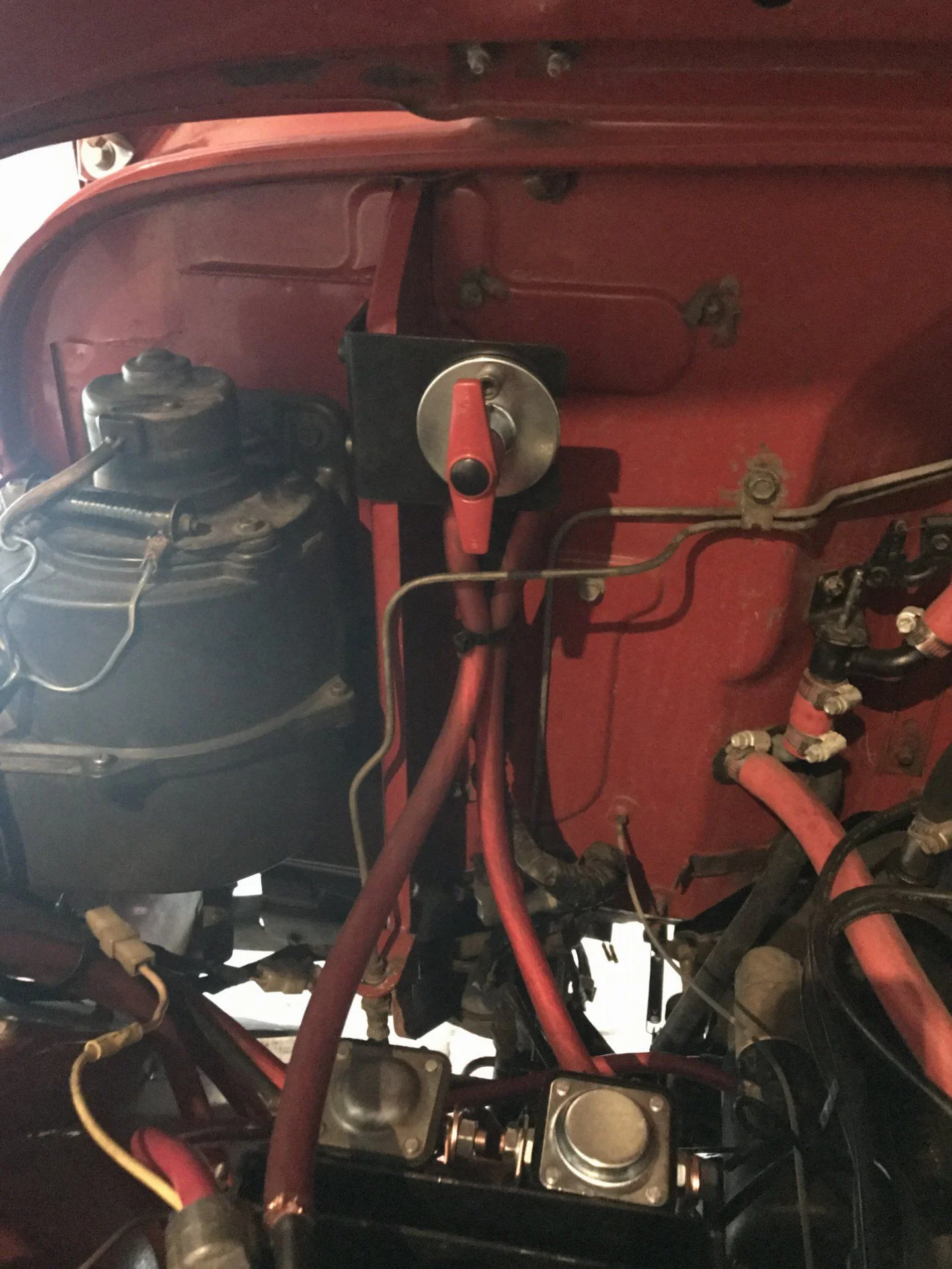

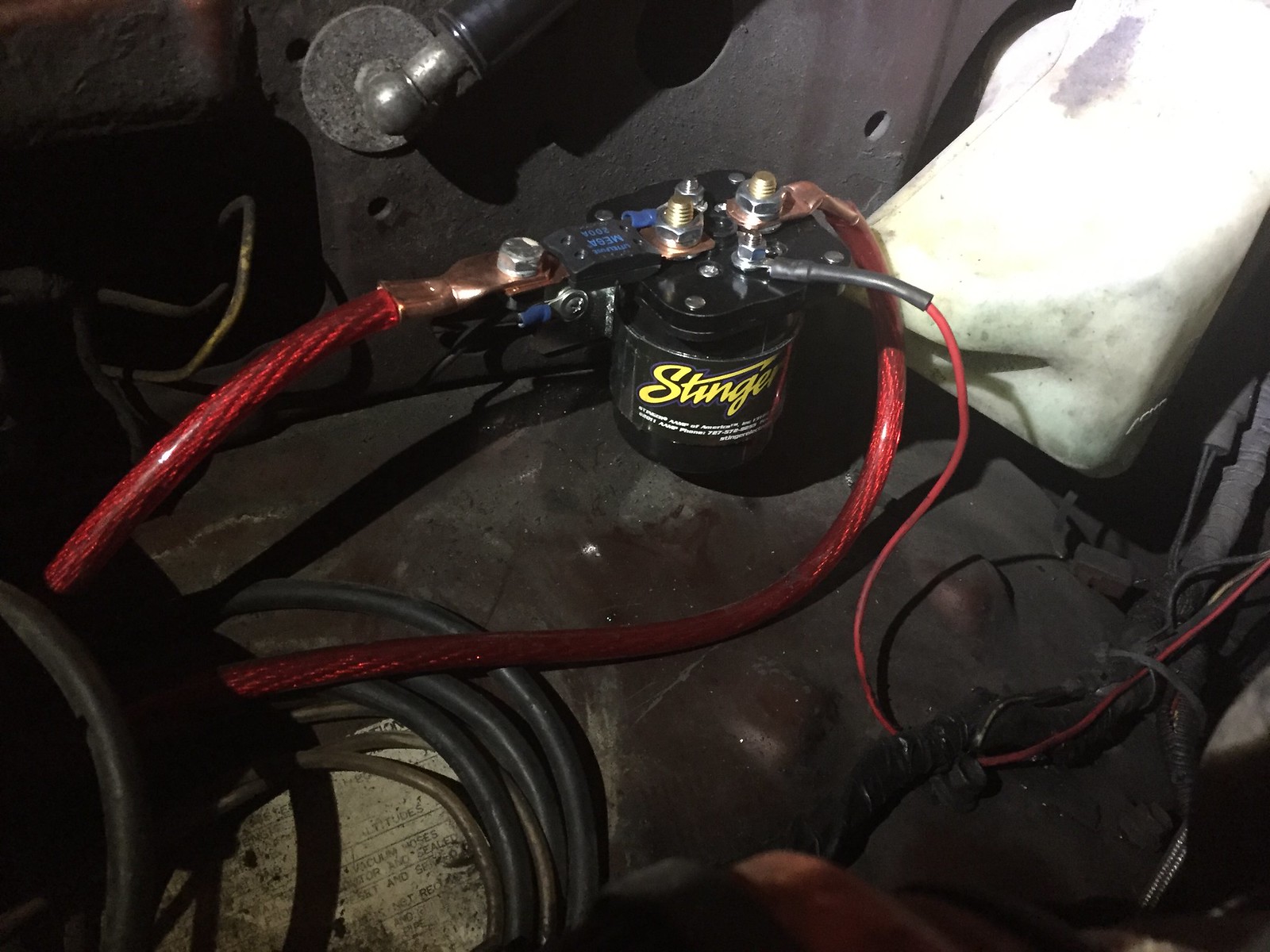

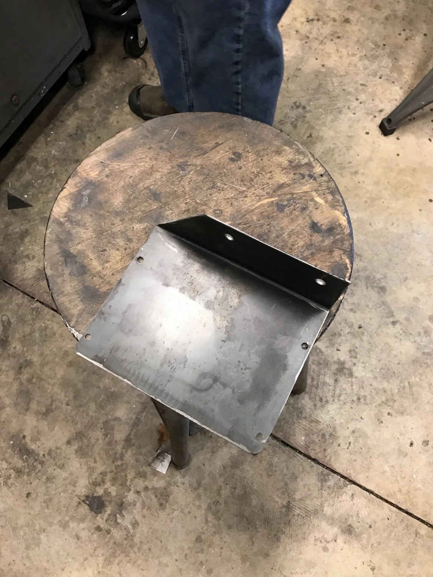

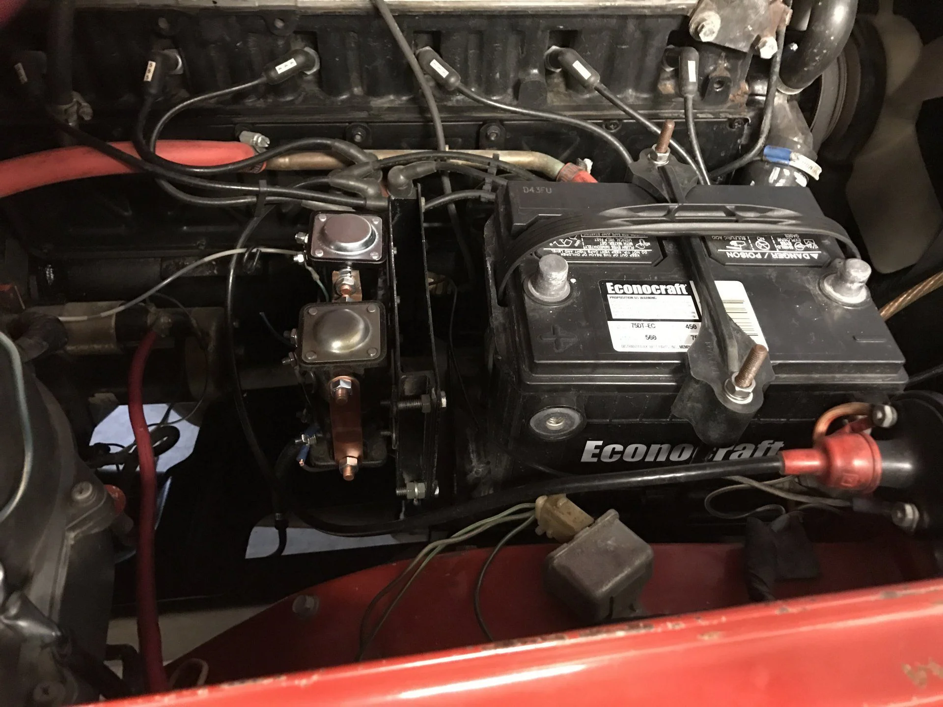

@2fpower I found the power cutoff at Harbor Frieght for $5. Made a bracket to mount on the firewall. Made a plate for the solenoid to mount on the battery tray.

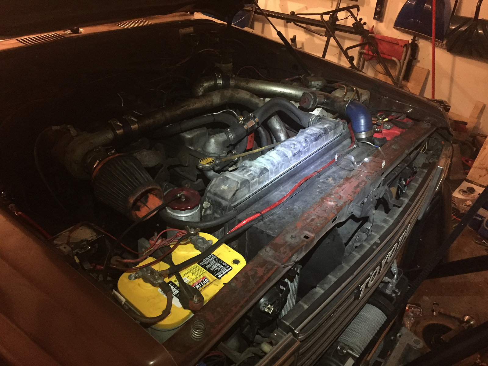

Batteries:
Proper battery isolator with temporary fuse:

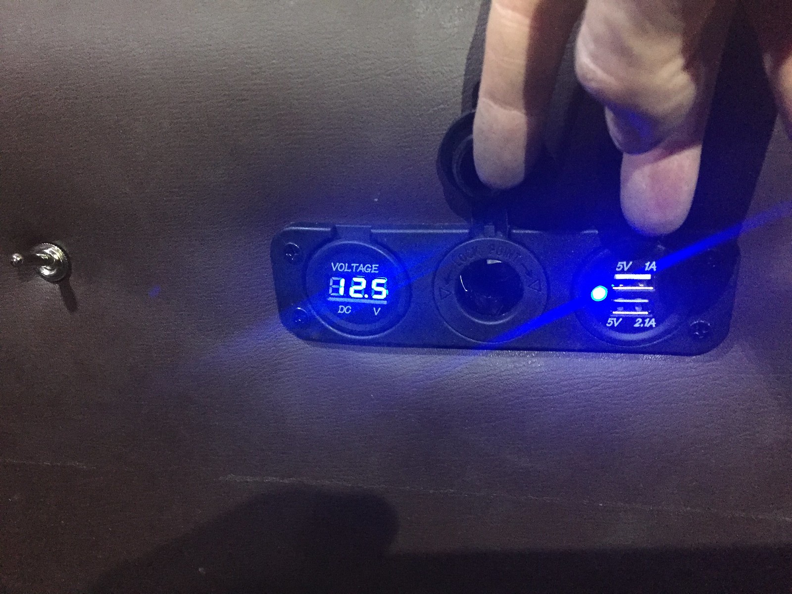

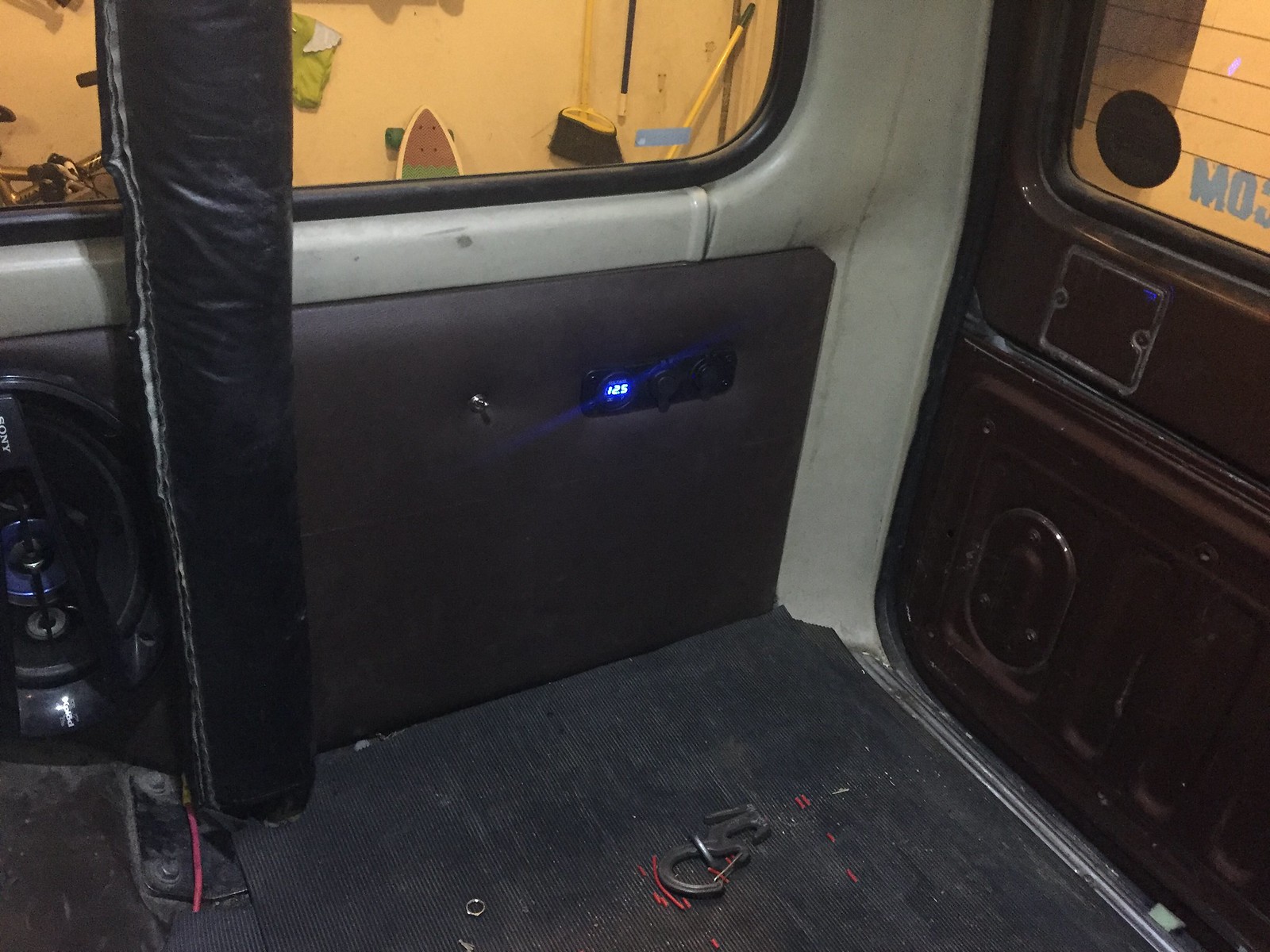

Connected to the Aux battery: volt meter/ 12V plug/ Dual USB plugs with switch:

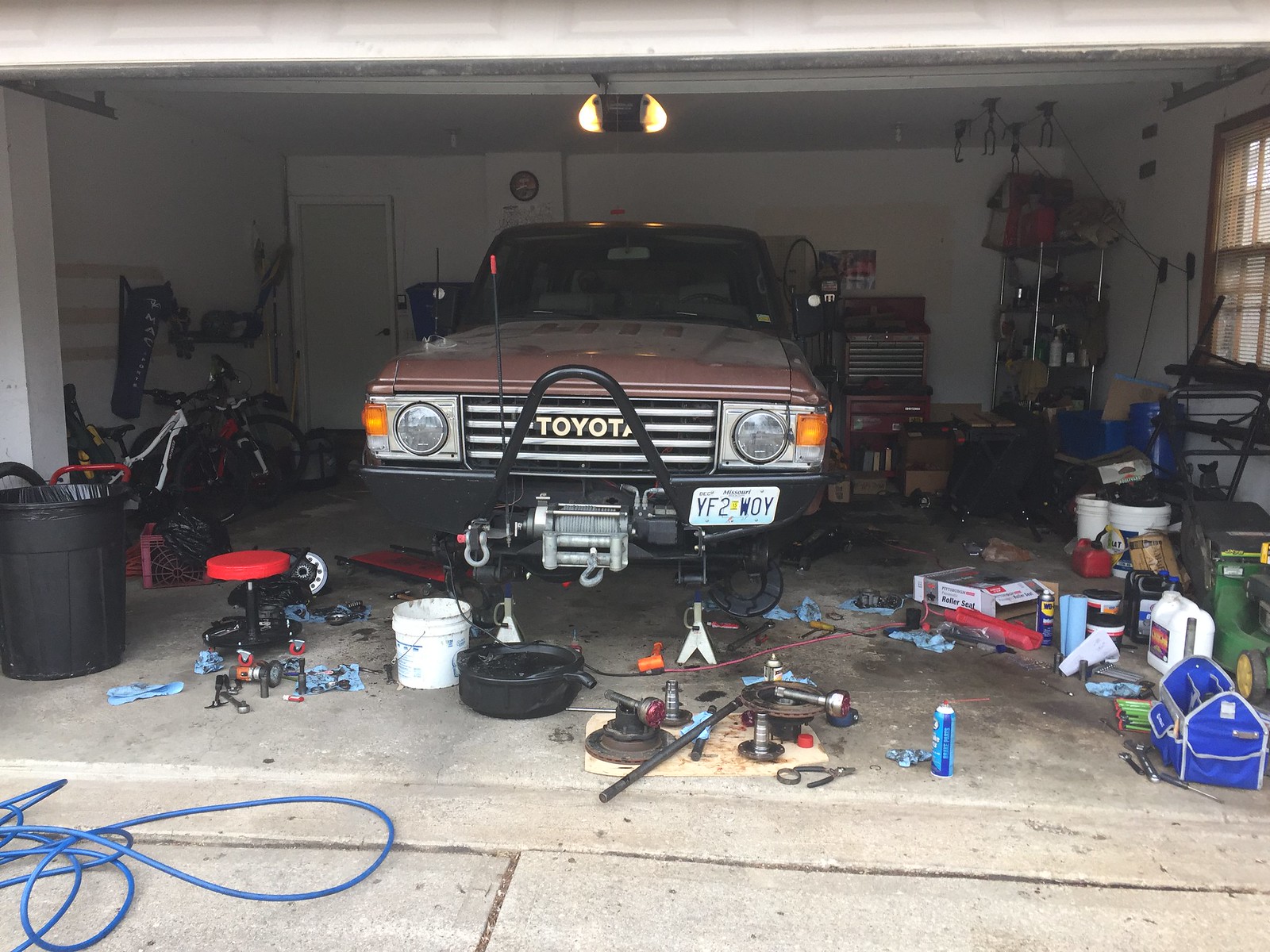

Rebuilt the front axle AND swapped the front third with a 4.11 finally. Rear to follow soon.

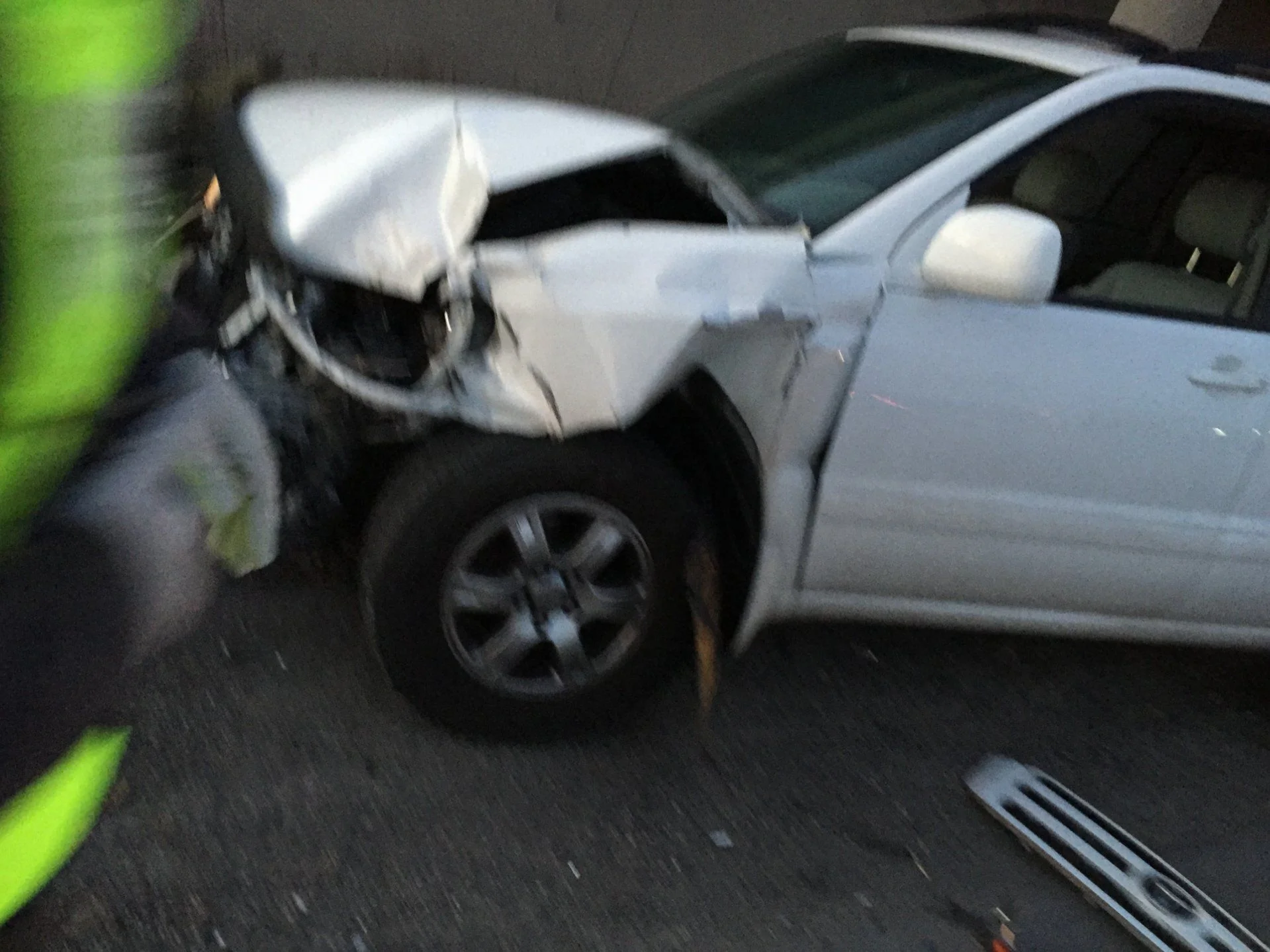

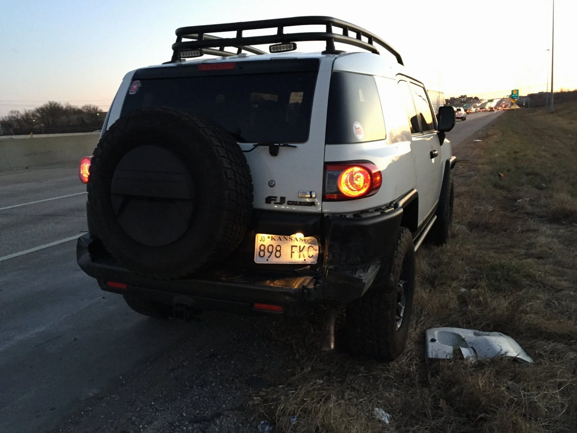

Dang. What happened

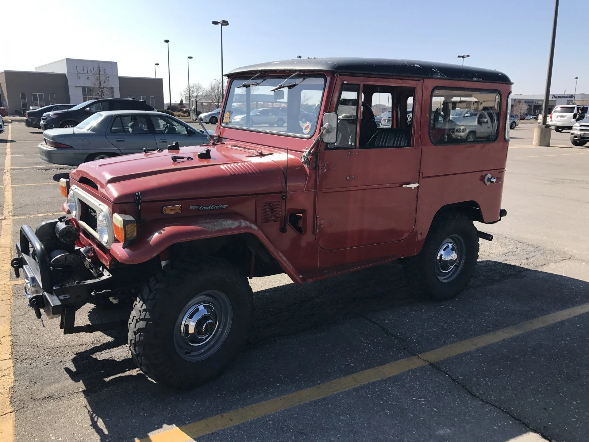

Rear-ended on right corner at about 25 mph. Shot me diagonally across traffic and I got tapped again on the left corner. Taking it for an estimate tomorrow. Definitely needs all new bumpers, rear hatch and quarter panel patch. You should see the Highlander that did it.
looks like the Highlander died.
Parked in the US bank drive-through to avoid this.

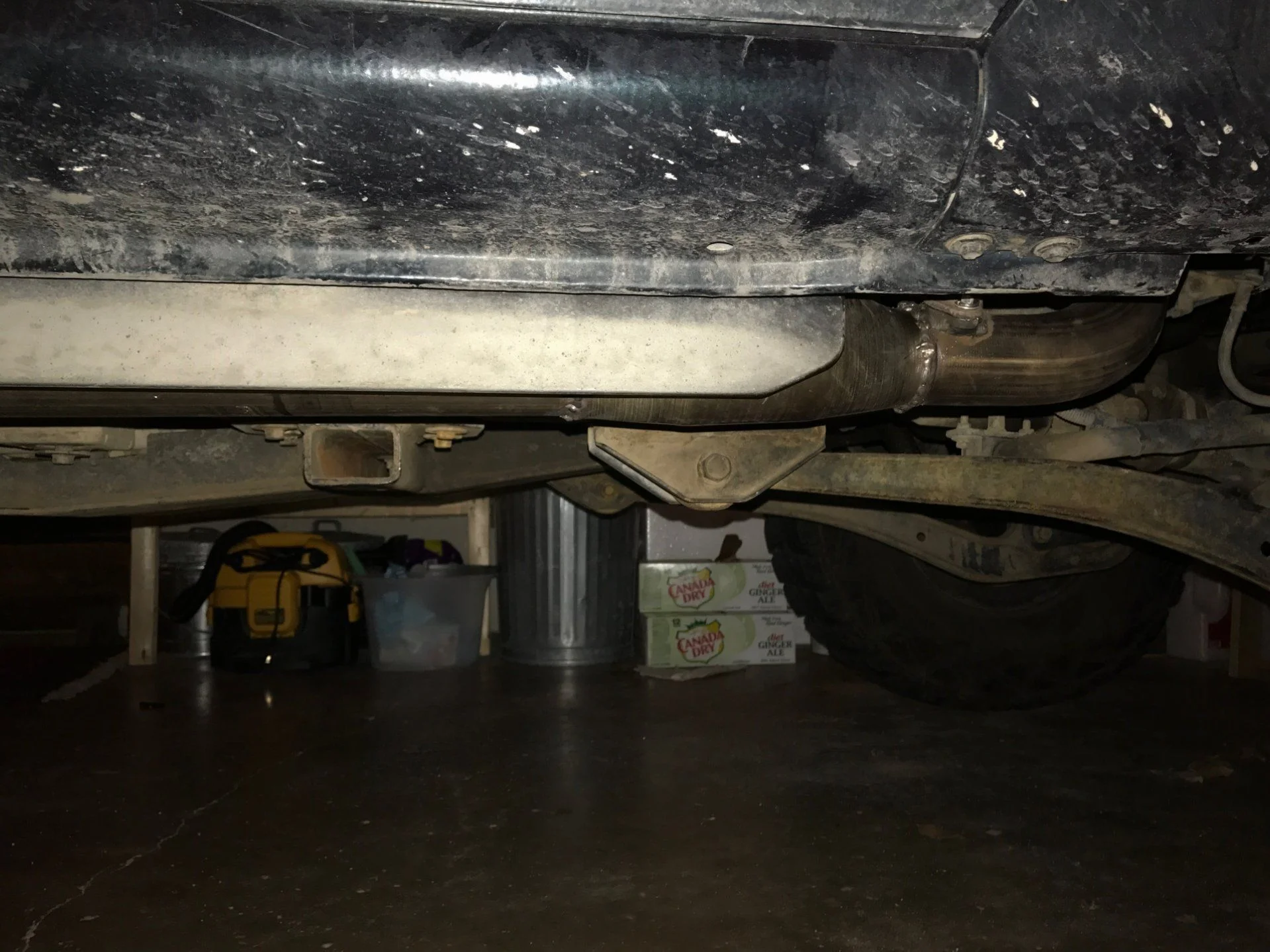

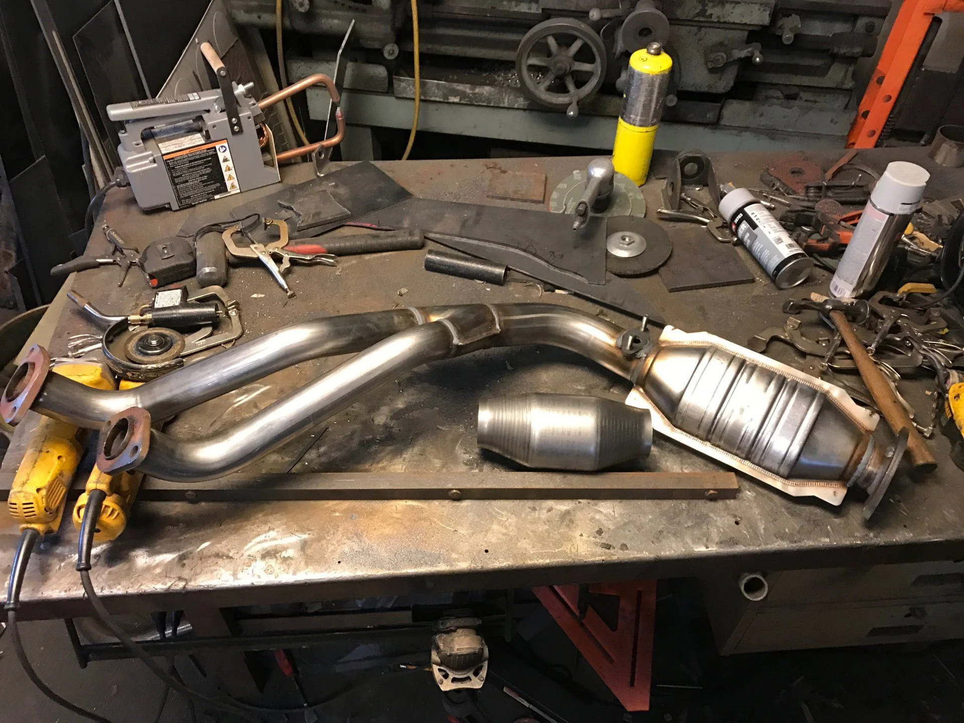

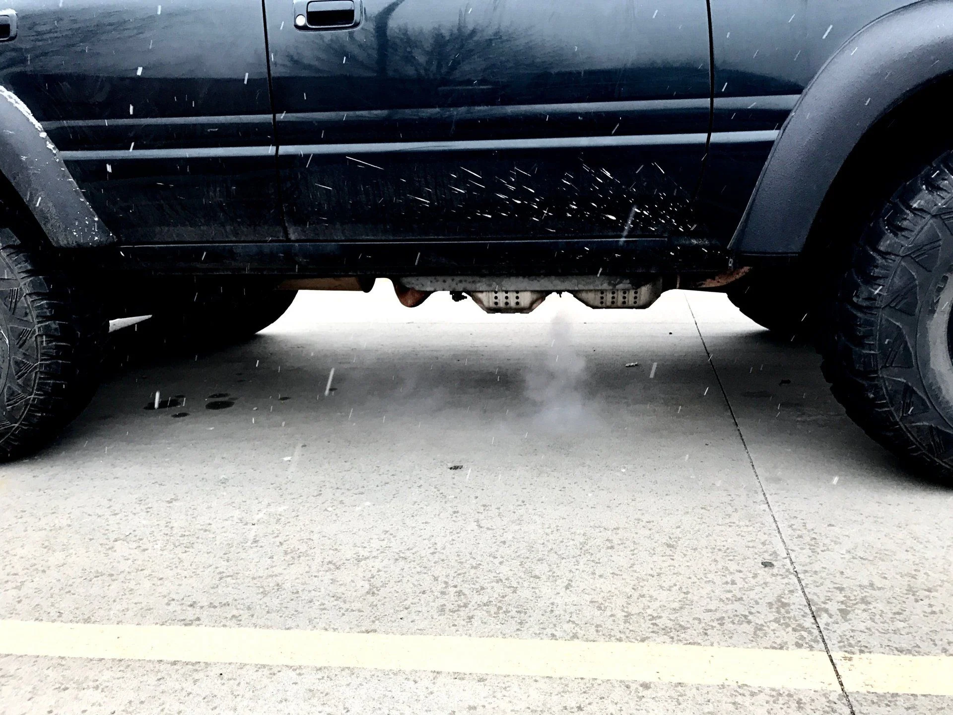

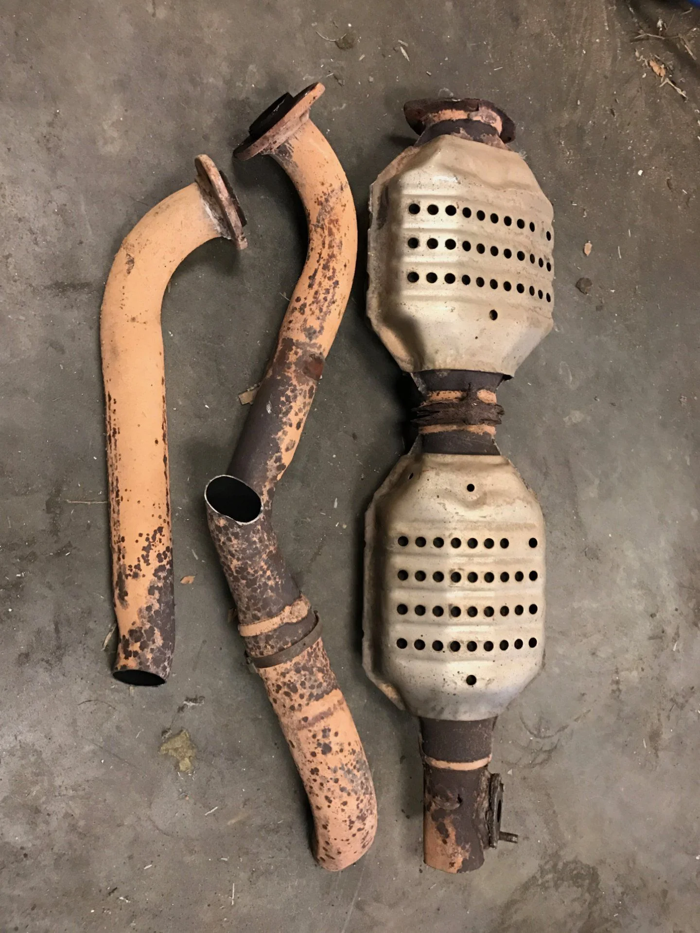

My y-pipe and cats have been bad for awhile (If you notice in the picture it is leaking between the 2 cats. Also leaked in several spots on the y-pipe). Finally pulled the trigger on a Magnaflow y-pipe and front cat.
The Magnaflow stuff seems really good. I like the way they did they y-pipe. I cut off the cat that came with it and welded in just one Magnaflow universal cat. This gave it a better profile that is up inside the body and frame (I duplicated what @2fpower did on Boost).
So far it only threw a P0125 the first time that I got on the highway but it hasn't thrown a code since. I've let it cool down and tried to see if it would throw the code but it didn't. Fingers crossed.
Thanks to @2fpower for the help.
What is the best place to take my old cats for some money back?

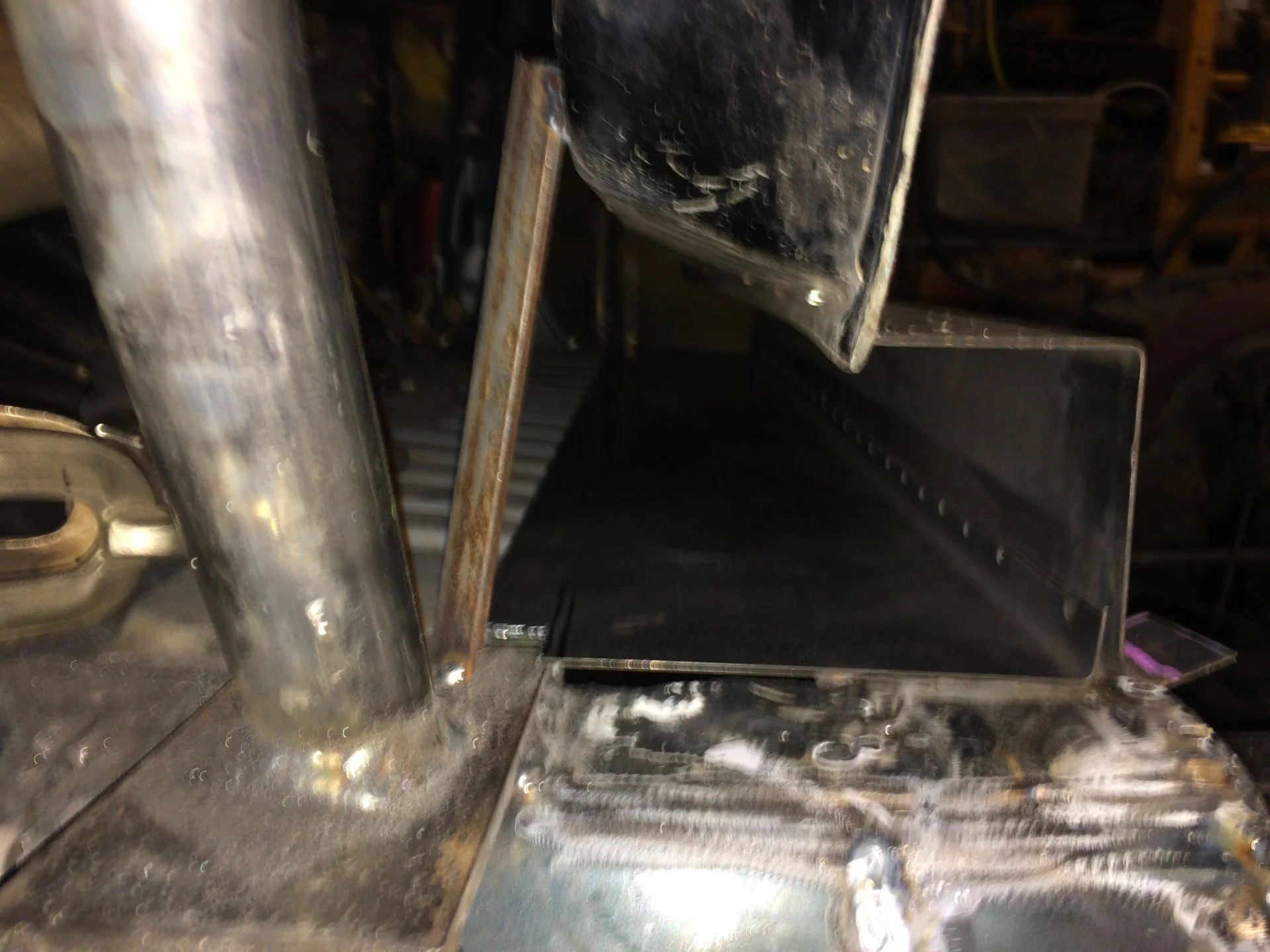

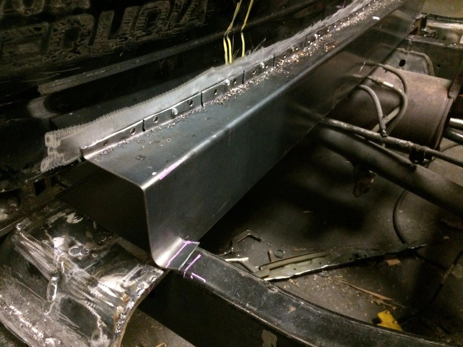

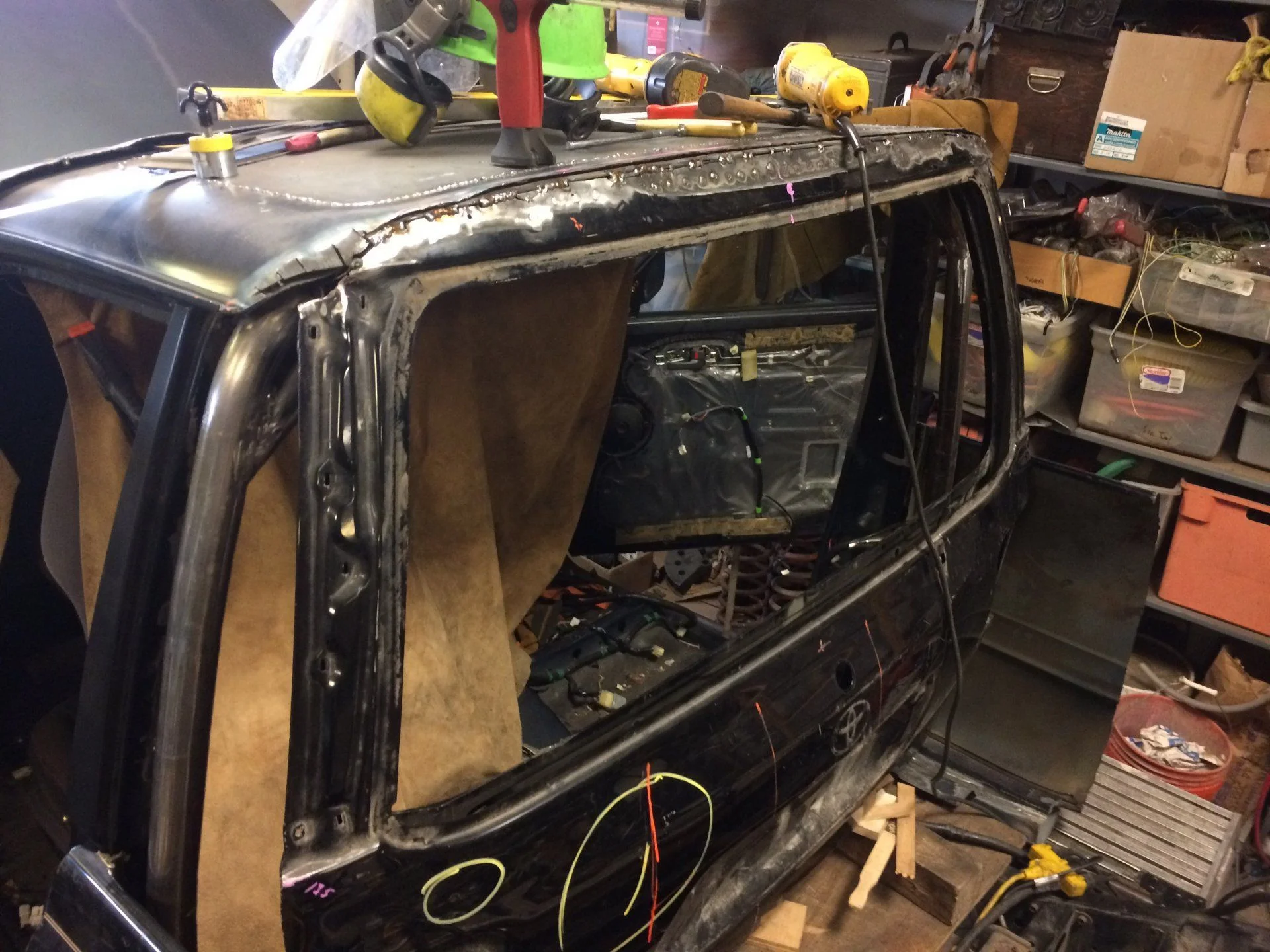

Started welding parts together on the ute.
