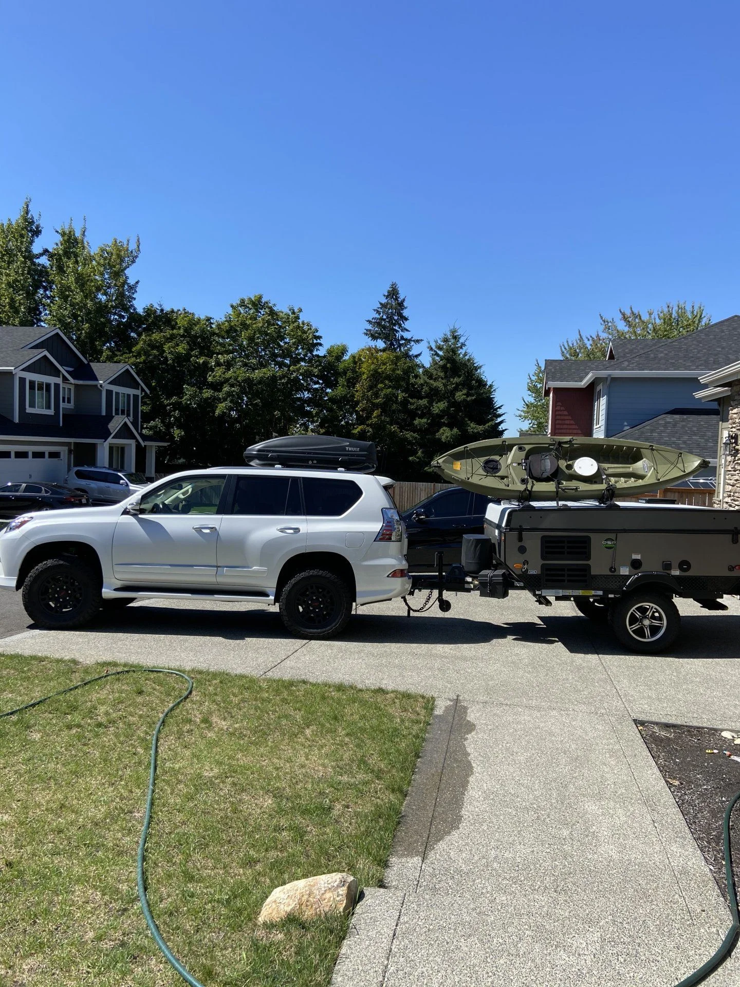

WOW! That is just AWESOME. I WANT some!!!
Nice trailer!
Can you fit the same size wheel/tire/bolt pattern as on your rig to the trailer?
That would very handy if you ever shred a tire.

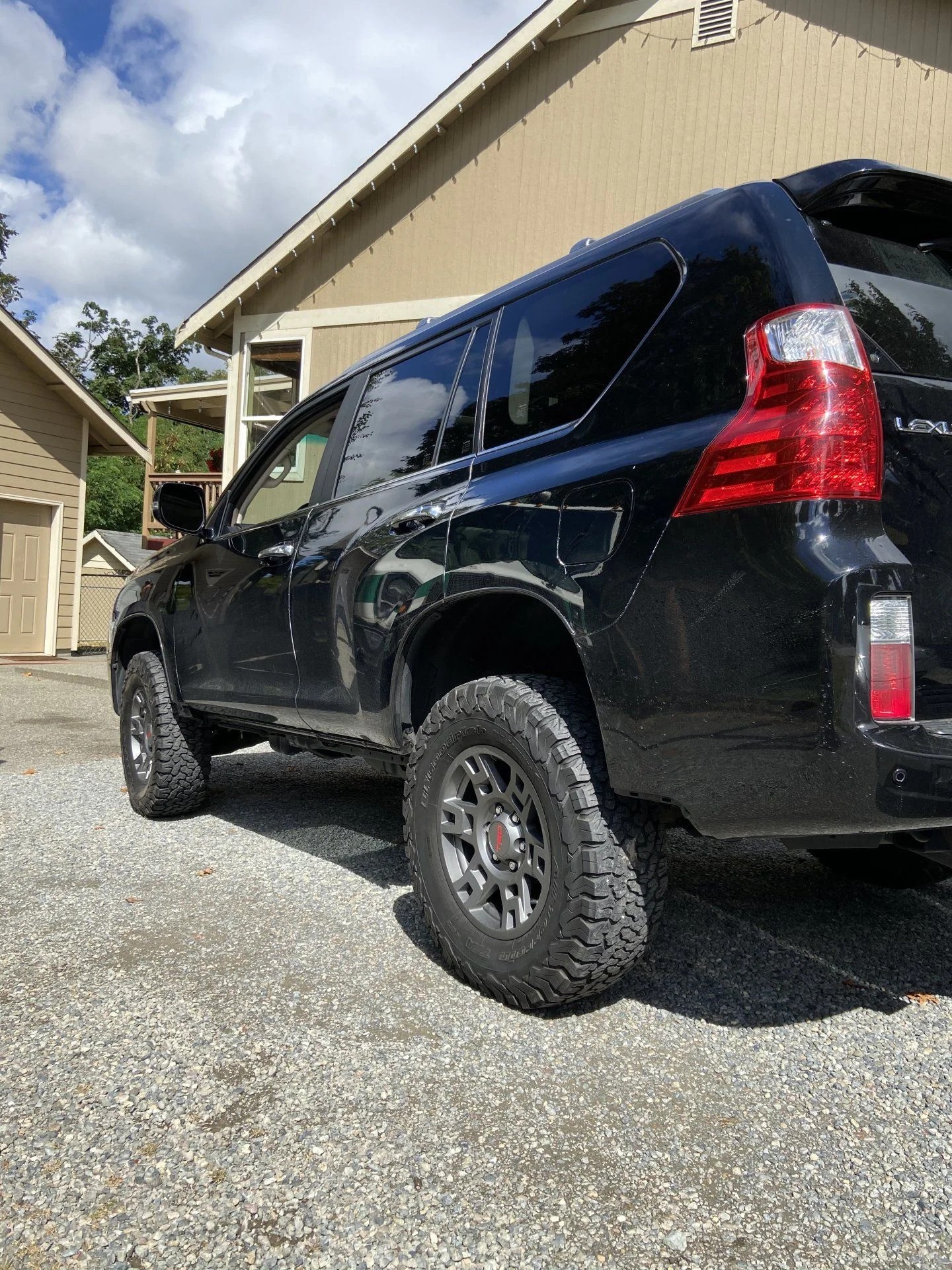

Is that the same one I saw somewhere that said it was a 2” lift with 275/70 tires? I’m about to put on a 2” lift and can’t decide if I should go wit 285s or go slightly smaller. Any rub issues with the 275s?
Not sure. I doubt he’s on here. Yes he and I are both running 275/70r17 with the same lift. He took his side steps off and no rubbing. I have a 2017 and had to remove the front wind break things and kept my side steps and a slight rub at full lock when I hit bumps.
Where are you rubbing at full lock?
