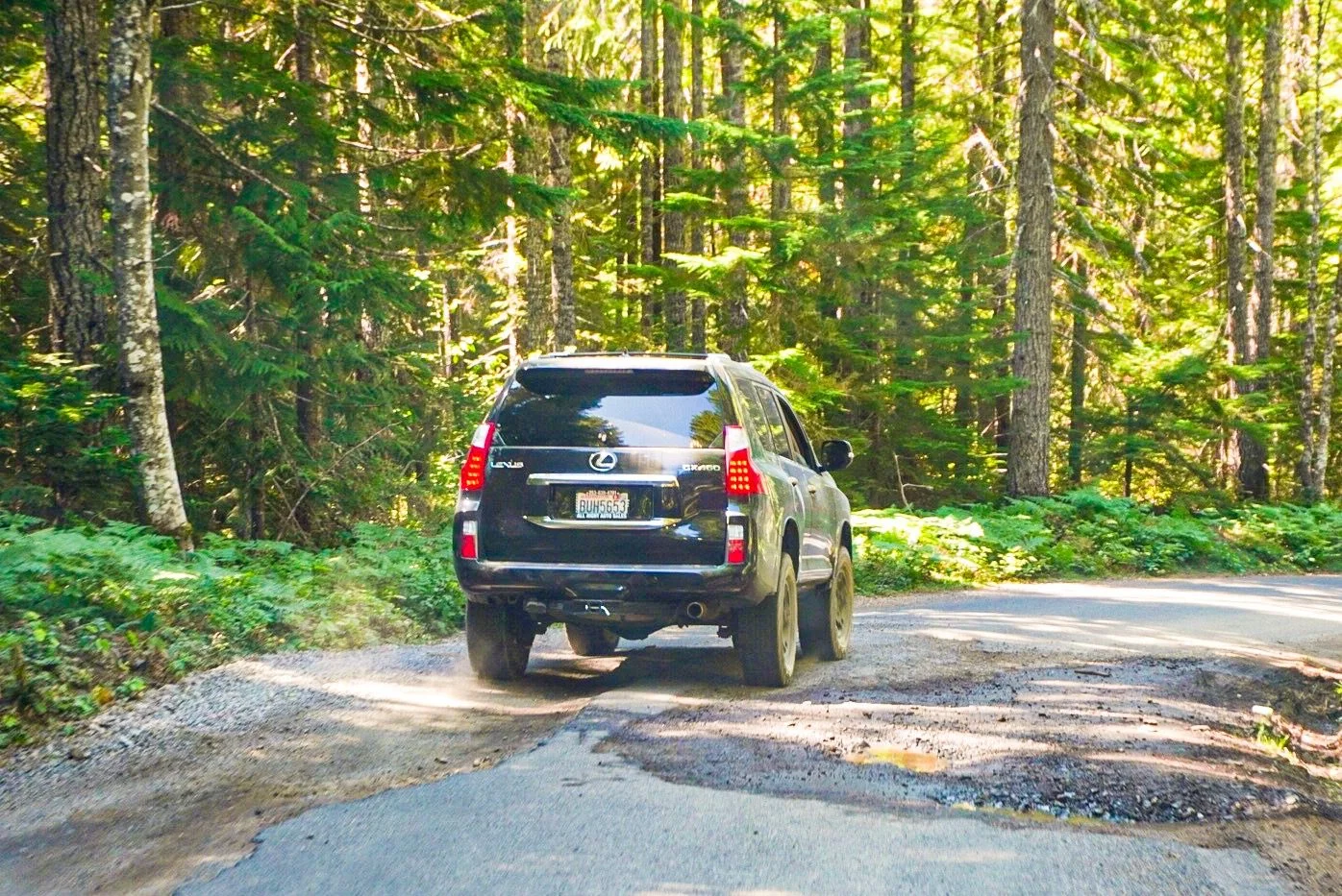

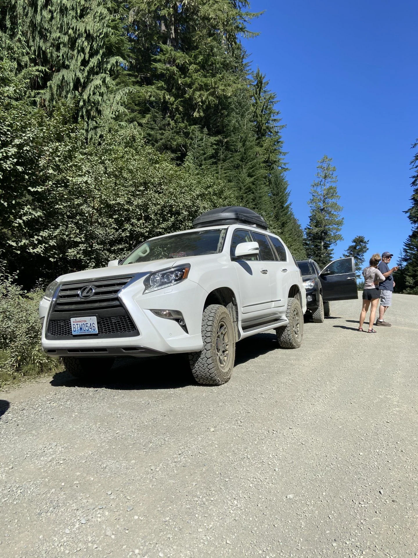

Also here are some GX pictures to make us happy haha
