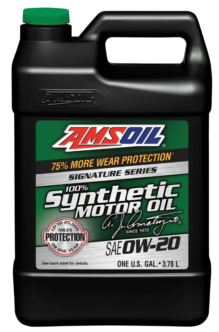

I’m thinking about running a 0w30 next time because I do tow a small trailer. Anyone running a little thicker oil for hotter months or for towing?
That plastic oil filter cap only needs to be on there at 18 ft-lbs
I just use Amsoil 0W-20 on mine. Lots of good oils out there but it has served me well for 20 years.

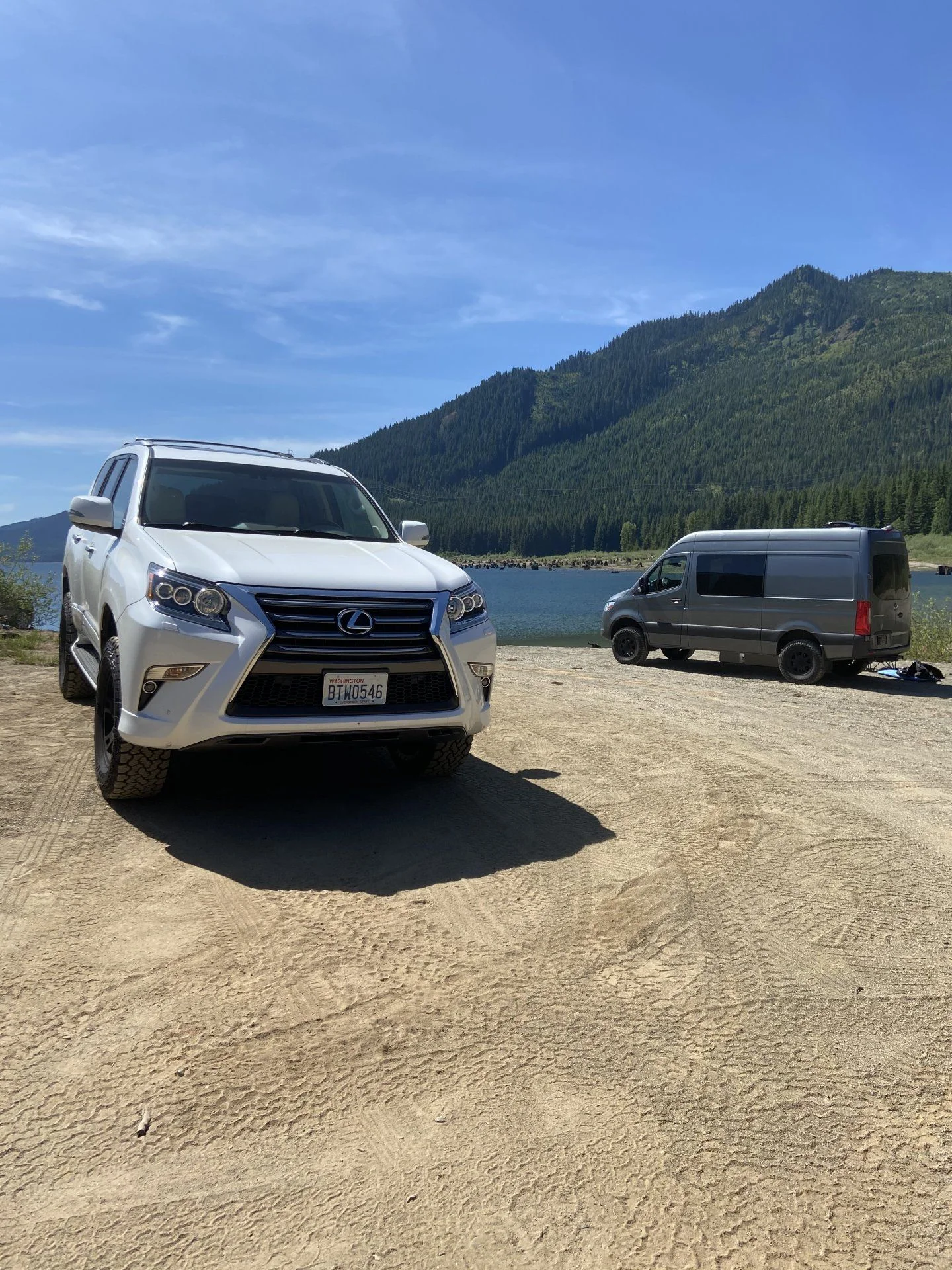

Easy oil filter access on mine
1996420
2003043
Nice... I haven't been out on that lake since last summer... took the boat up to the north end.
