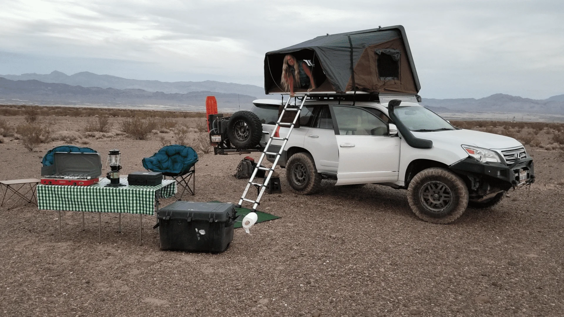

The girl in the tent was the MOST expensive mod!
And still is, but I wouldn't trade her for the world!!!!
35 years (married) and counting!!
