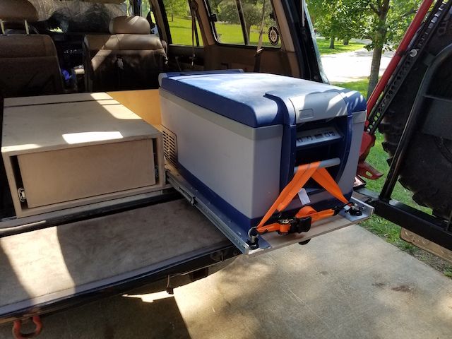

A little more progress on storage system.
Drawers installed with tie downs for fridge.
Plenty of room for tools in drawer.
Shot of the tie downs at the rear of fridge with slide locked open.
Shot of storage nook in front of drawer since I went cheap with 28" slides instead of 36".
Got really lucky with placement of drawer divider with regard to 3rd row bolt hole.

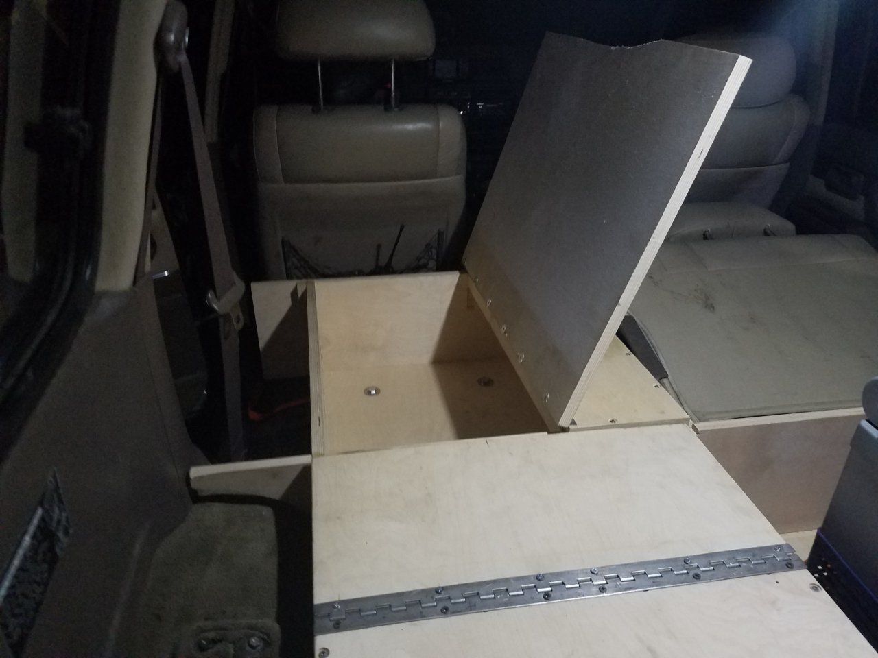

Storage module to replace second row drivers side seat.
Didn't take many pictures of 2nd row parts as I was distracted today by news of my Dad having heart attack. Fortunately he recognized symptoms and headed to hospital right away. 2 Stents, an overnight stay and he should be on his way home. :bounce::bounce2:
Couple more shots of 2nd row box installed
