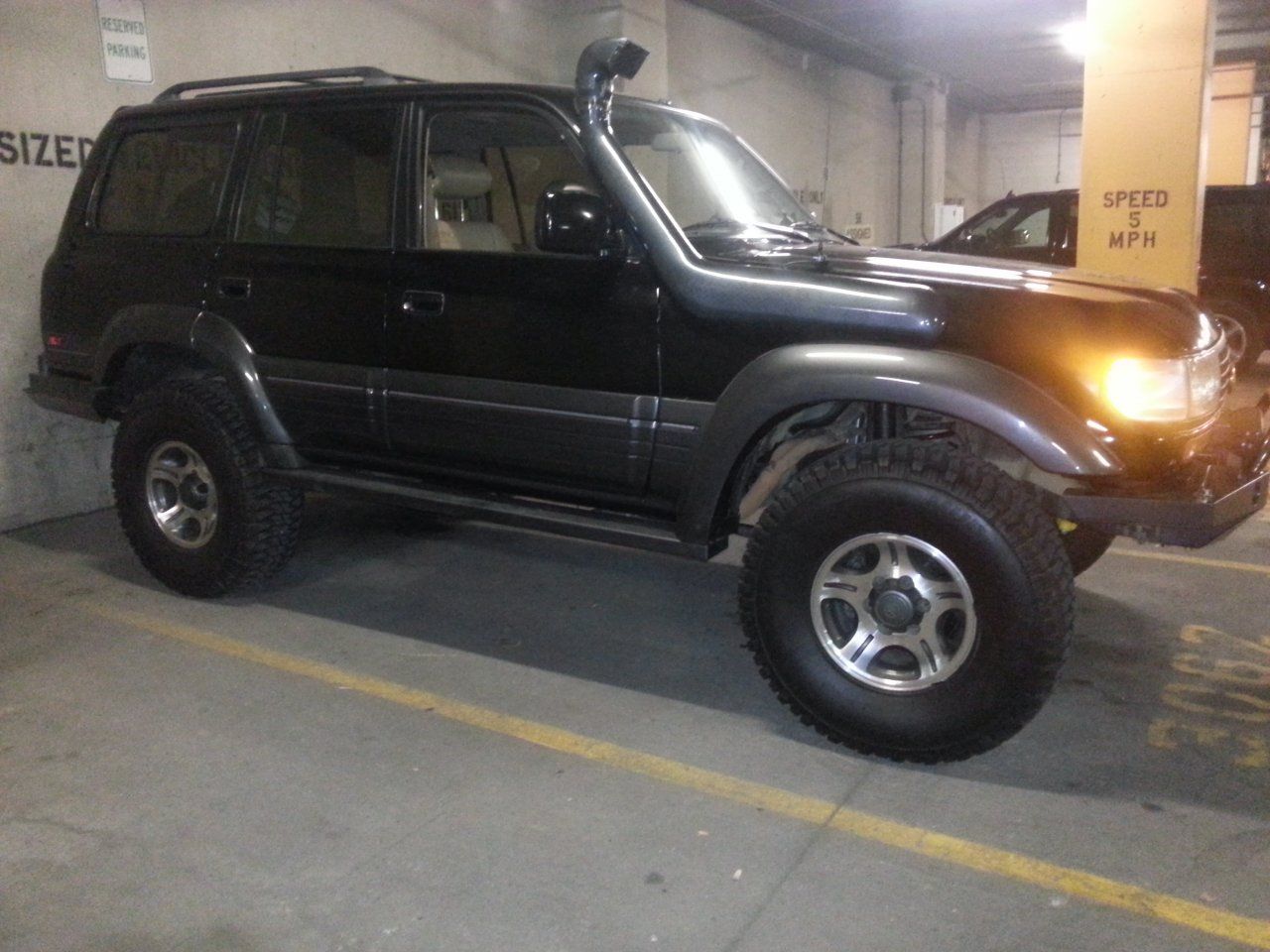

Installed new SS brake hoses all the way around & a 2.5" lift, Flushed the cooling system removed the green and replaced with red, did the PHH, replaced the fan clutch fluid.

Wow - Rob - When you get an 80 and . .it looks good btw! :)
