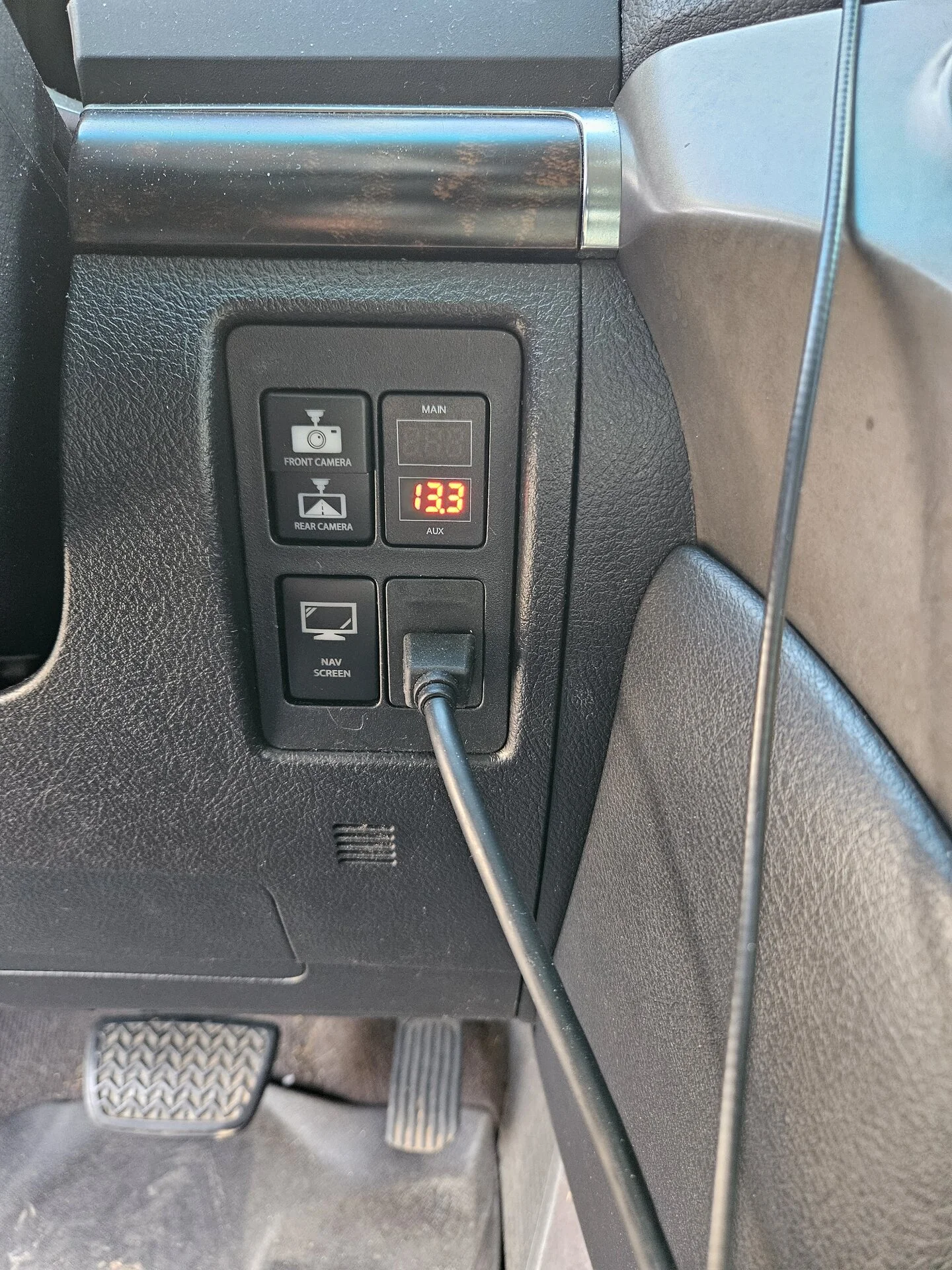

Air OnBoard is the gold standard for these. Most of them are single purpose but if you want dual function:
Quick note on the “momentary” version of the three position switch: it is, well, momentary. As soon as you stop pressing, the switch returns to the off position. Looks like AOB is adding more of three position switches than they had a couple months back, and may have what you need.
