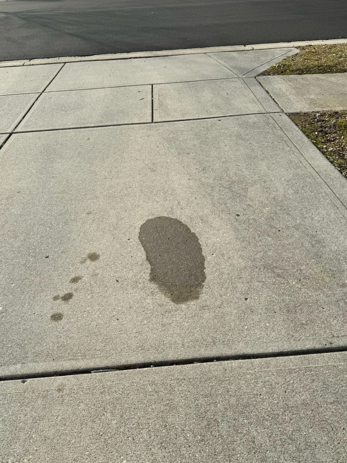

Yesterday, I made the 85 mile work drive with no issues, and yesterday evening my girlfriend sent me the picture of the stain on our inclinded. Surprisingly, when she took the picture, she stuck her finger on the stain to smell it, then went into the garage, and started smelling the coolant, and liquids out so she could tell me what it was...kudos to her.
This really started driving me crazy once I saw the picture she sent because the whole days I have been off, their has been no issues, and their has been no stains in the driveway b/c I look everytime I come and go. Of course the day I don't look, I get a suprise picture lol.

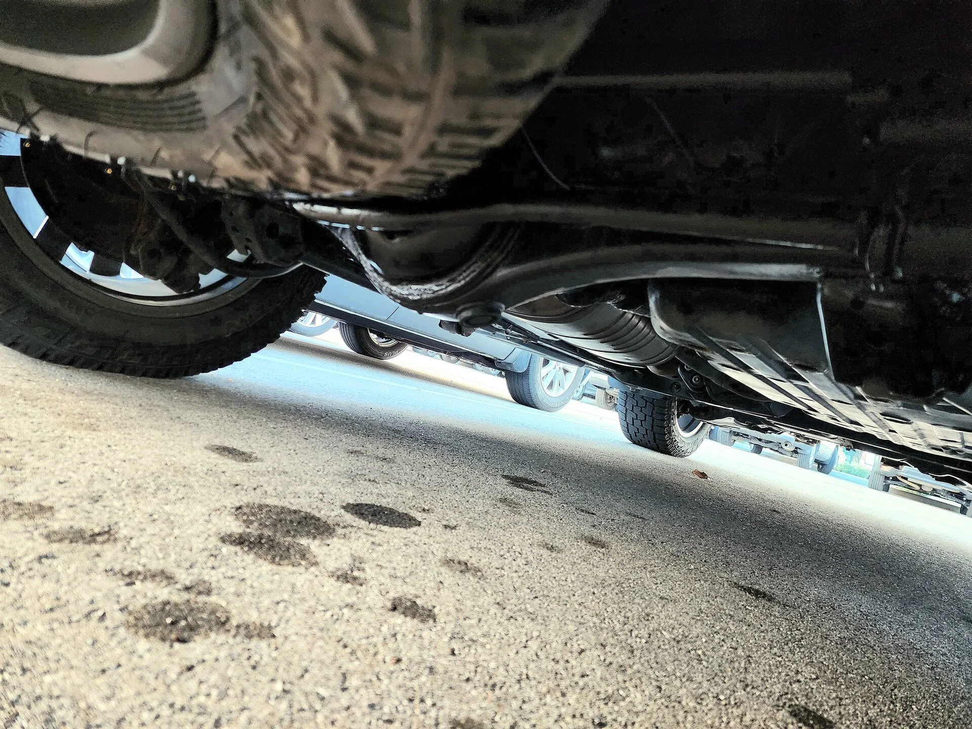

I spent my dinner break crawling around under my car and found the pumpkin on my rear axle wet, and it looks like the diff fluid might have got flung around during the drive, because there is diff fluid on the spare tire where it faces the diff, on the rear bumper, on the rear hatch, and some of the rear window.
After work last nite my buddy and I dropped the spare, and I got underneath and looked around and noticed the top of the rear pumpkin it a little more wet than the other areas. I also noticed while feeling around, the my breather tube on tue passenger side, is wet as well.

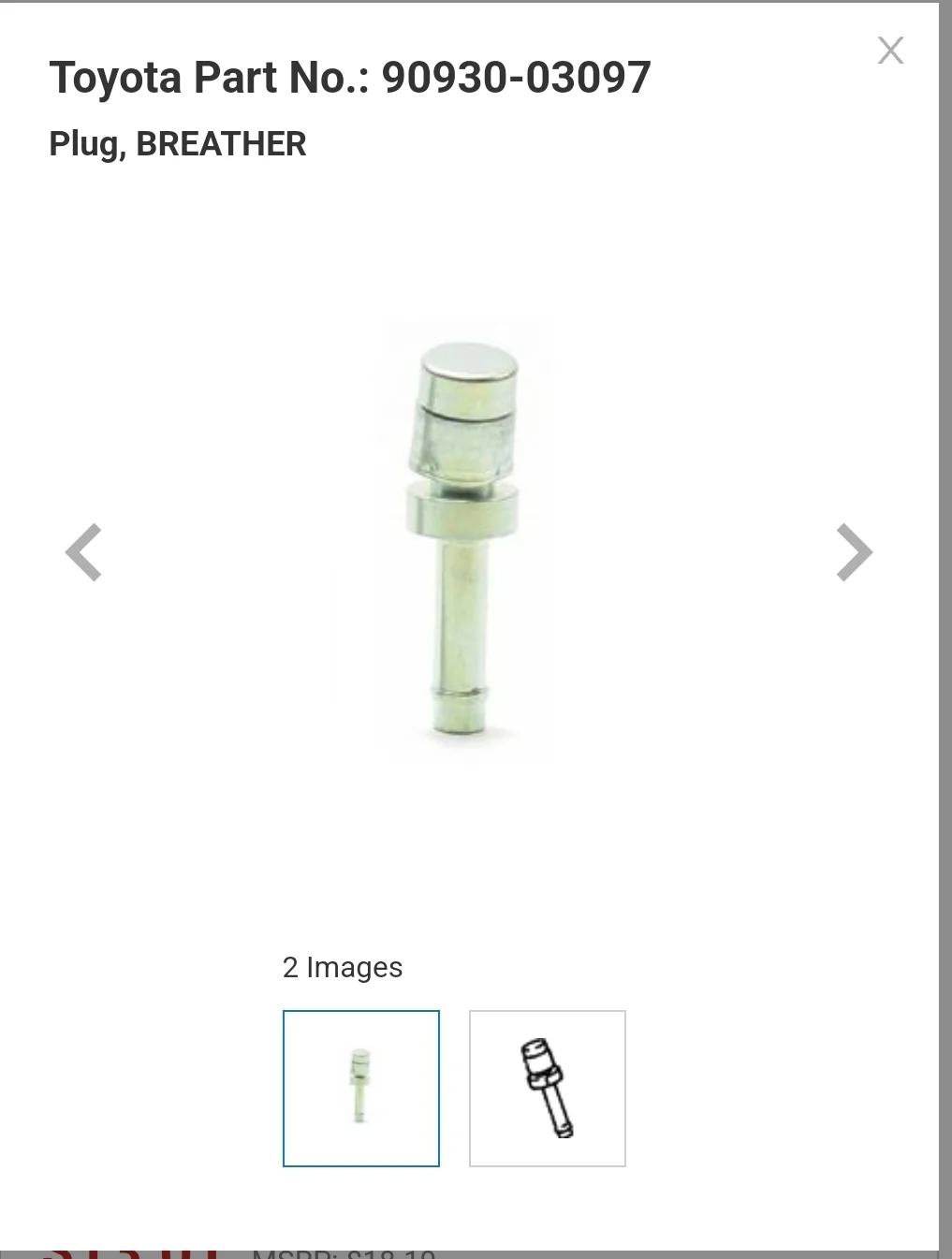

I found this picture when I typed in the part number you gave me. I noticed last nite when under there, that, that part in the picture is actually rusted. So when I go inspect things again at dinner I'm going to try and get a better look since it was pitched and I was under the car using the flashlight on my phone.

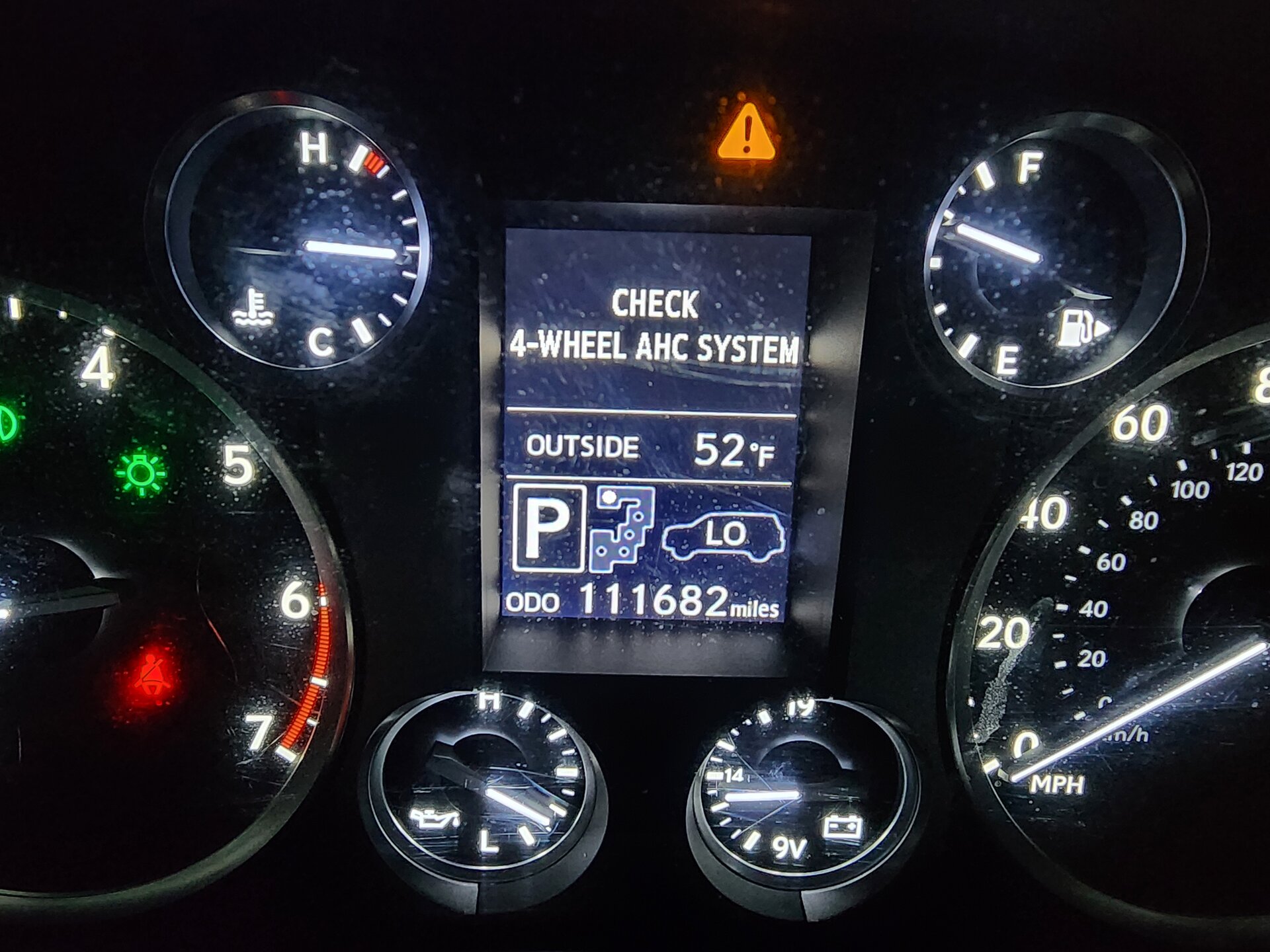

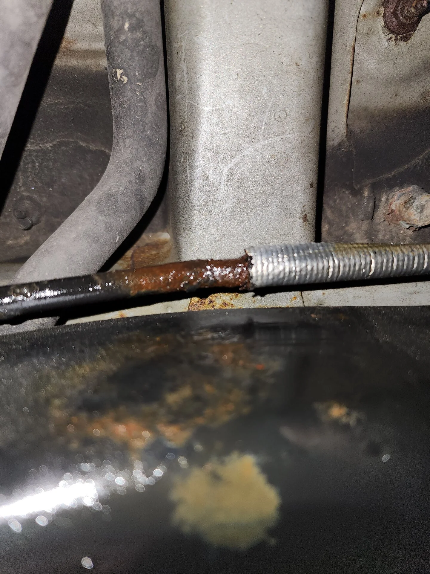

And I got confirmation on what the issue is right when I pull up to the 4 way stop right by my house...looks like I will be joining the LX570 AHC delete/ traditional suspension club.
Glad you found the issue, unfortunate it was the AHC line. Unless the rest of your system also shows that much corrosion just swapping the line may be easier than ditching AHC. I have over twice the miles and an extra 800# constant weight and it still performs great.
